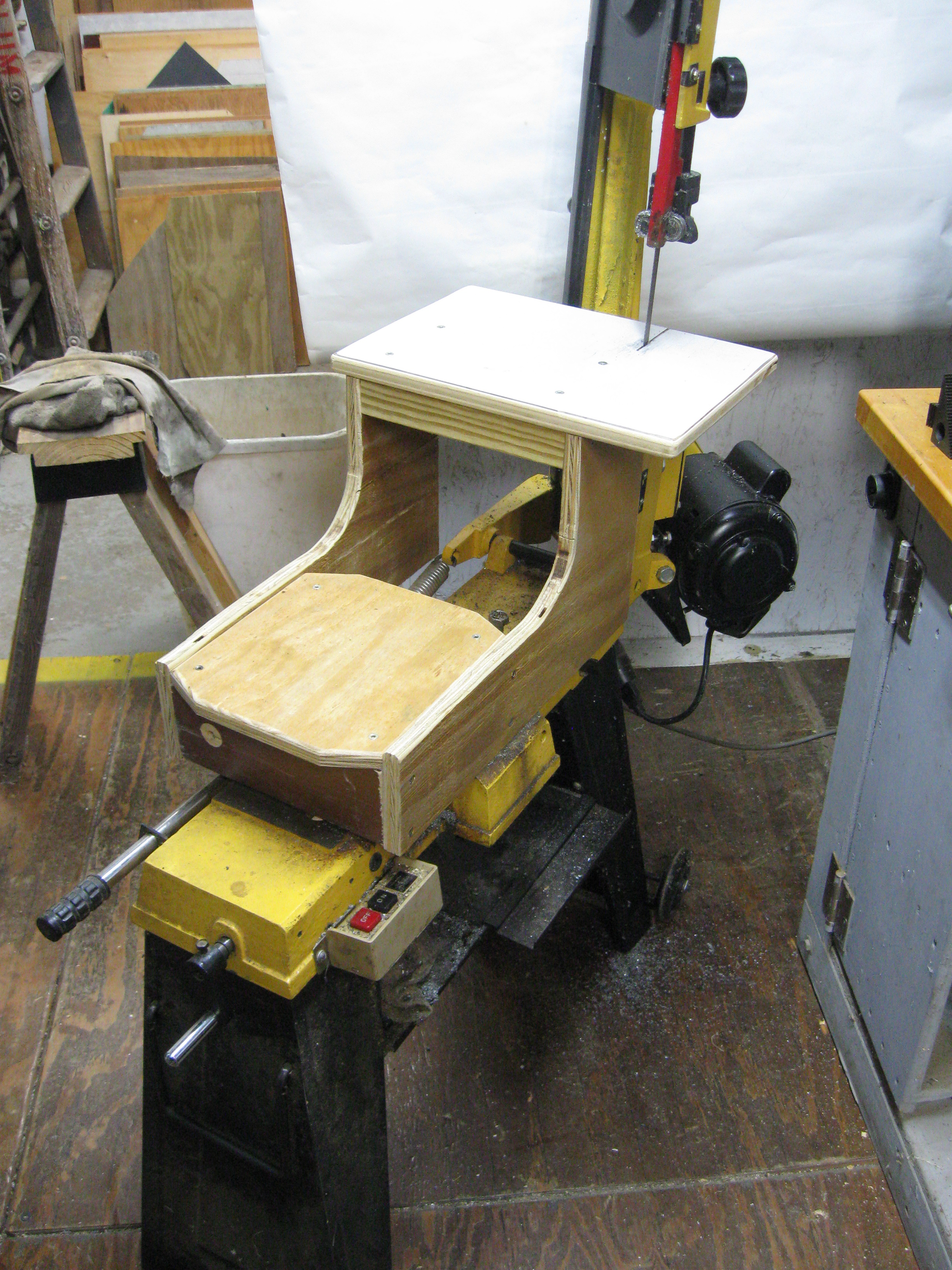

Attachment 49714Hi Gang: I built this seat/saw table for my 4x6 band saw. I like that it clamps in the vice and takes no tools to change. See more photos at:

Looks like that adds greatly to the precision of making small parts. Sorta lets the bandsaw become a vertical filing machine. Especially if you can get fine tooth blades.
As well on/off fast versus the sheet steel table.
