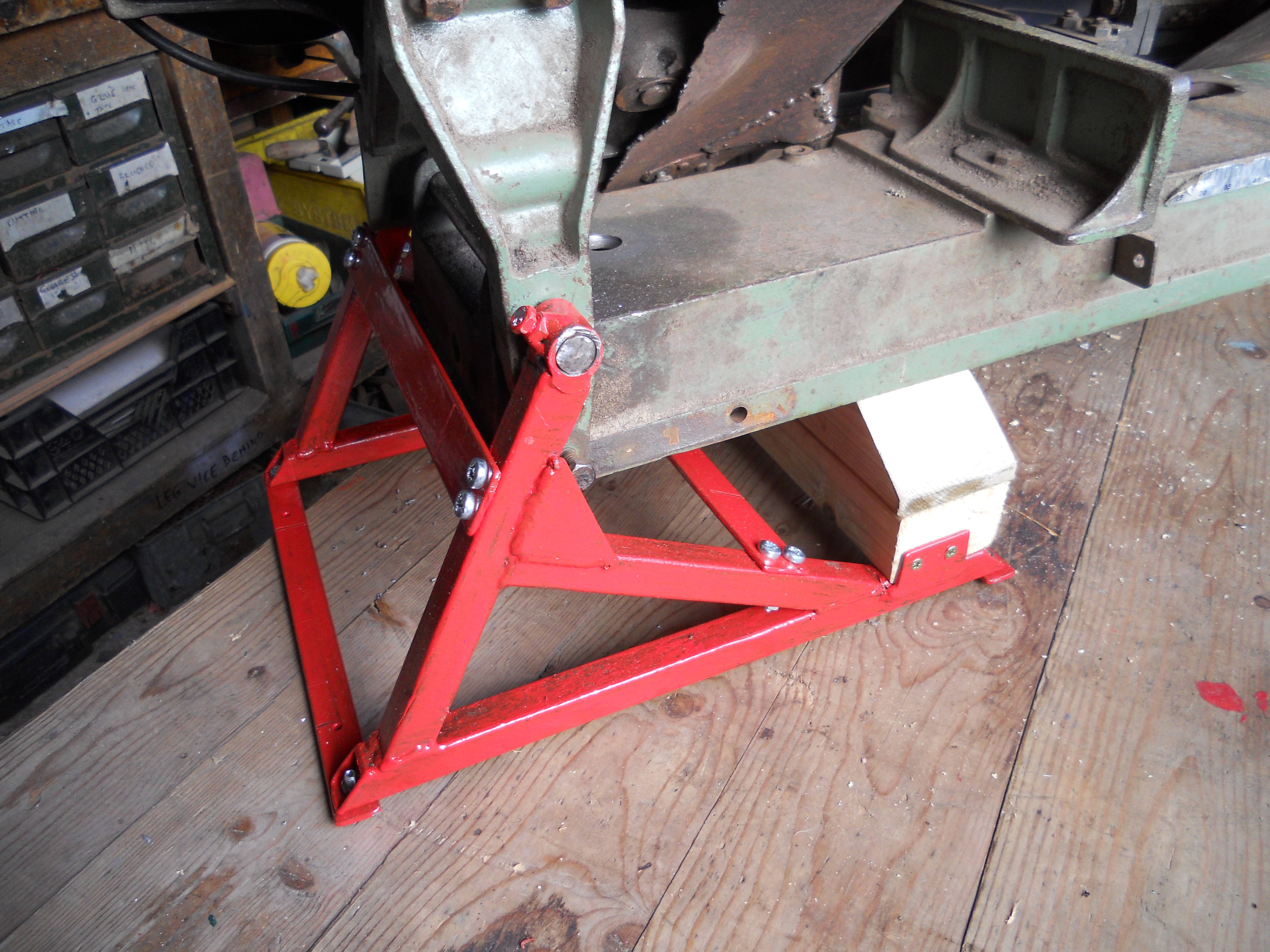

Unfortunately I now only have an 8ft x 16ft garage so space is at a premium. My bandsaw was eating up a lot of floorspace so I decided to modify it to fit on top a tool storage filing cabinet. I tried various things and found that the best way was to extend the pivot pin to fit a fabricated frame that allowed the top frame and vice bed to pivot about a common axis.
I did it this way because I use it a lot in the vertical position for cutting profiles. Hopefully the pictures will show what I mean.
Base frame ( Design No 4 The first 3 didn't work )
Attachment 27108

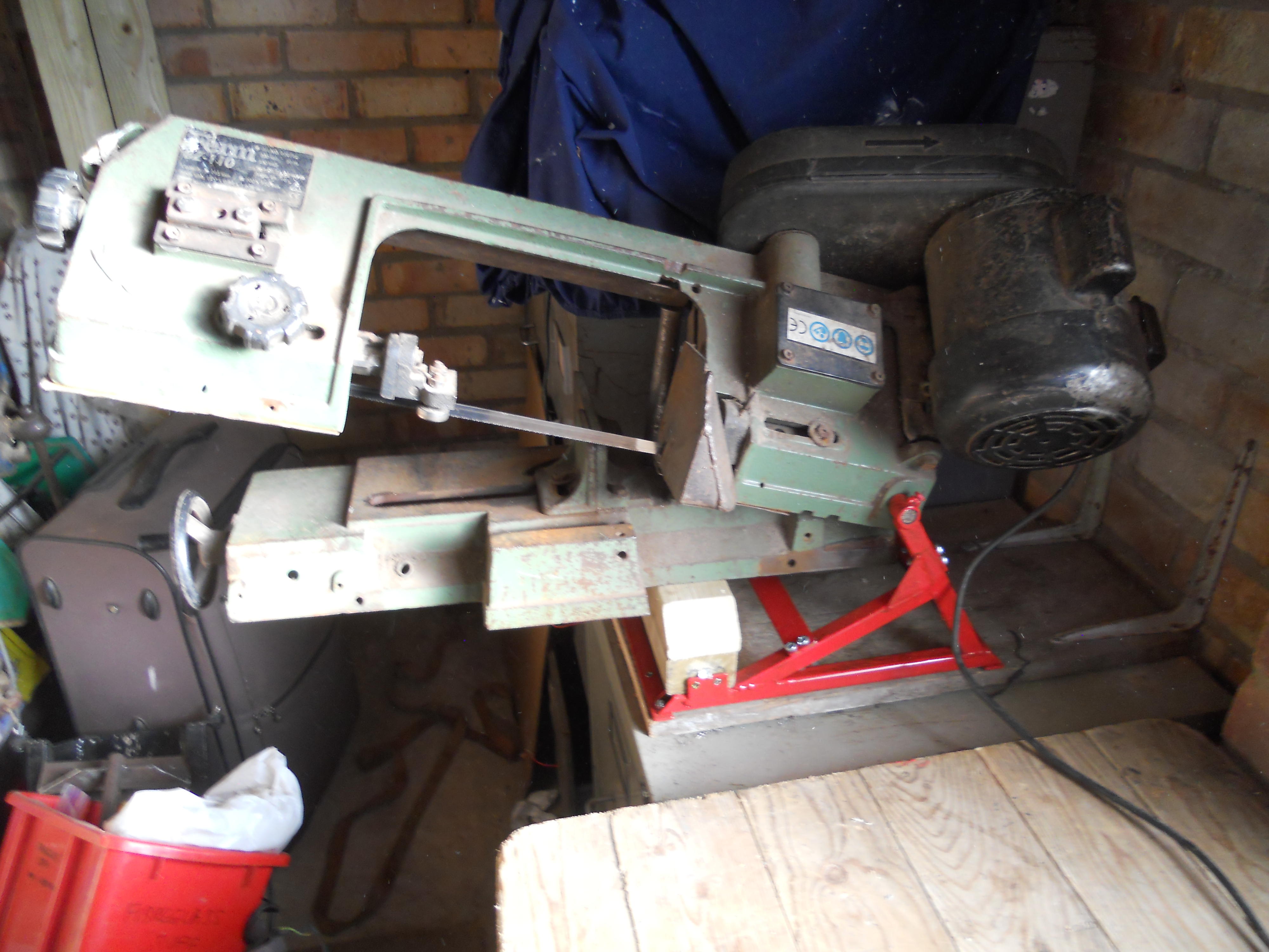

Horizontal mode
Attachment 27109

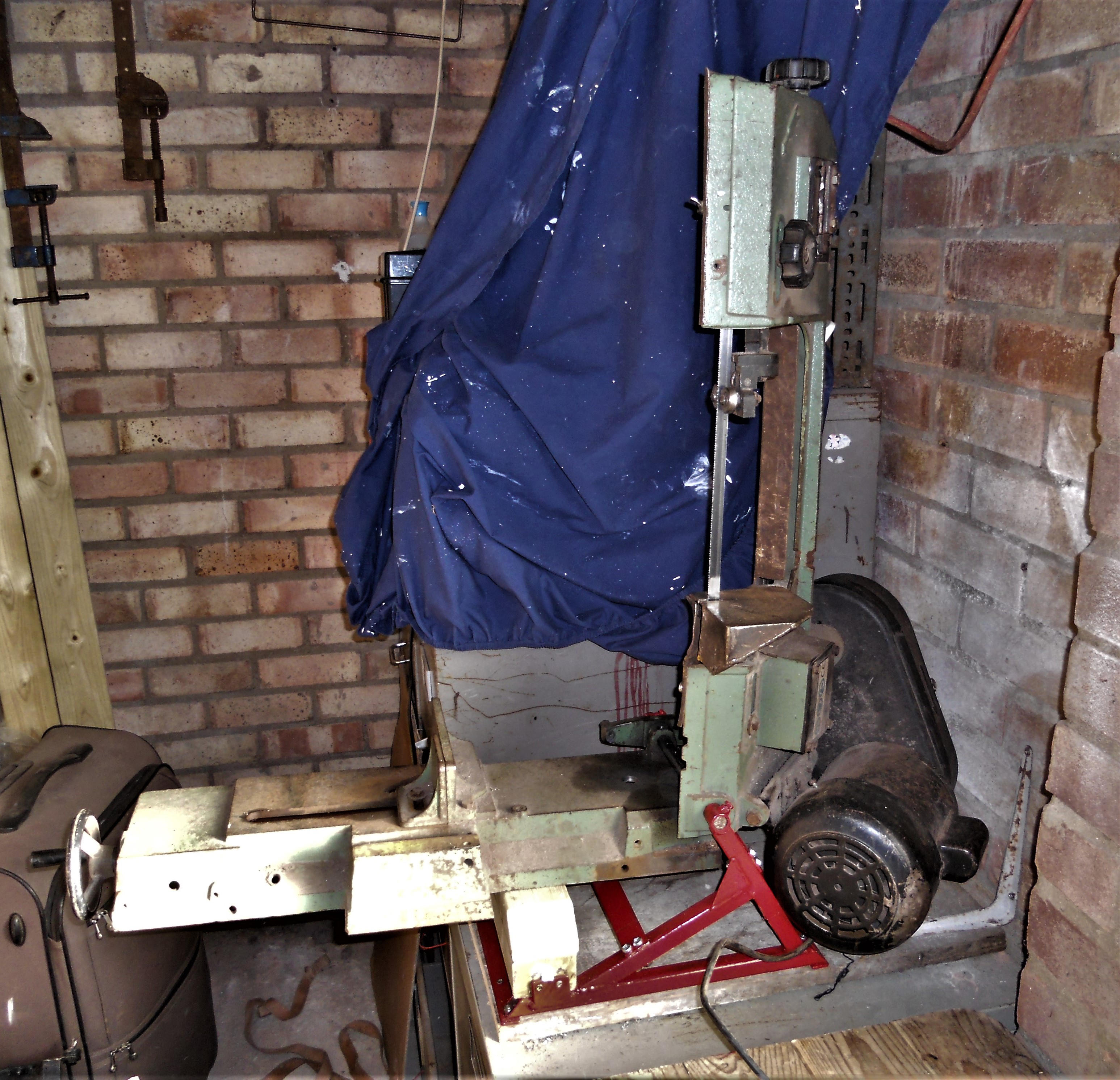

Vertical mode
Attachment 27110

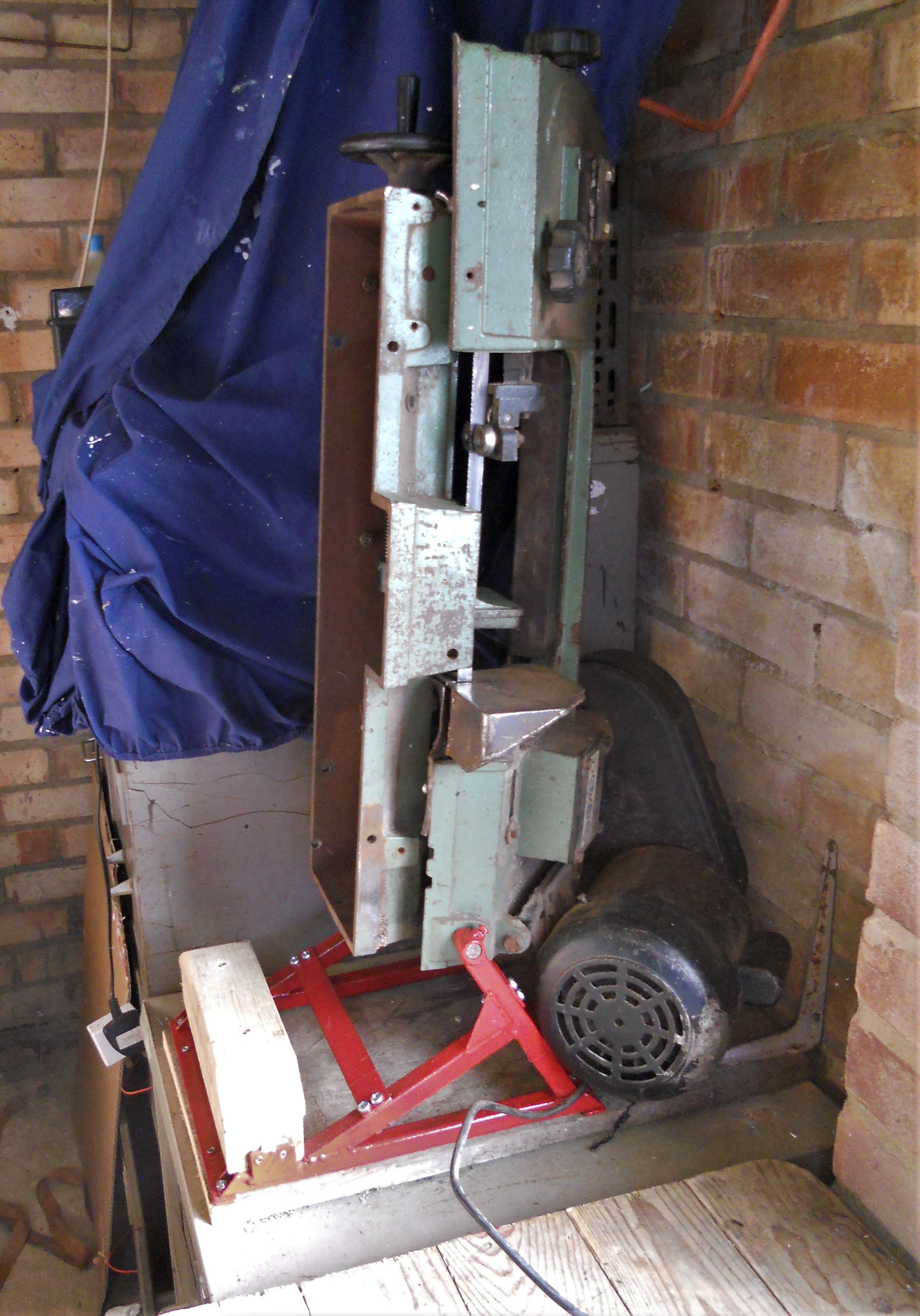

Folded away
Attachment 27111
