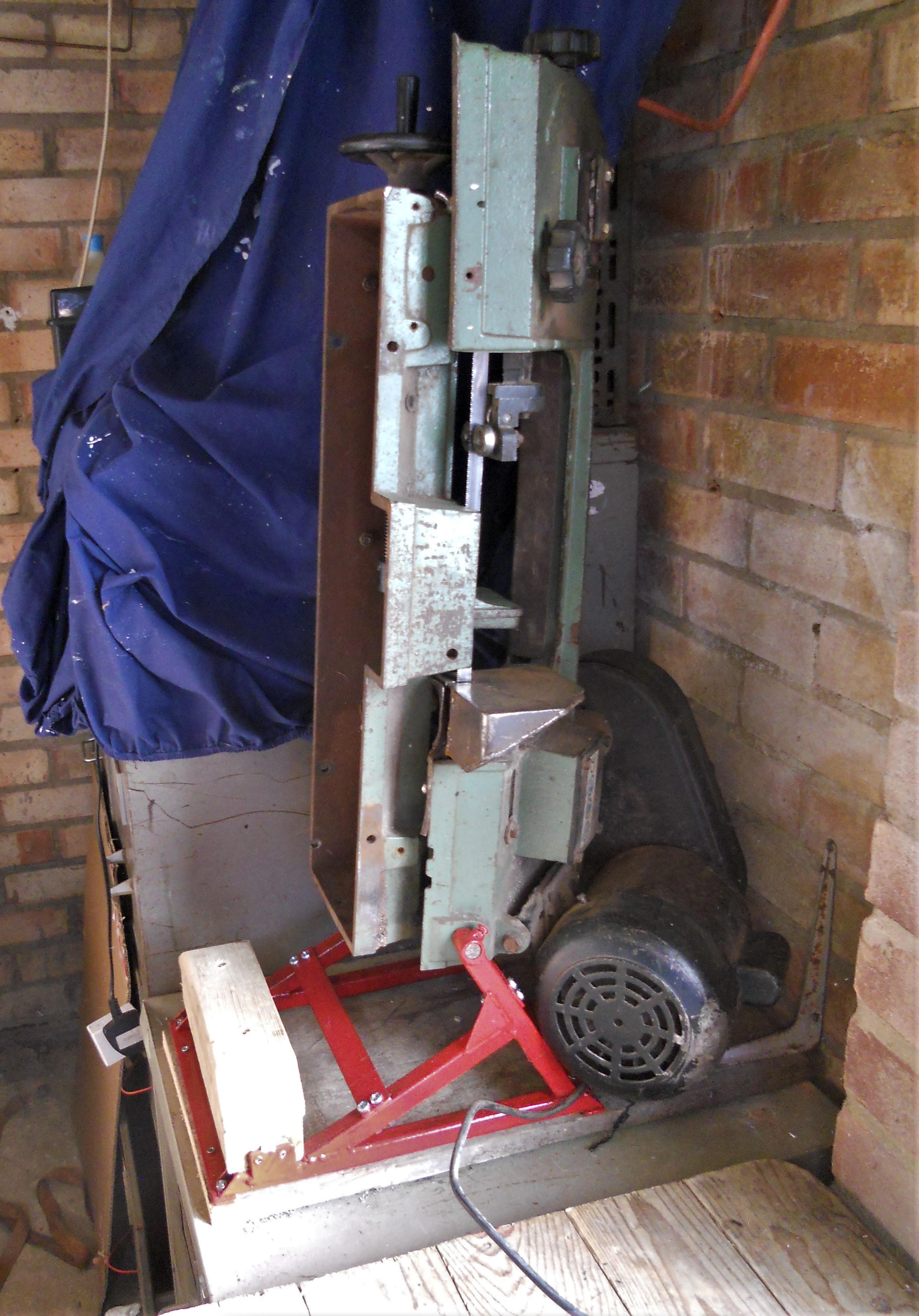

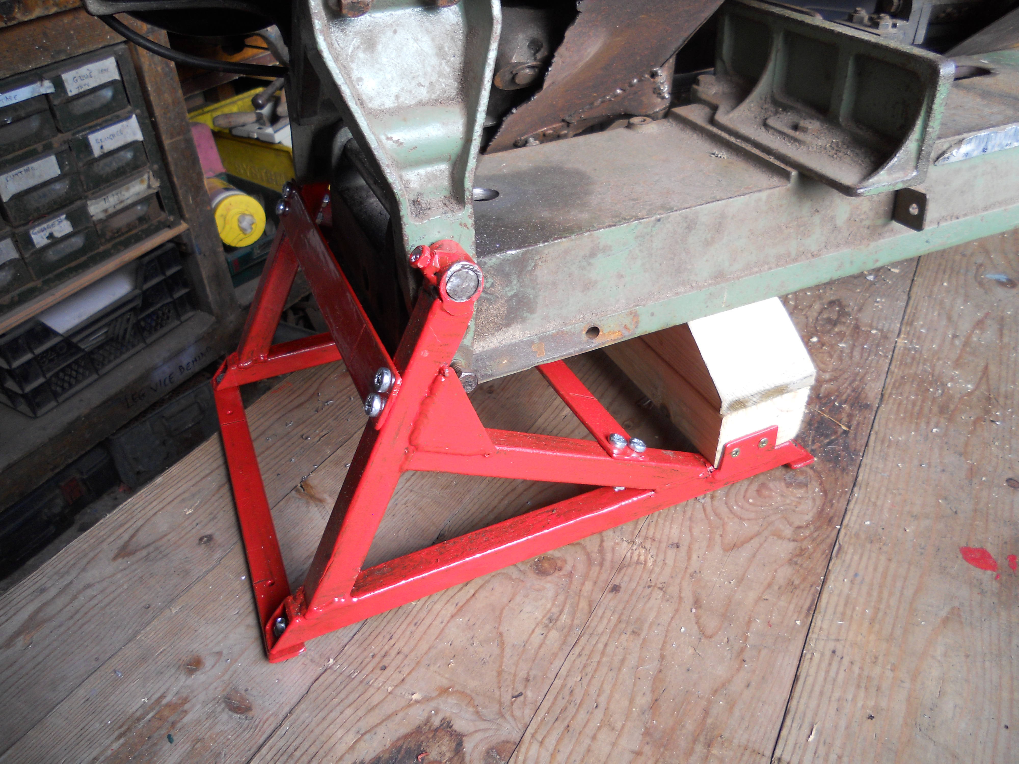

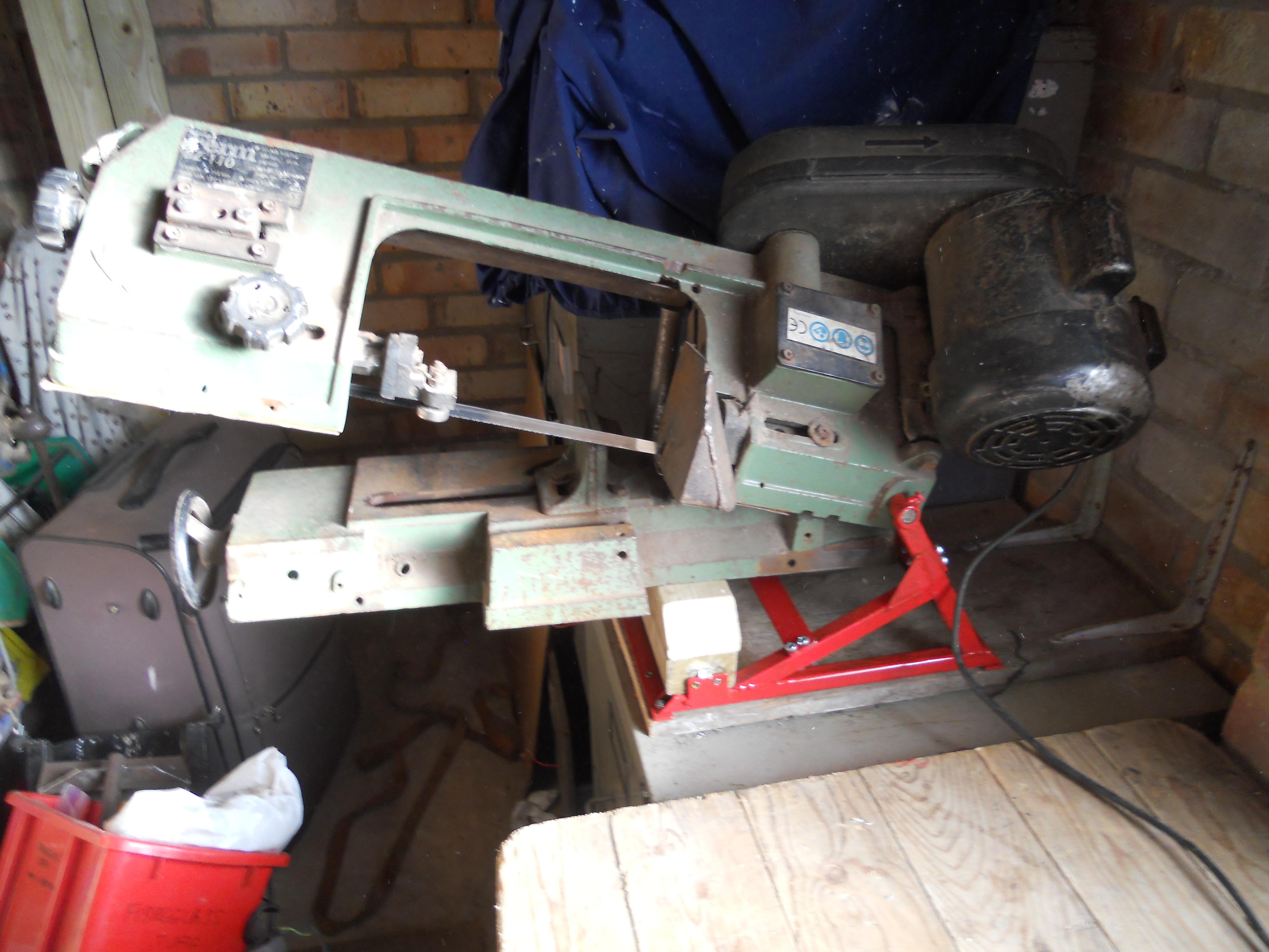

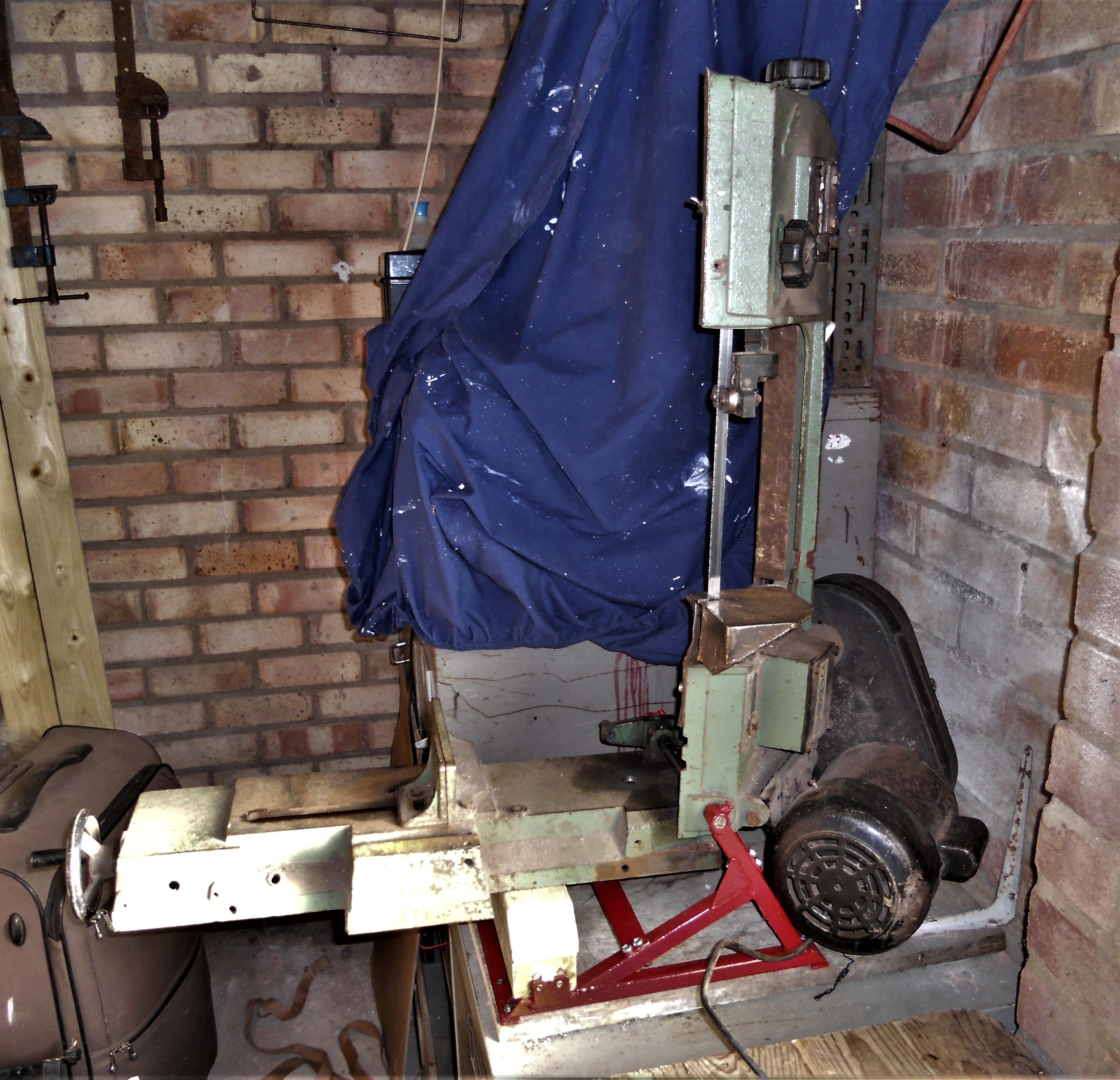

    Unfortunately I now only have an 8ft x 16ft garage so space is at a premium. My bandsaw was eating up a lot of floorspace so I decided to modify it to fit on top a tool storage filing cabinet. I tried various things and found that the best way was to extend the pivot pin to fit a fabricated frame that allowed the top frame and vice bed to pivot about a common axis.
    I did it this way because I use it a lot in the vertical position for cutting profiles. Hopefully the pictures will show what I mean.
    Base frame ( Design No 4 The first 3 didn't work )
    Horizontal mode
    Vertical mode
    Folded away

    As I said, I use it most as a vertical bandsaw ( I even had a small saddle fitted in the vice and I straddled the bed ) But I have placed it far enough forward so a bar will still fit in the vice.
    I first tried to fit under a bench and folding out but various things on the way prevented it being usable in both modes. That's the trouble with designing and building "on the fly". I've kept some of the failures that might work for something else.

    Brilliant! Mine didn't come with a base, so I have it precariously hanging off a 2' workbench. It's a real hassle to use it vertically, because then I have to pull it out even further to get the clearance for the motor. That stand is great because it puts all the weight on the backend, where I need it to be.

    It did take me a few tries to get it right. The common pivot seems to be the main thing. Though now I think I should have fitted bearings to the frame, thus avoiding wear on the castings.

    I wouldn't worry too much about the castings.
    It's good self lubricating cast Iron.
    It's built and reinforced to pivot on those points.
    The only part that might use some reinforcing is the ears on the base.
    If you're worried, you might braze or tap and screw some extra material around them?
    Looks fine though.
