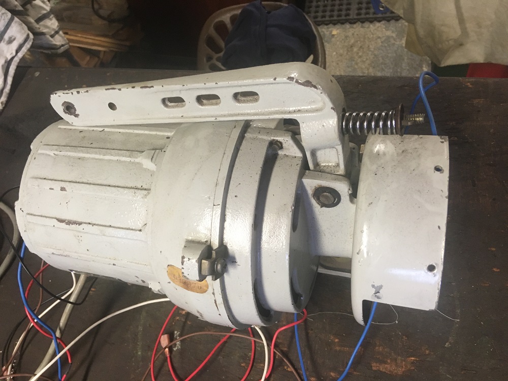

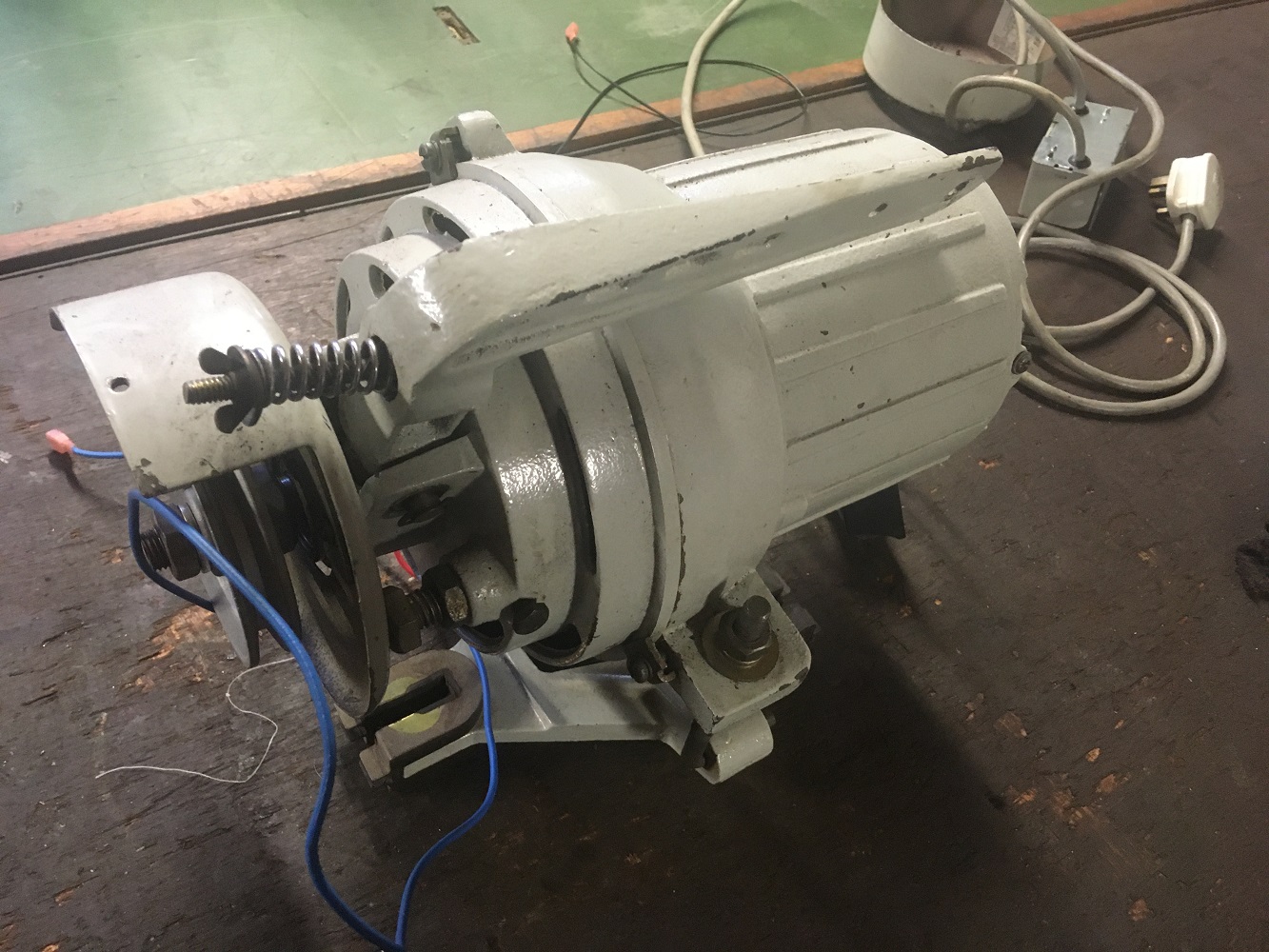

I have decided to use a clutched 1/2 HP industrial sewing machine motor which is ideal as it is single phase.
Attachment 31659 Attachment 31660

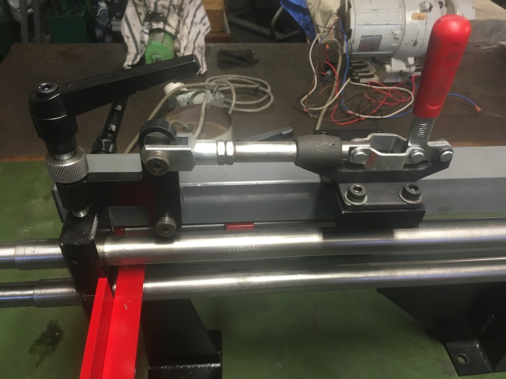

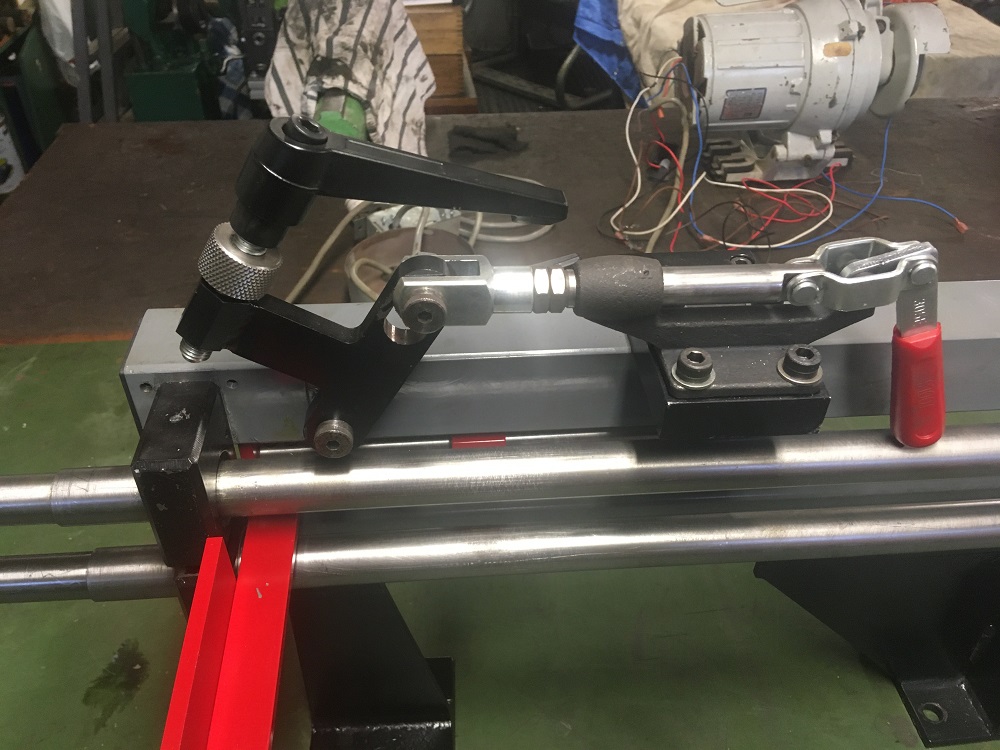

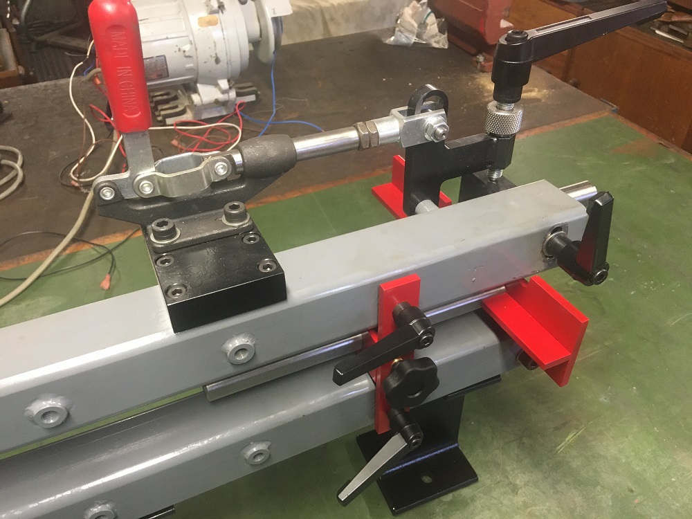

I have added a lot of features such as a toggle clamp to maintain the die pressure so repeat ability can be maintained if making several parts with the same die and gauge material
Attachment 31662
Toggle clamp open (tension springs to be to fitted to lift shaft bearing housing to give clearance for material to be positioned the toggle clamp will then extend the tension springs and lock the dies to desired depth)
Attachment 31663
Toggle clamp closed. Pressure can be increased or decreased via the locking clamp.

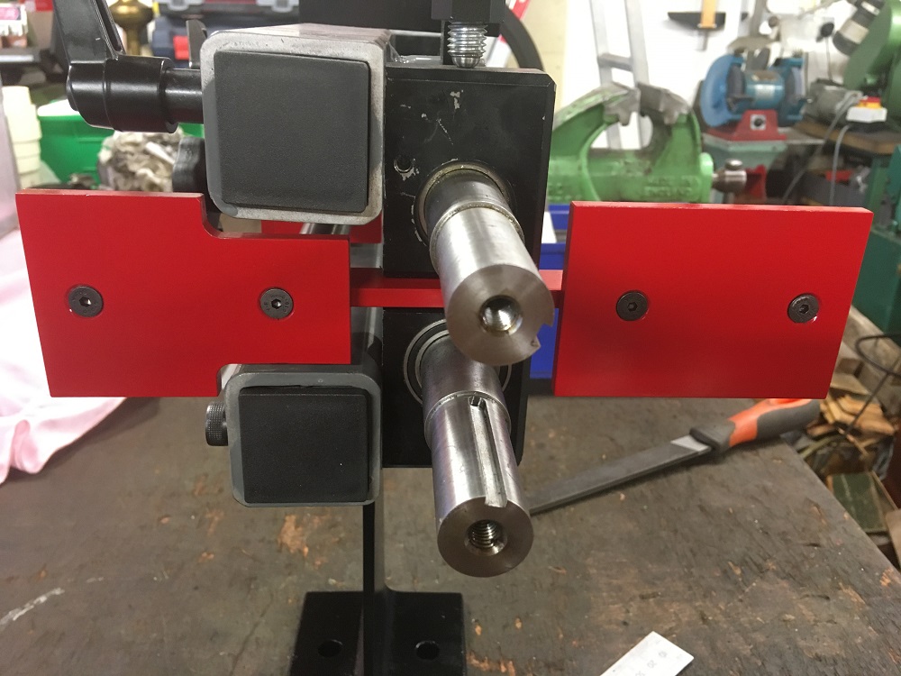

I have also locked the two arms to prevent springing and incorporated the fence/stop to be mounted to this brace.

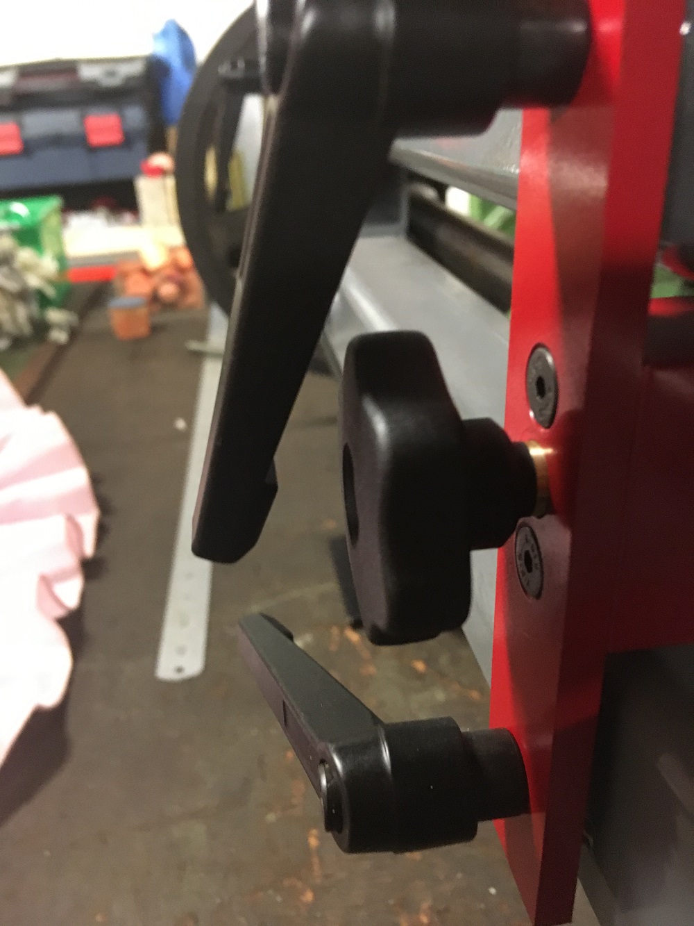

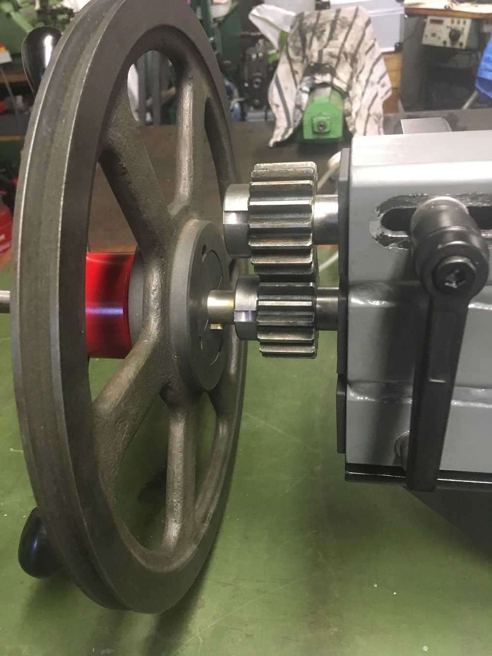

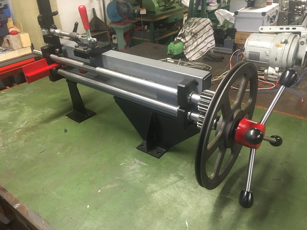

The gear drive was calculated to give the desired distance between the shafts centres and ordered from eBay. There is also a locking clamp that can be seen in the photo which allows the shaft to move to align the dies, but still allows the gears to mesh to maintain the drive of both shafts.
Attachment 31666

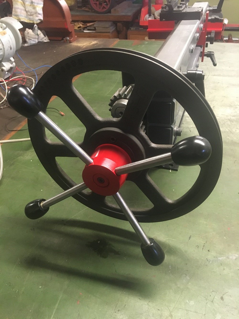

There is a manual hand wheel which can either be removed completely or just unscrew the handles when the motor drive is in use.

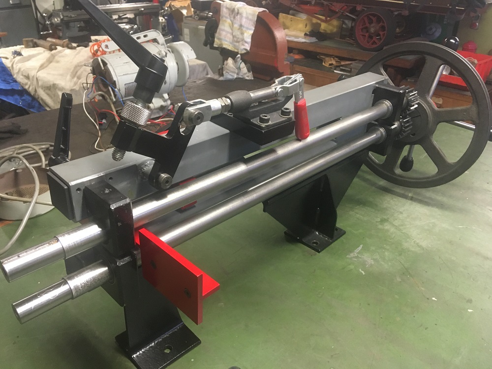

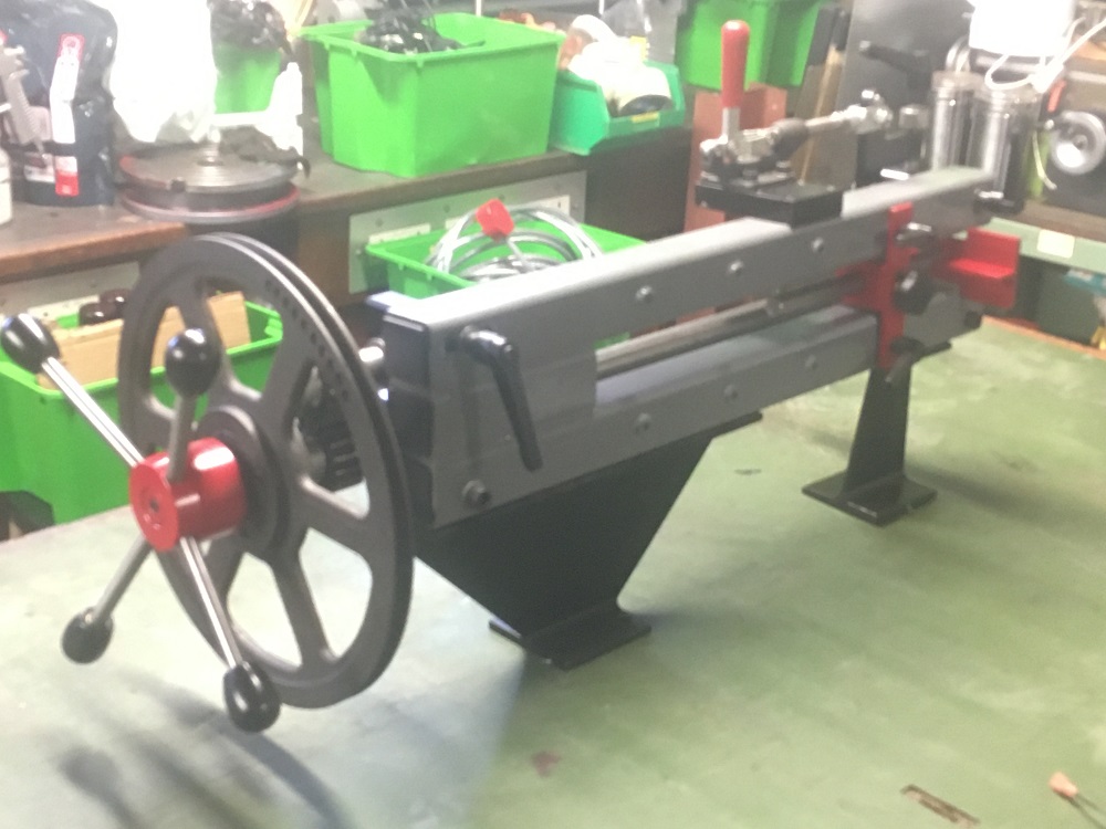

Other views of bead roller.
