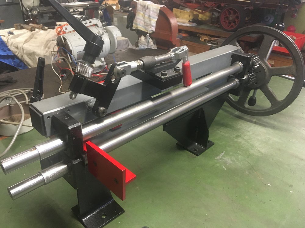

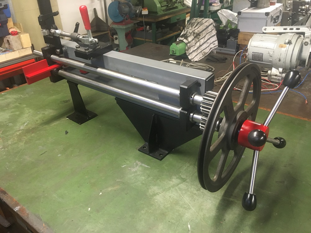

    Hi All
    I have completed the main part of the bead roller made from 50 mm box section and 25 mm diameter shafts. There are still bits I have to make such as the dies and sort the motor drive out.

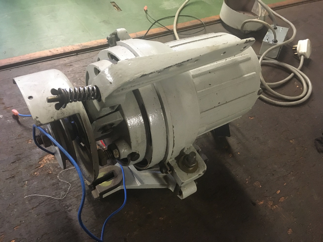

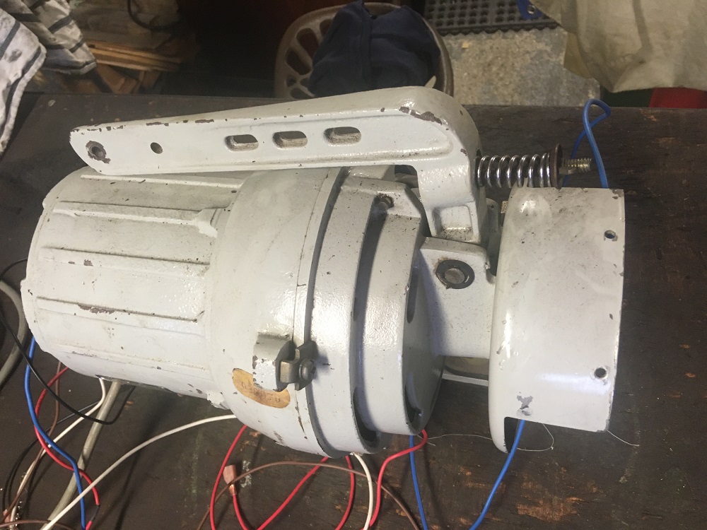

    I have decided to use a clutched 1/2 HP industrial sewing machine motor which is ideal as it is single phase.
Name:	clutch motor 2.jpg
ID:	31659 Click image for larger version.
Name:	clutched motor.jpg

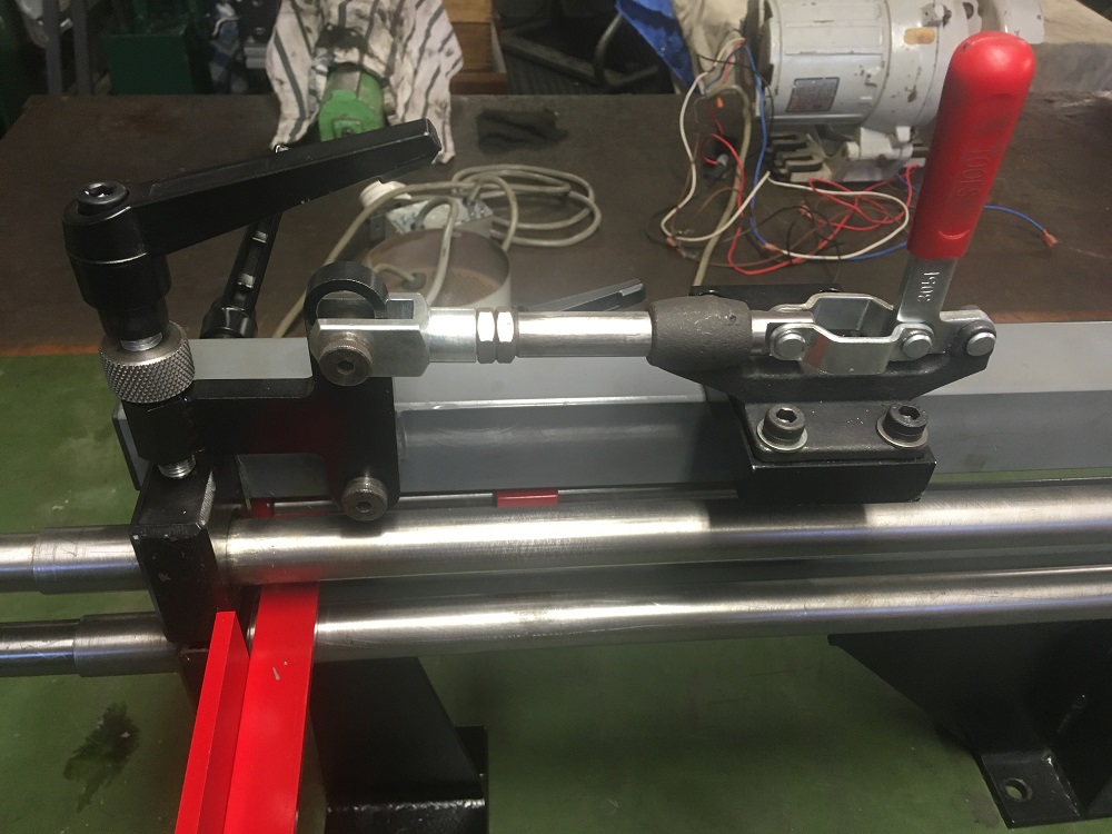

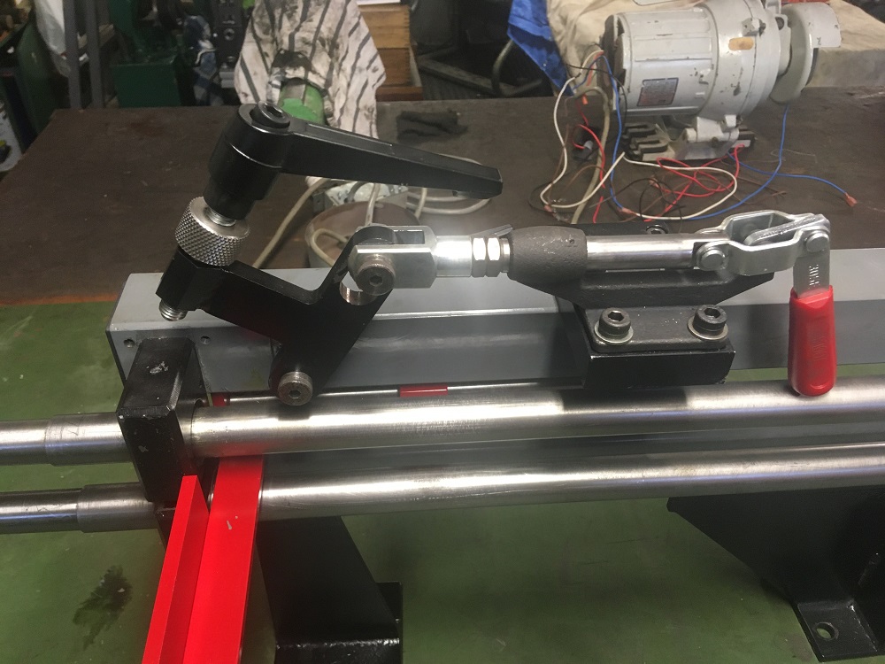

    I have added a lot of features such as a toggle clamp to maintain the die pressure so repeat ability can be maintained if making several parts with the same die and gauge material
Name:	Die clamping open.jpg
    Toggle clamp open (tension springs to be to fitted to lift shaft bearing housing to give clearance for material to be positioned the toggle clamp will then extend the tension springs and lock the dies to desired depth)
Name:	Die clamping closed.jpg
    Toggle clamp closed. Pressure can be increased or decreased via the locking clamp.

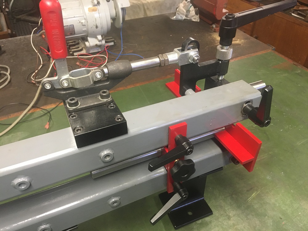

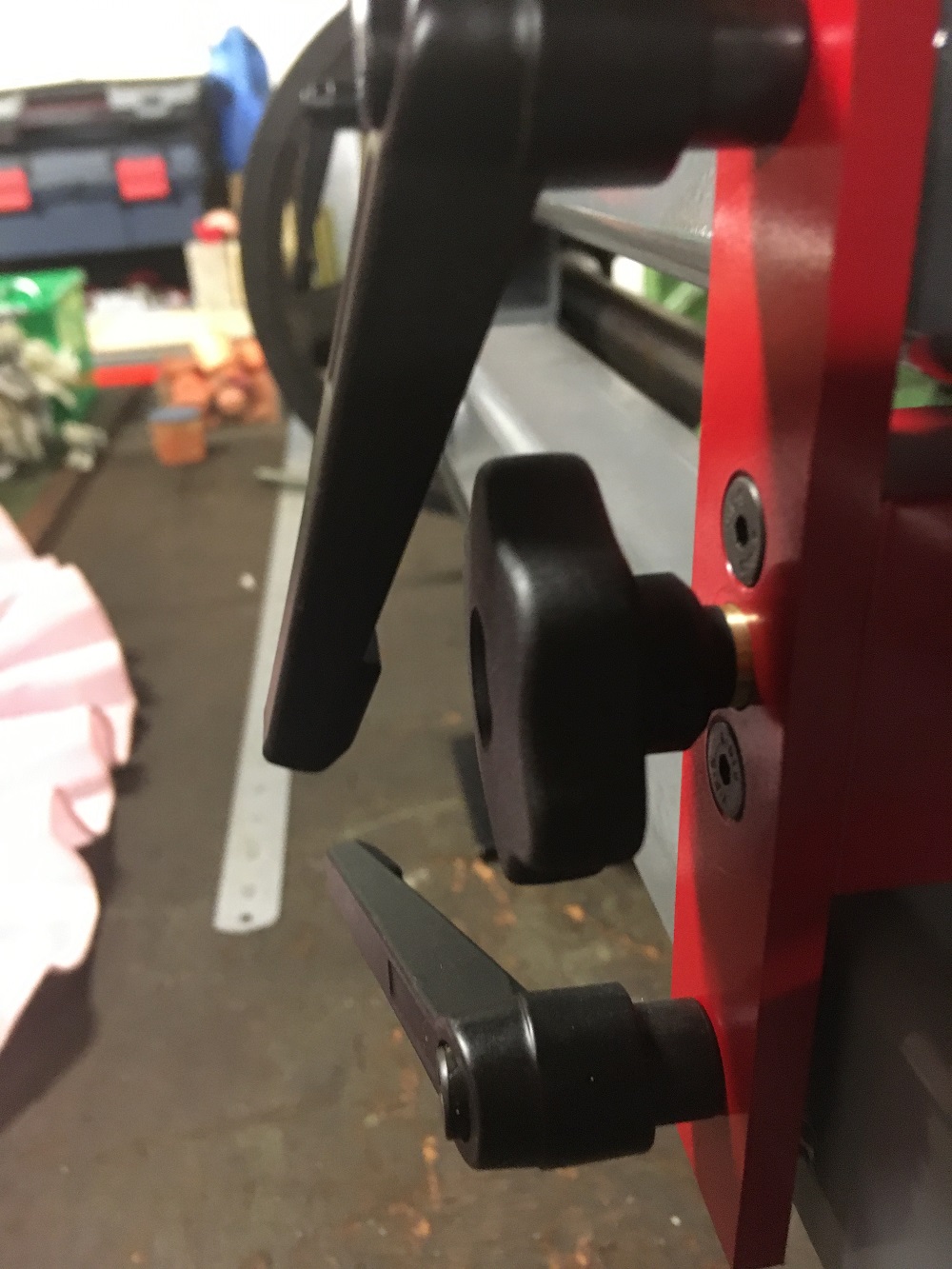

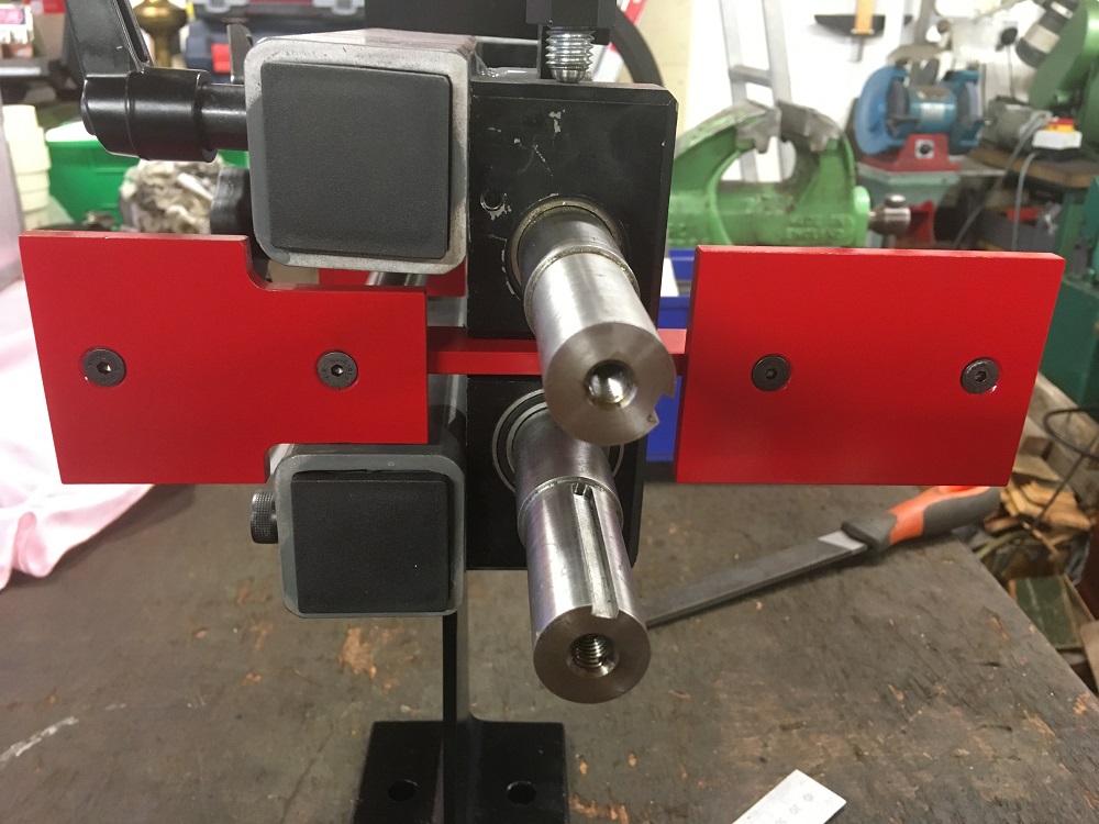

    I have also locked the two arms to prevent springing and incorporated the fence/stop to be mounted to this brace.
    Adjustable bead roller stop/fence
Name:	brace clamps missing Knob.jpg
ID:	31664 Click image for larger version.
Name:	in place.jpg

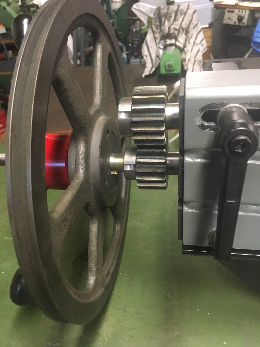

    The gear drive was calculated to give the desired distance between the shafts centres and ordered from eBay. There is also a locking clamp that can be seen in the photo which allows the shaft to move to align the dies, but still allows the gears to mesh to maintain the drive of both shafts.
Name:	gear drive.jpg

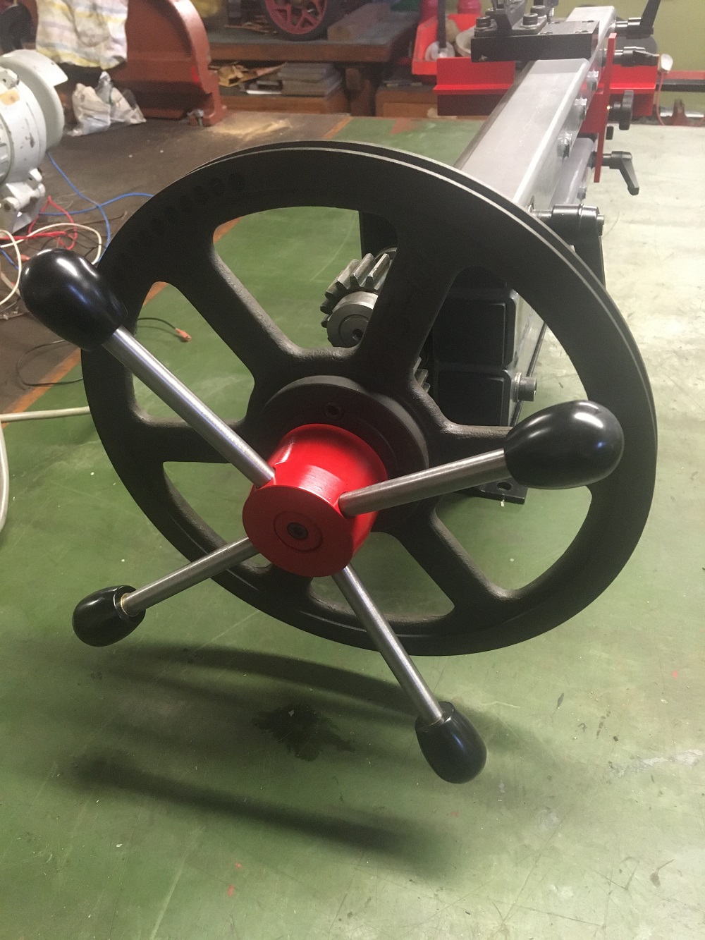

    There is a manual hand wheel which can either be removed completely or just unscrew the handles when the motor drive is in use.
Name:	drive pulley and hand wheel.jpg

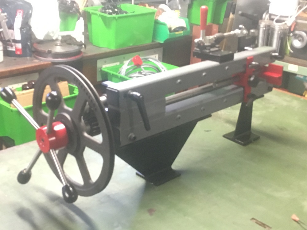

    Other views of bead roller.
Name:	back assembly.jpg
ID:	31668 Click image for larger version.
Name:	completed assembly.jpg
ID:	31669 Click image for larger version.
Name:	brace and fence assembly.jpg
