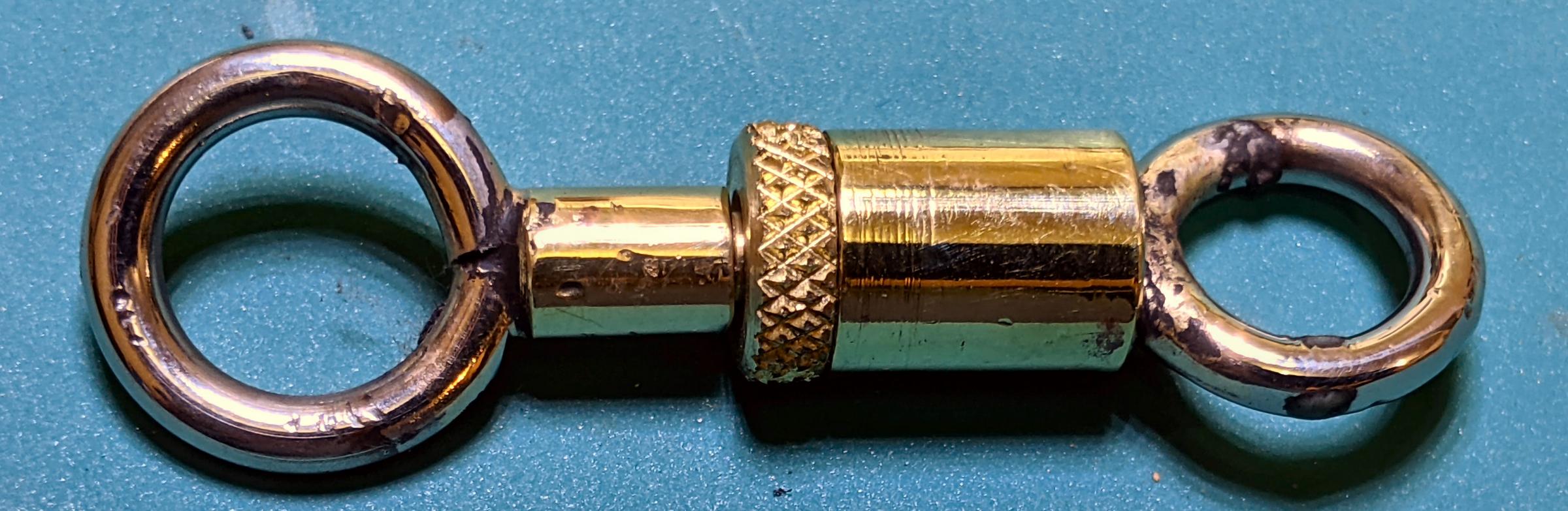

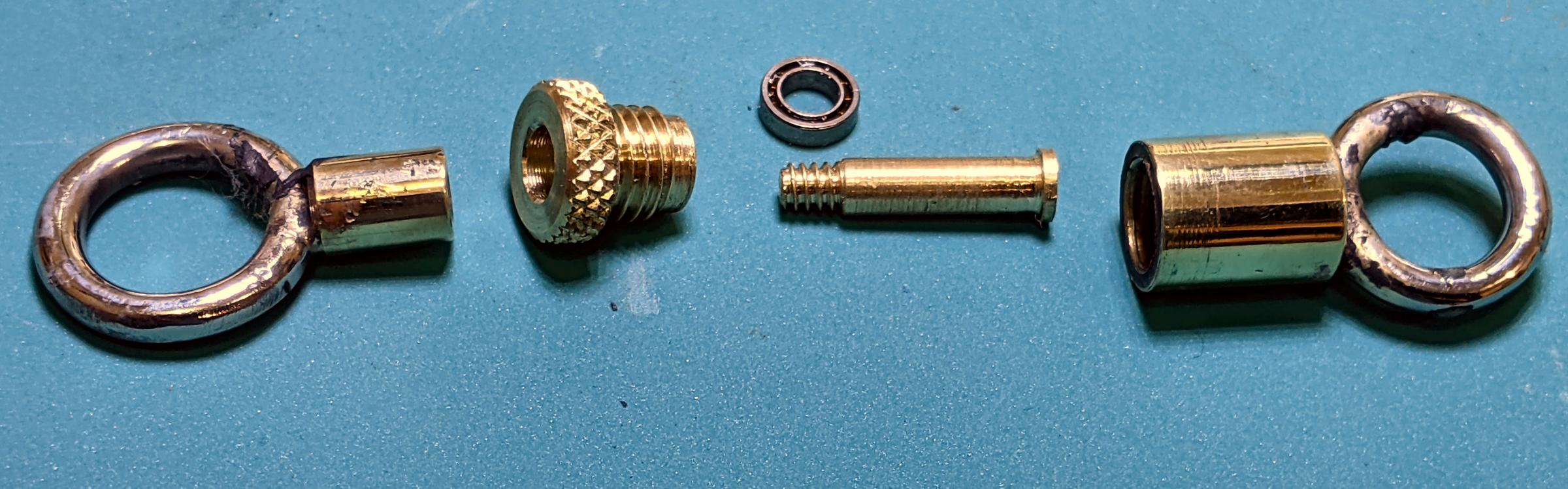

I found some stainless steel ball bearings on EBay, 4mm ID x 7mm OD x 2mm high, ten for 12 bux or something like that. I made one brass housing last fall. Made the other today. Need two, one at top and one at bottom.

The rings on the ends are made of 1/8” dia stainless steel welding rod. There are some tool marks because that stuff is not exactly eagerly compliant for bending. The black stuff is brazing flux that I didn’t get completely removed. I think boiling water would remove it or I could bead blast it off, but It won’t hurt anything.
If/when the bearings fail, I have 8 more on hand and it’s easy to disassemble the brass housing, replace the bearing and reassemble.
