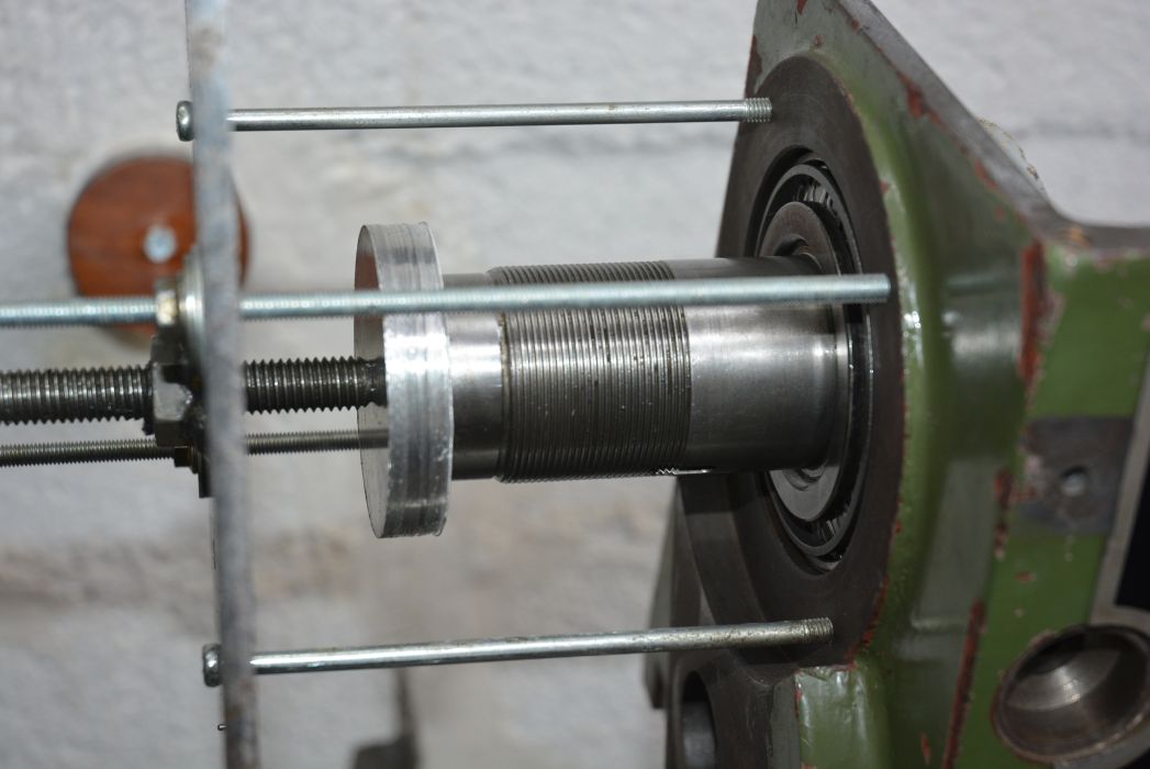

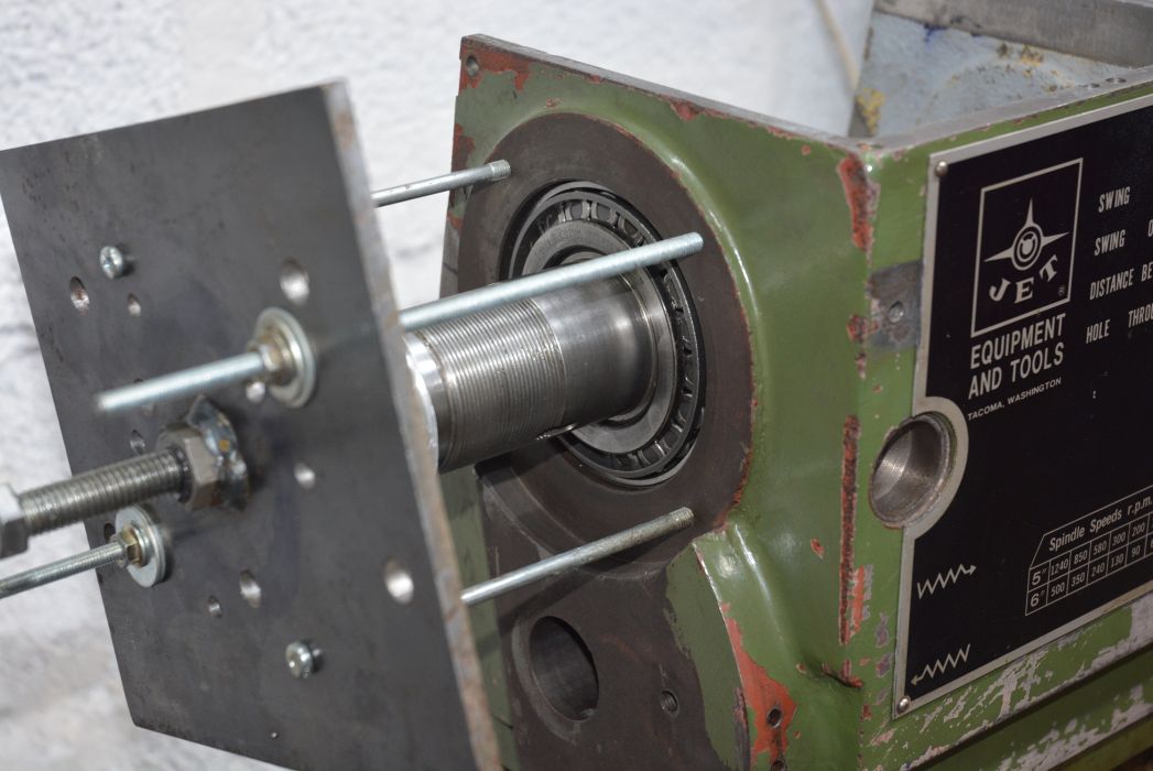

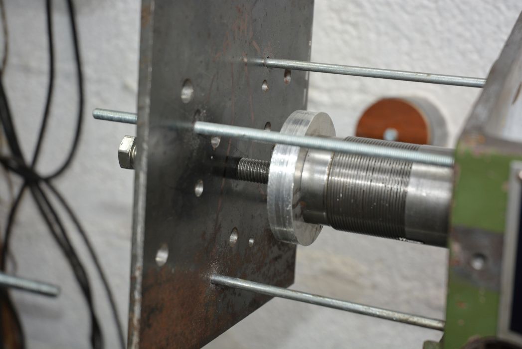

Here is an example of one of mine. The multiplicity of holes indicates that it is used for many different jobs, mainly crankcase disassembly and reassembly but in this case for pushing out a lathe spindle. Not all tools need to be of Rolls Royce quality as many of your own testify to. I agree that the puller in question leaves much to be desired and I would expect it to be next to useless.
Attachment 46143 Attachment 46144 Attachment 46145
