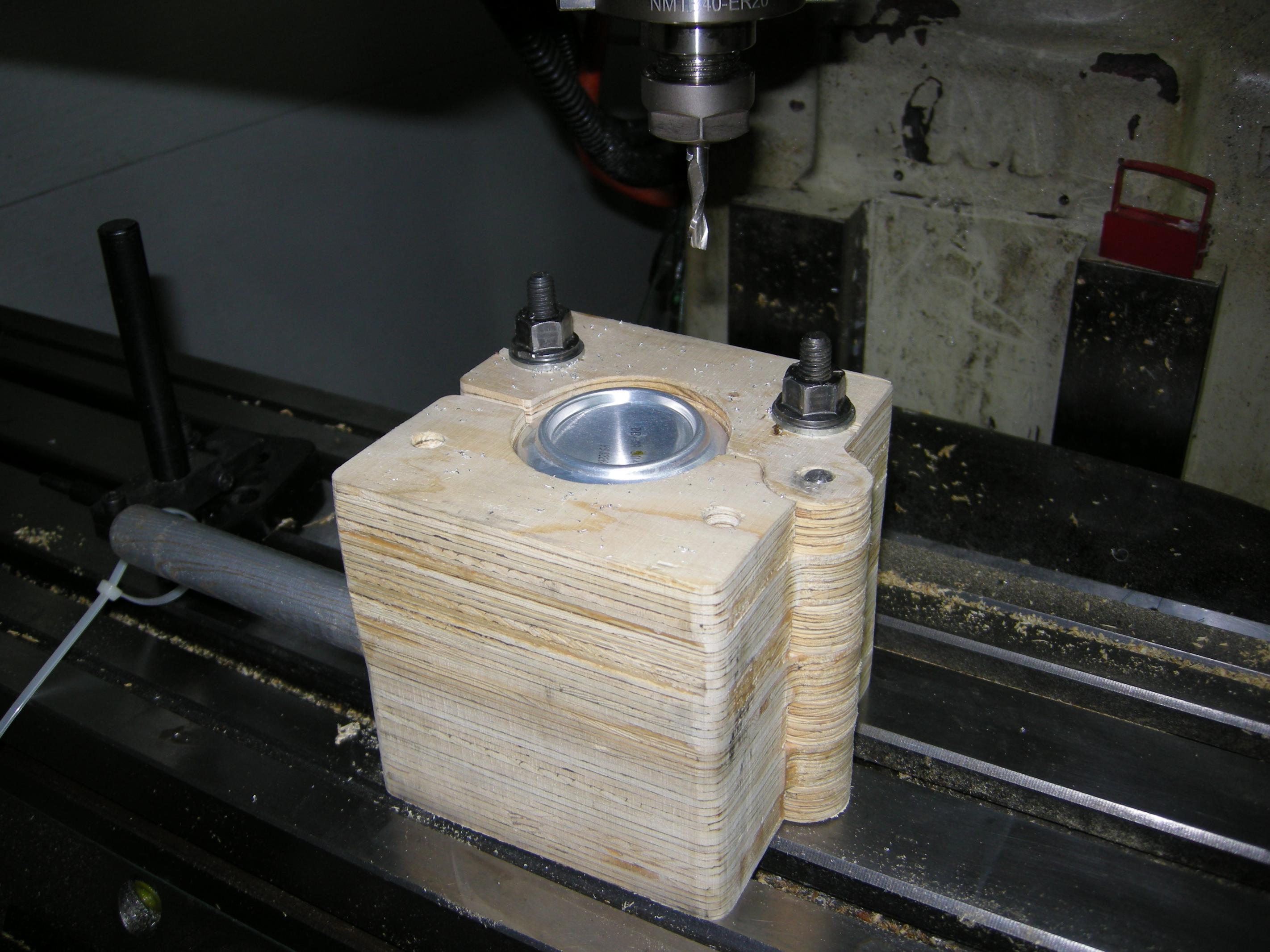

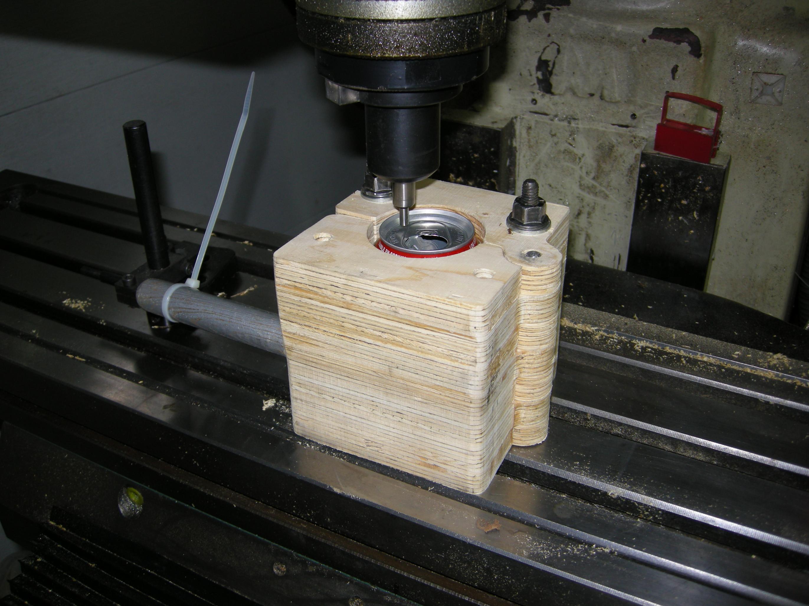

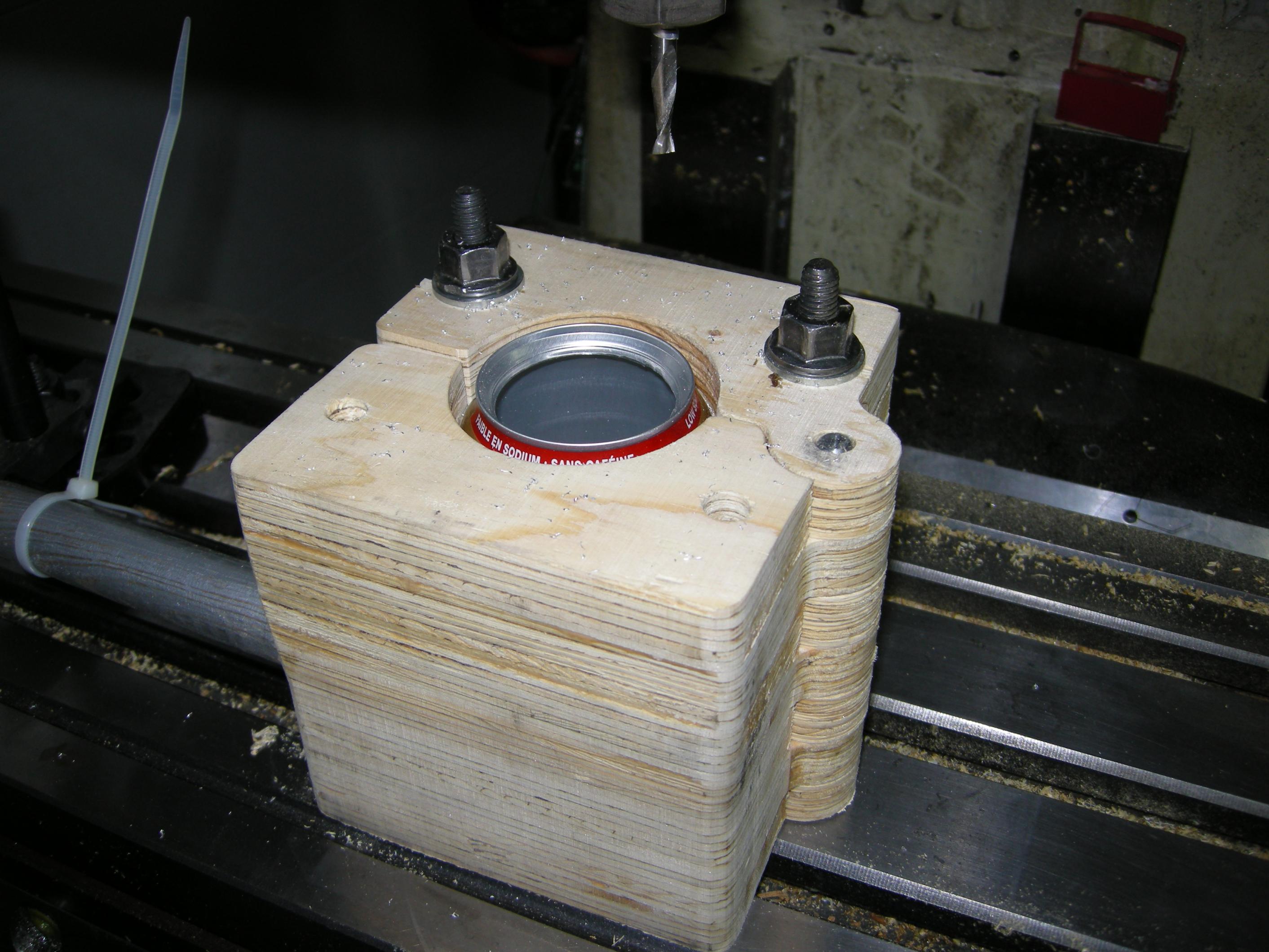

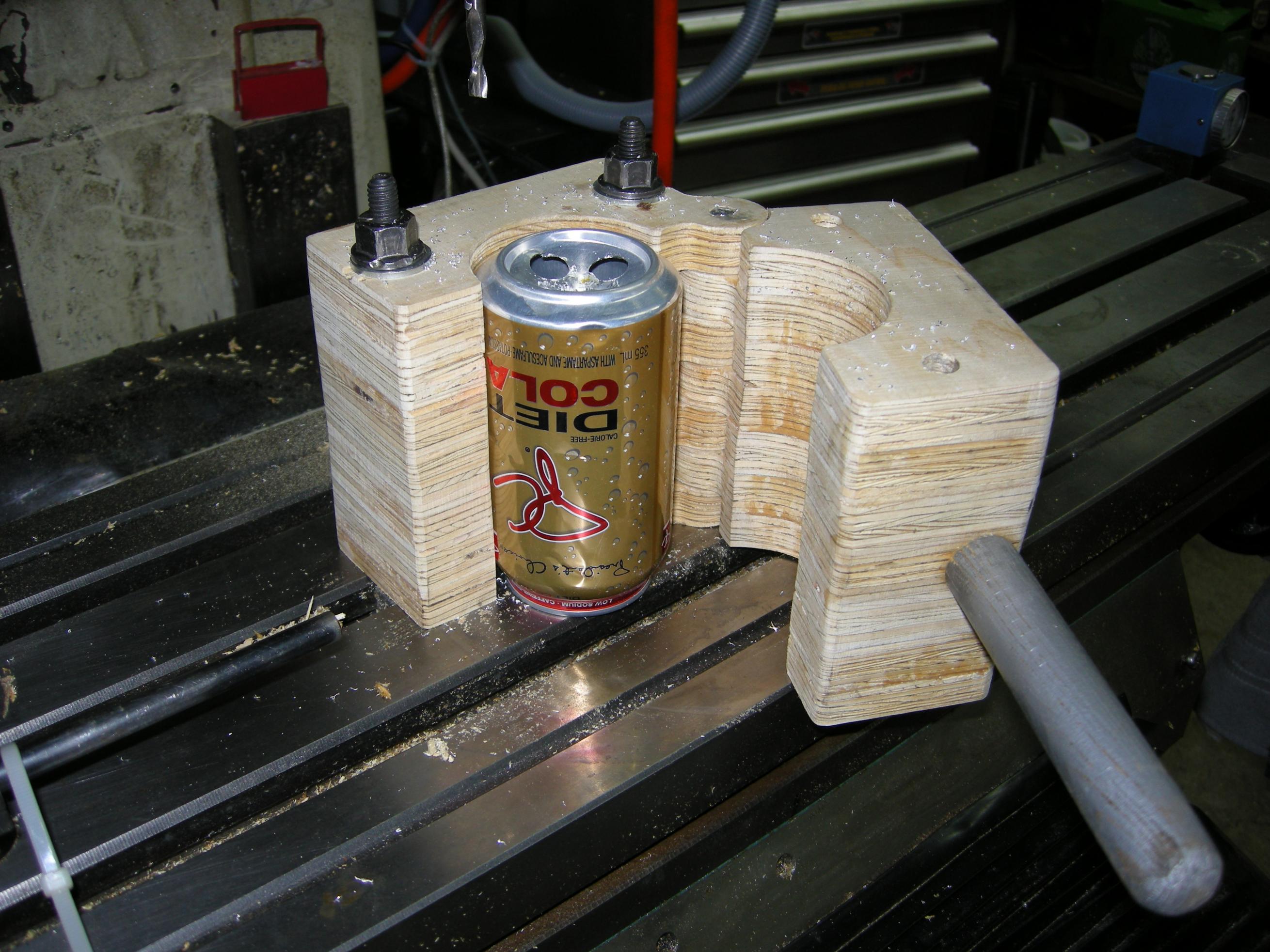

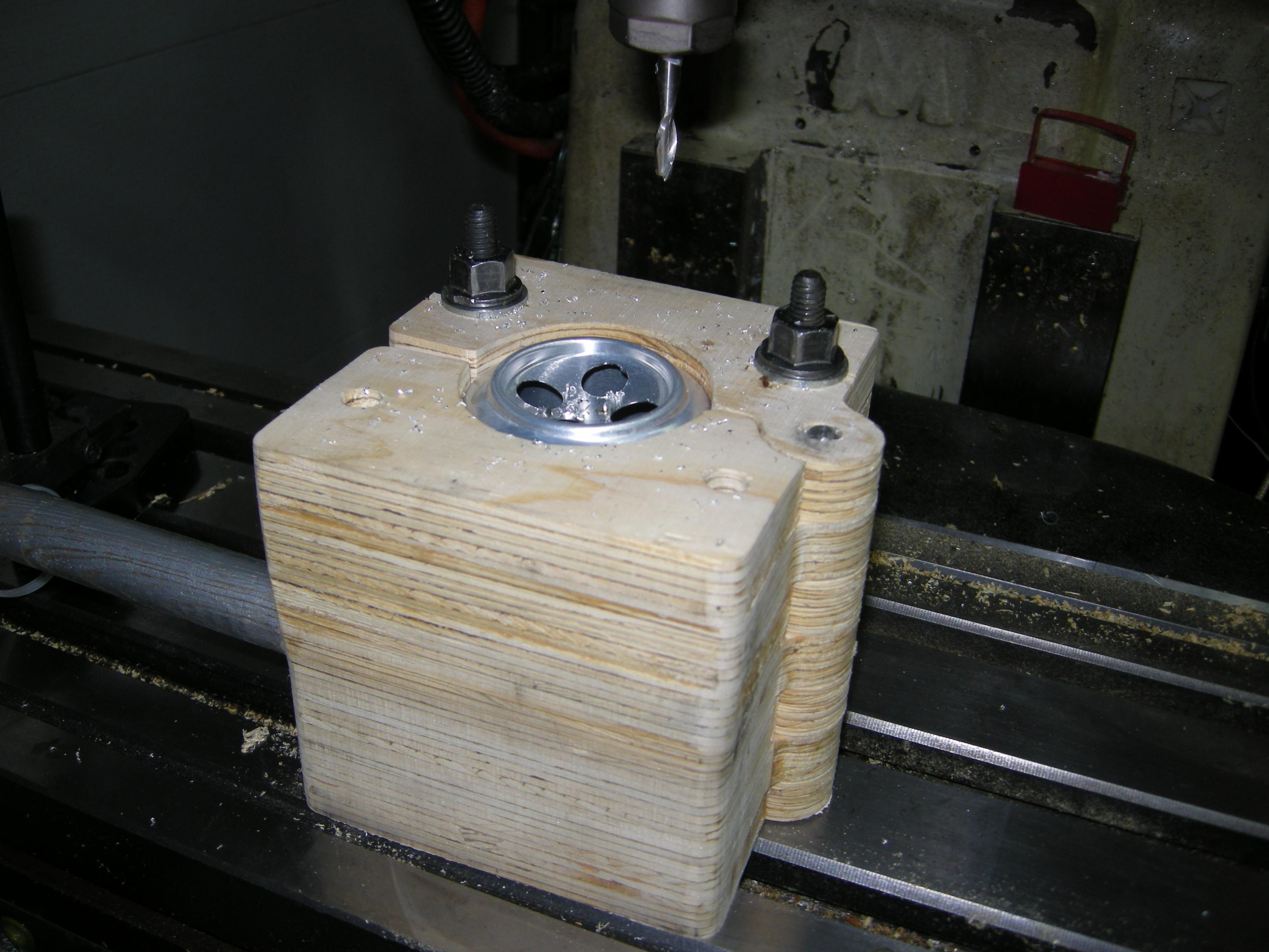

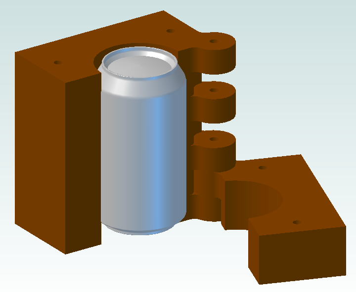

Hi,
Here are a few pictures of a simple device used to rapidly secure an empty aluminum container on a CNC mill table. Once the top is cut out the can is flipped over and four holes are machined in the bottom. My customer will use cans processed this way to fabricate a "tin can solar heater".
Best regards
Dan
