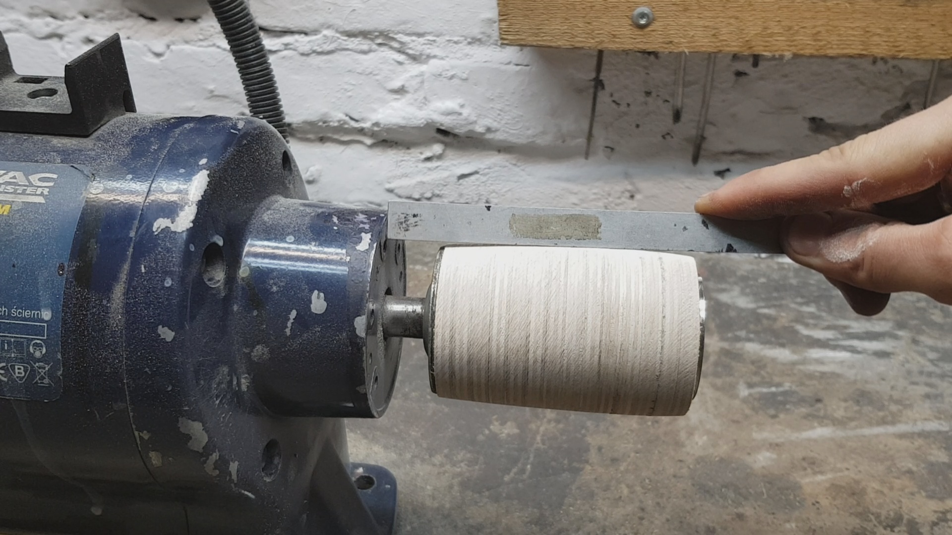

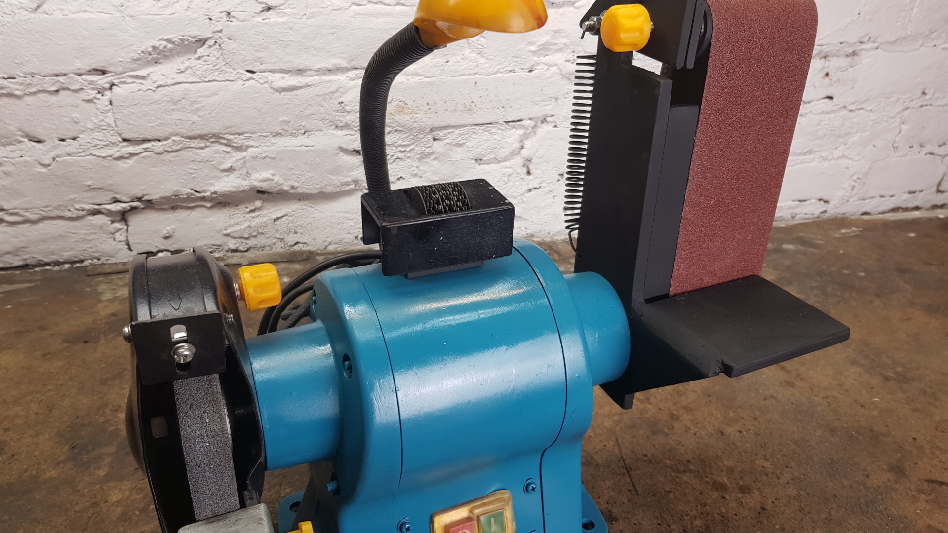

Attachment 32629
For this purpose I used an old table grinder that does not sin with power but for processing small wooden elements it will be just right.

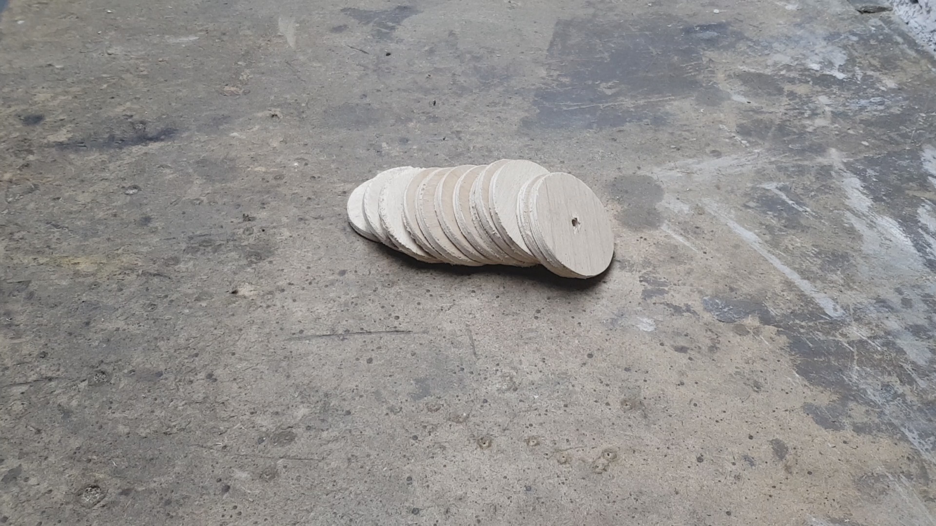

I made the roller from several plywood wheels which I cut with a hole saw.
Attachment 32626

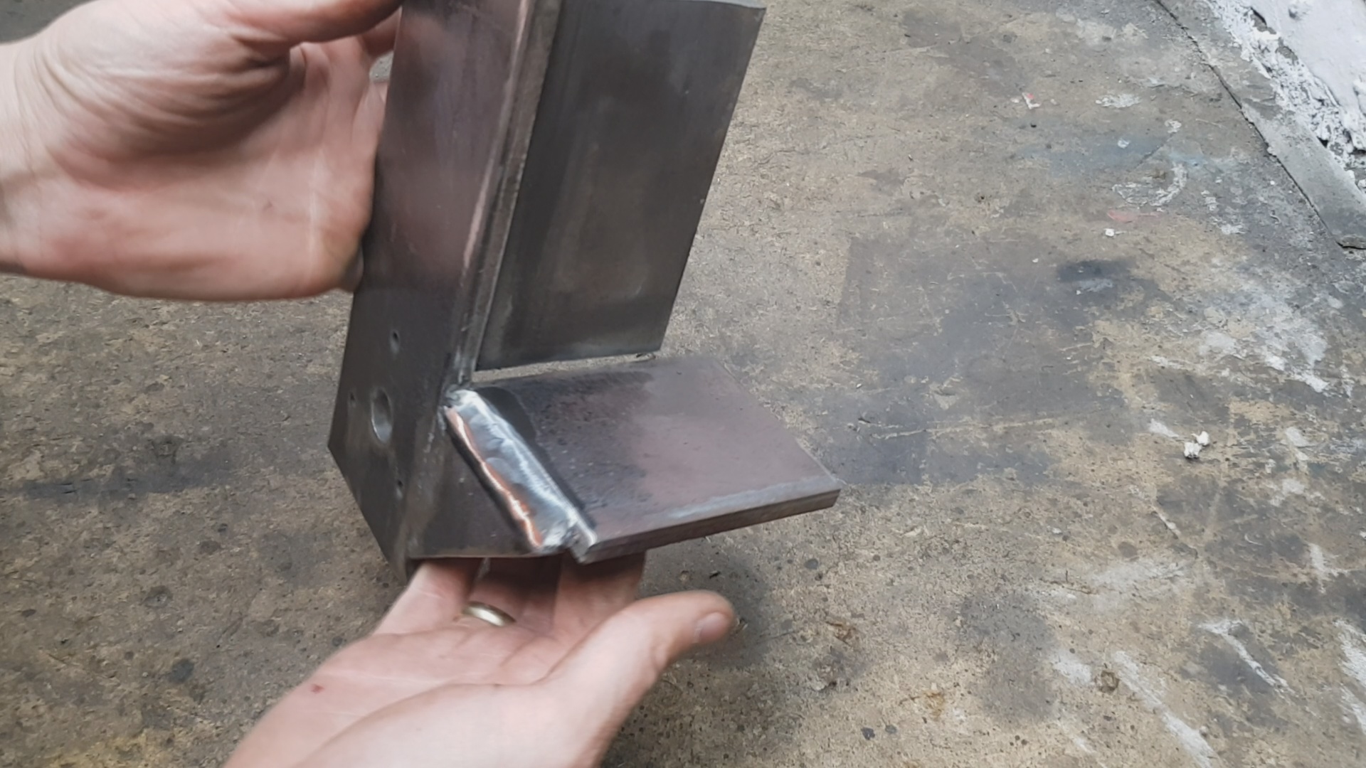

The whole body was made of a flat bar 8mm thick.
Attachment 32624

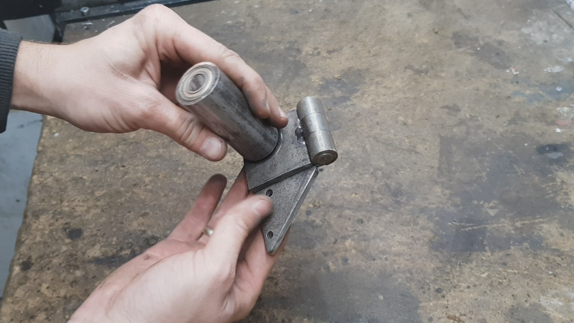

The steering roller and tensioning belt is a piece of tube with two bearings.
Attachment 32627

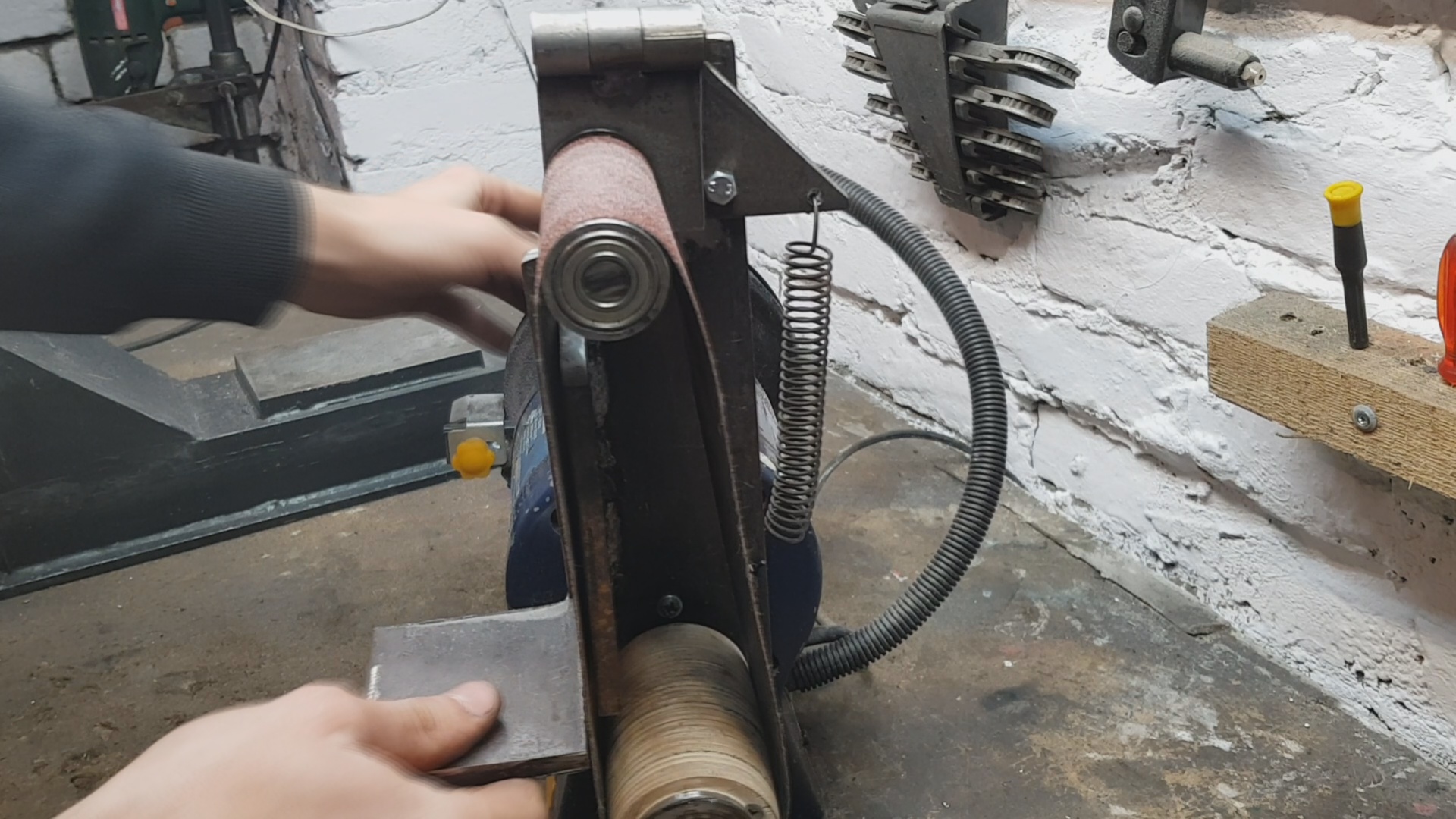

The tension is a spring of unknown origin.
Attachment 32628
