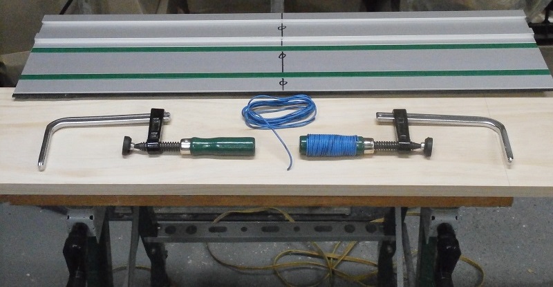

I love using my Grizzly track saw but it has one or two kinks that needed improvement. One kink was the clamps that were provided to hold the track in place on the wood being cut. Since these clamps attach to Tee Slots on the bottom of the track, the clamps are below the work and usually below one of my folding work tables, holding the work and track in place on it. So, tightening and loosening them is somewhat awkward. And the handles on the clamps are just round wood with a glossy paint that does not provide much grip.
Space under the top of the folding work tables is cramped with the mechanism for operating the vise like top so I did not want to increase the diameter of the clamp handles by much. I guess that is why they made them so small in the first place. But I wanted a better grip.
After looking around the shop, I found some scrap electrical wire, about 14 or 18 gauge that had a somewhat rubbery insulation on it. It would definitely provide a better grip than the glossy, painted surface. I drilled a couple of holes in the wood handles and cut two pieces of the wire to be wound between them.
Attachment 24944
You can see the original clamp on the left. On the right is a second one with the wire grip installed. In the center is the coil of wire that I used.
I drilled the two holes a bit larger than the outer diameter of the wire for an easy fit. Some super glue in the hole secured the end of the wire and after wrapping the first turn I added more super glue all around the junction of wire and handle. I continued wrapping and adding some super glue every five turns until I got to the second hole. After each five turns were wrapped but before the super glue was added I made sure that those turns were tightly packed against each other. At the end with the second hole I pre-shaped the end of the wire to fit into the hole and then unwrapped one and a quarter turns and added super glue around the wire-handle junction and a drop in the hole. Then that last turn was completed and the end inserted into the hole. Some scotch tape held everything in place until the super glue dried.
Now they are a lot easier to install and remove.
