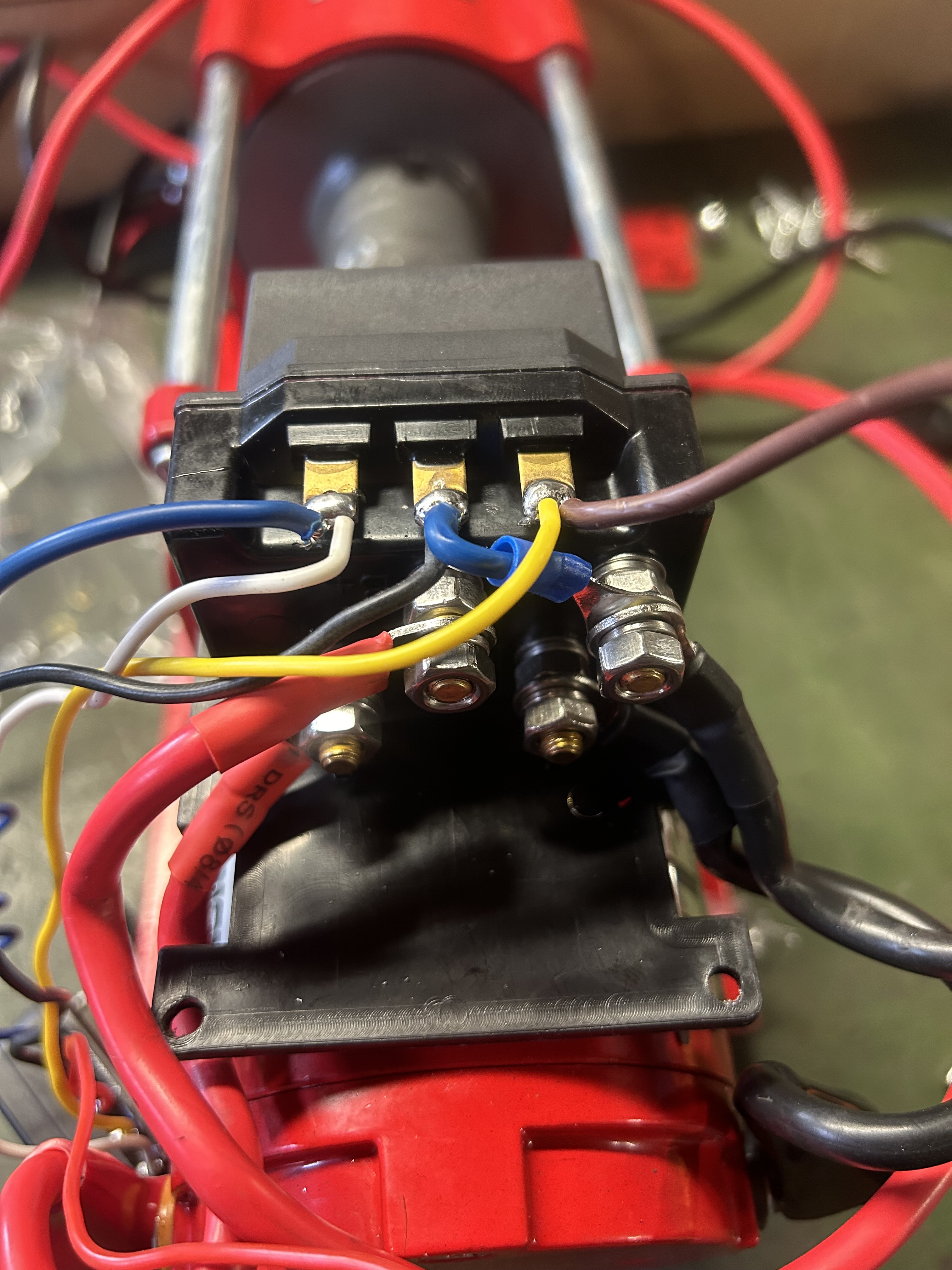

Attachment 47795 Originally wiring including the remote control unit.

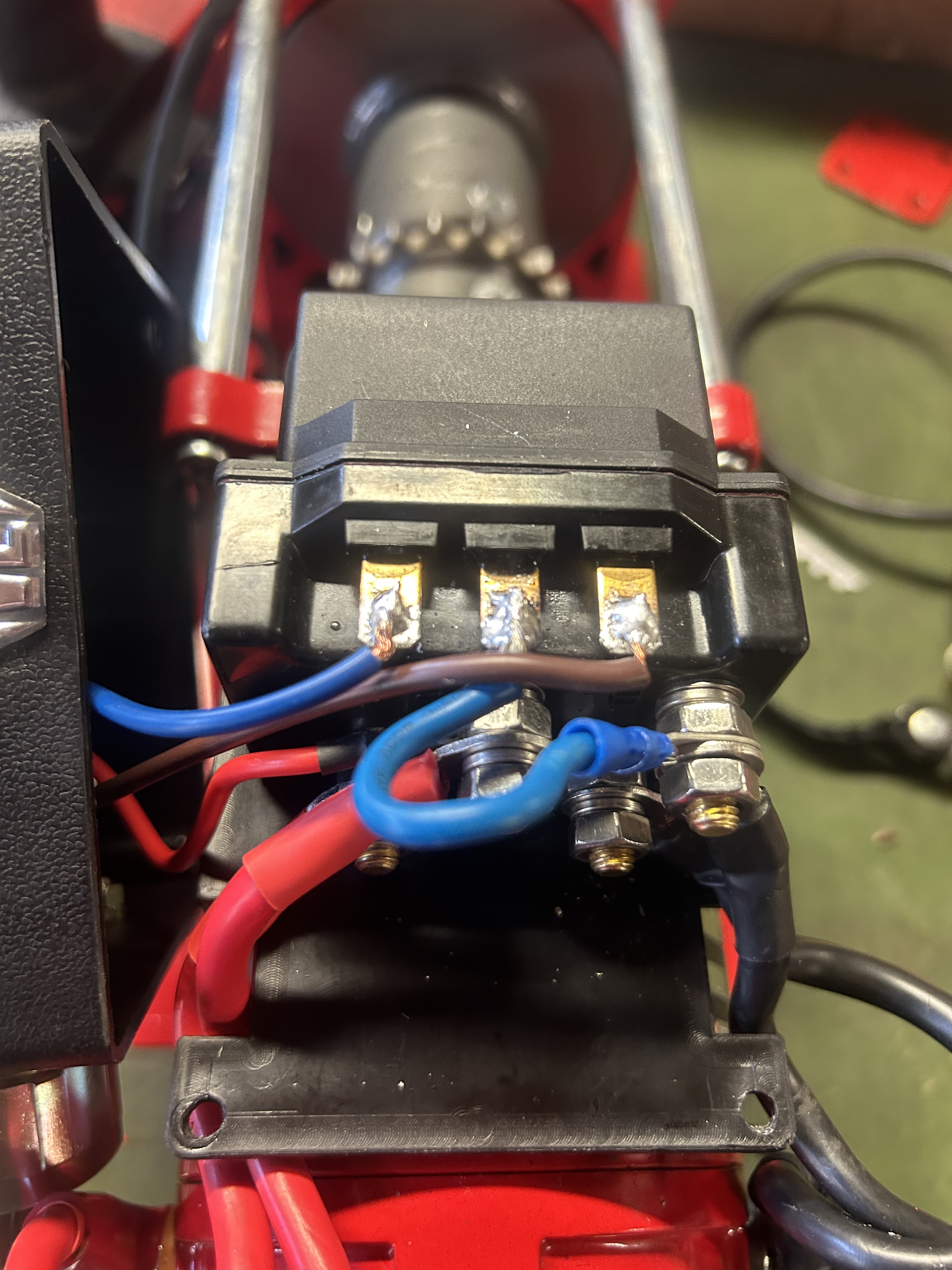

Attachment 47796New wiring.

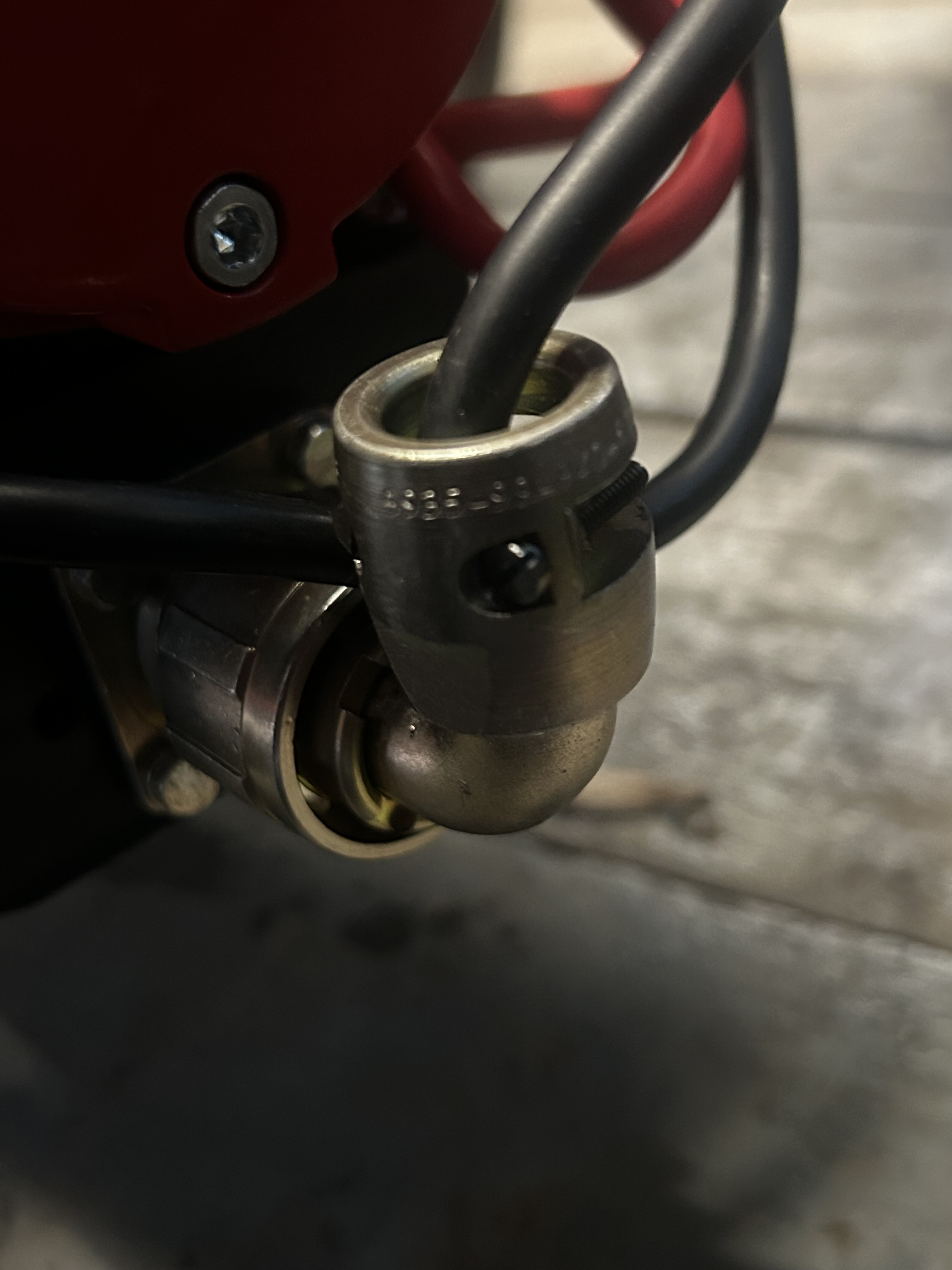

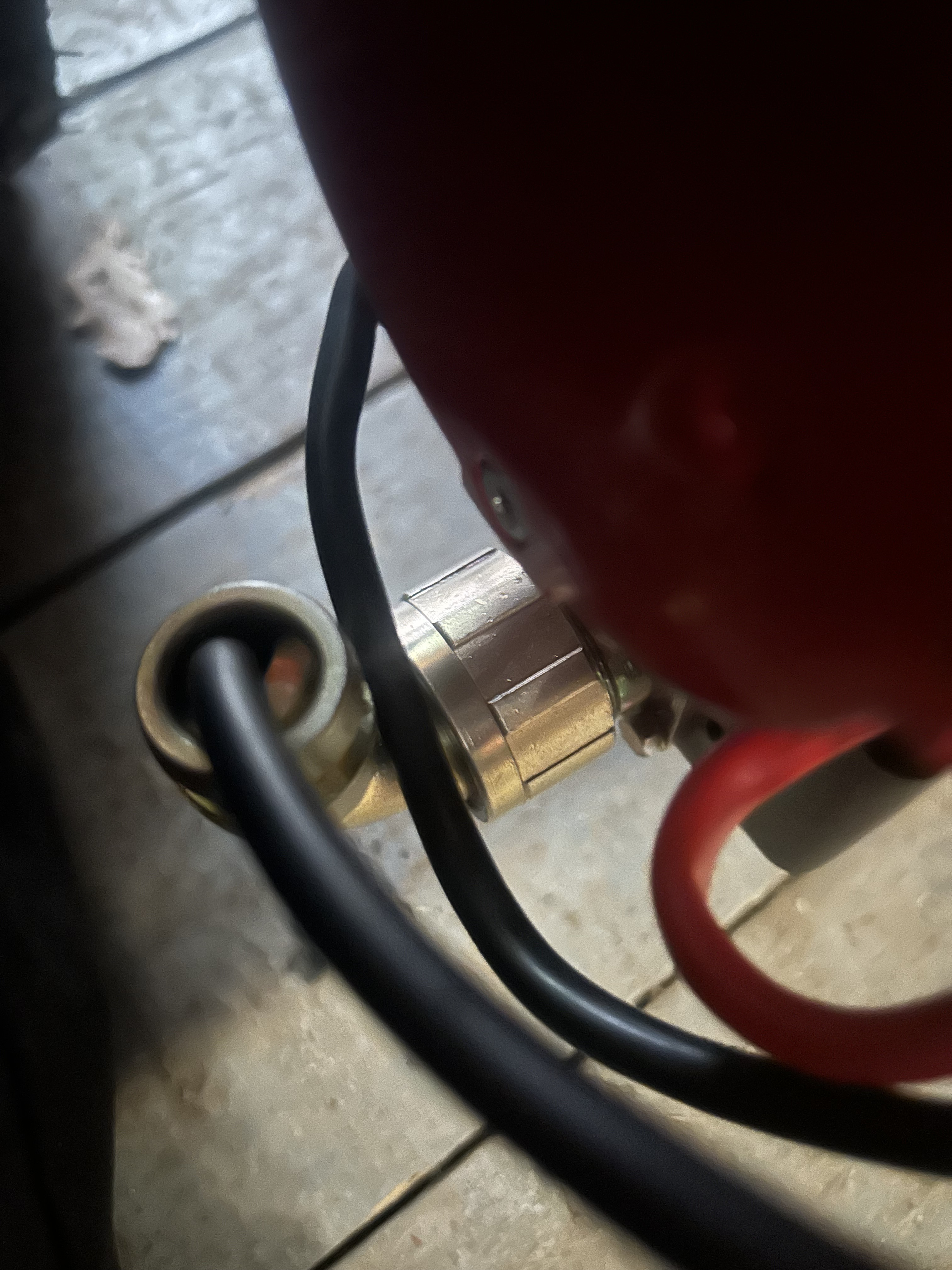

Attachment 47797 Attachment 47798 Plessey plug and socket.

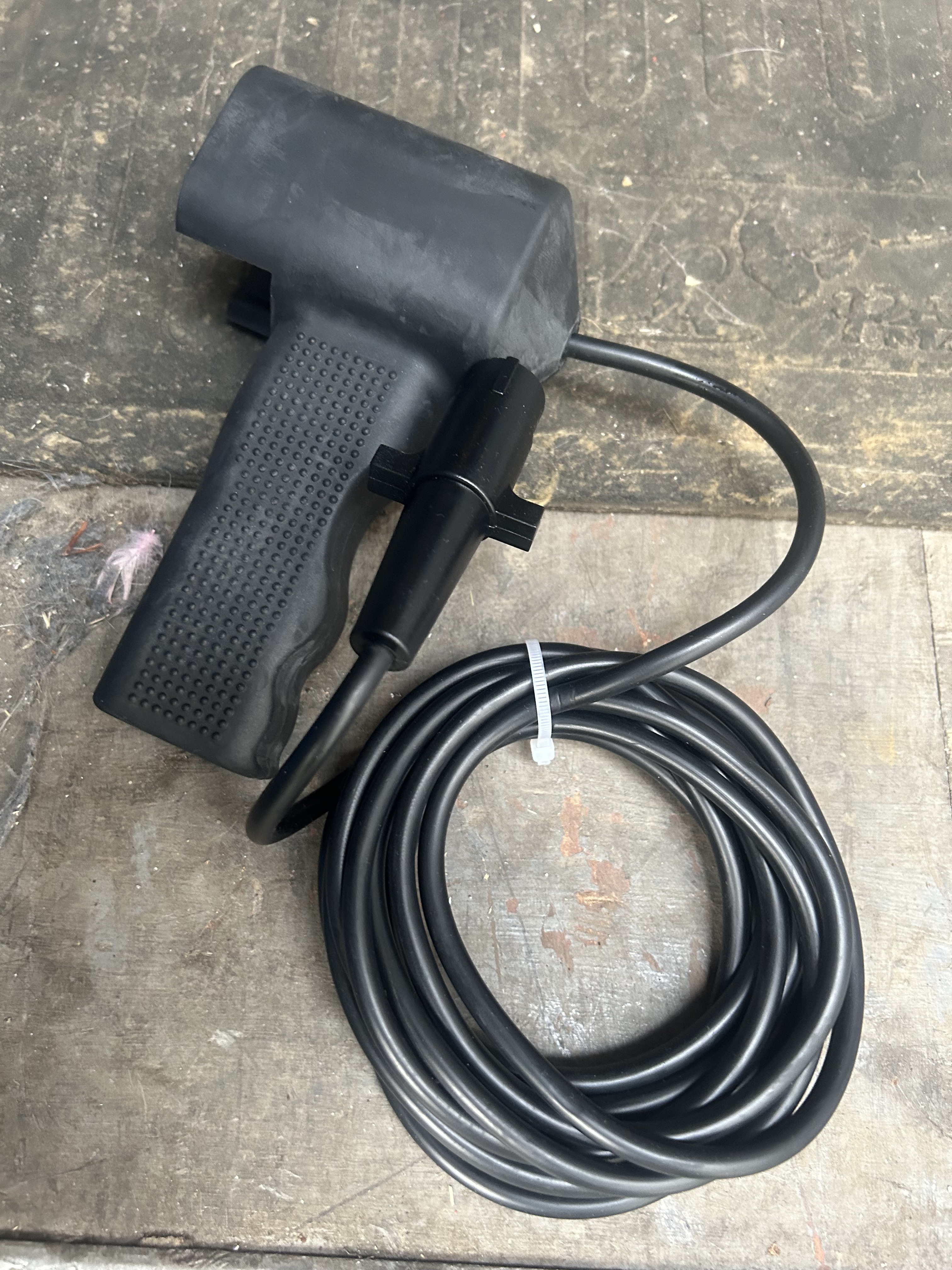

Attachment 47799New replacement wired hand controller. (Not used)
