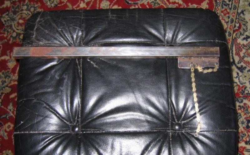

    bicycle chain whip....
    bicycle chain whip....-whip.jpgthis is used to remove threaded cogs on fixed gear/track bike wheels, welded it together and it has never failed to loosen even the most recalcitrant cog ;-) Chain whips are also need on multi gear bikes to prevent the cassette from spinning when removing the lockring

    Thanks Bluto! We added this one to our Miscellaneous category (looks like we might need to add a Bicycle category) and to your homemade tools page: Bluto's Homemade Tools. Your receipt:
