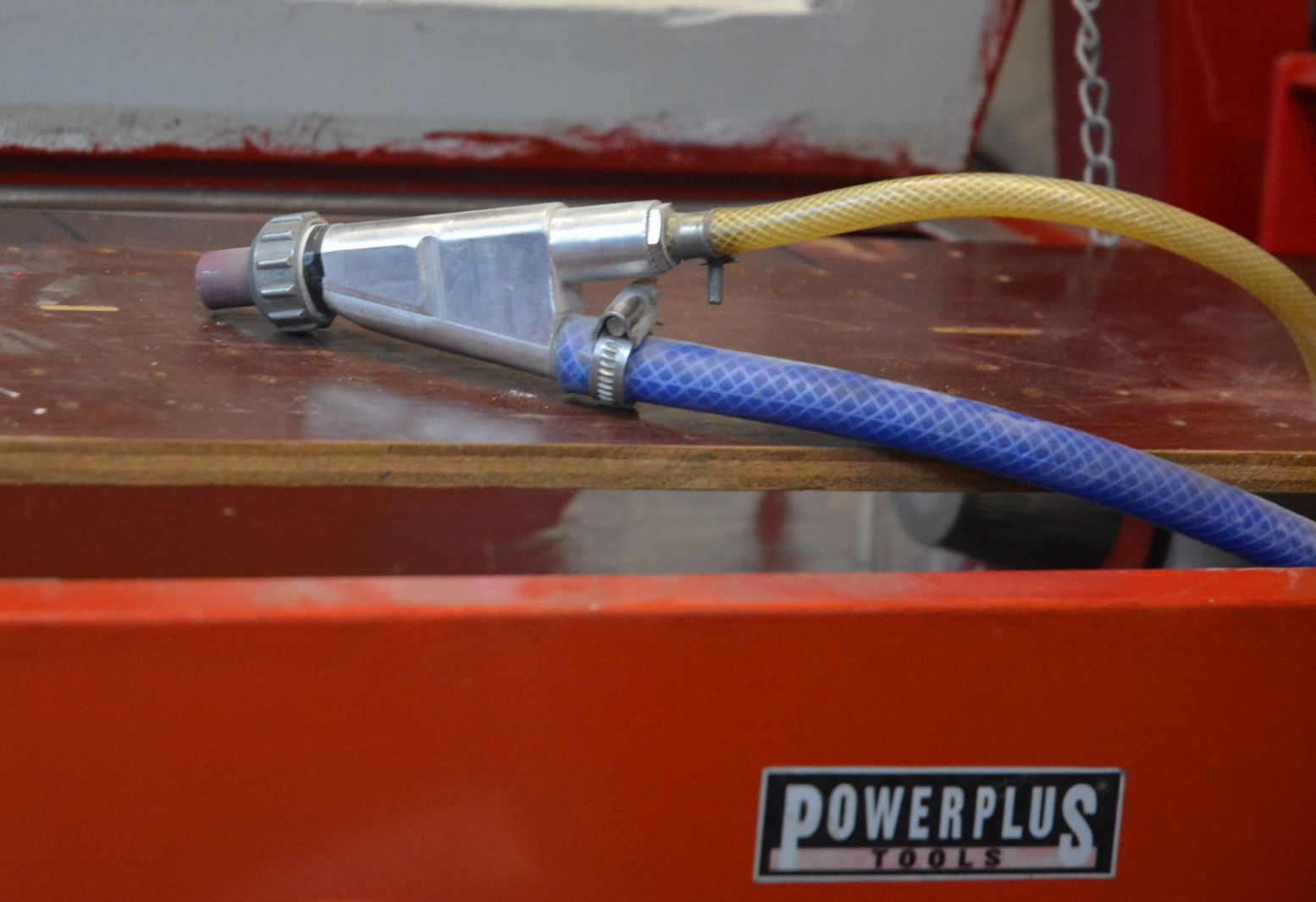

1 Attachment(s)
I have the same model blaster although badged differently. I like your window frame, that must be a huge improvement.
I adopted a different approach, you may be interested in some of the mods that I made to mine which featured in an earlier post.
https://www.homemadetools.net/forum/...695#post209645
It is now 2 or 3 years since I did those mods and usage in that time has indicated that the only thing that still needs attention is the hopper as mentioned in the post. That is not high on my todo list though.
Not mentioned in that post was that I made a new gun from scratch. The media passage was aligned to be more inline with the air flow. It was a great improvement.
Attachment 49462 Click for full size.
