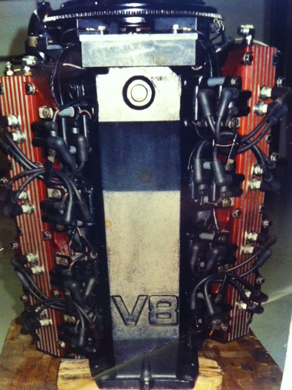

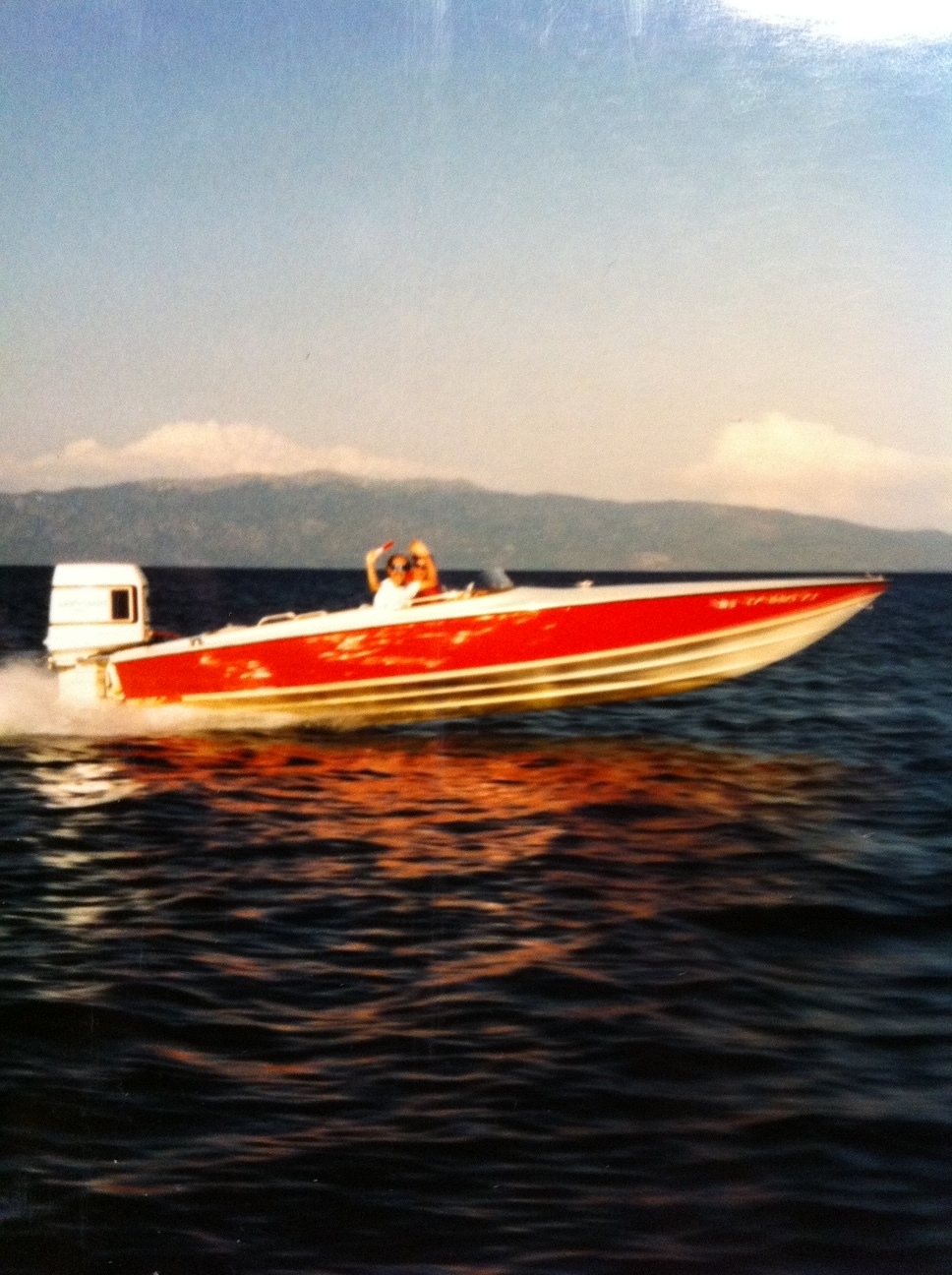

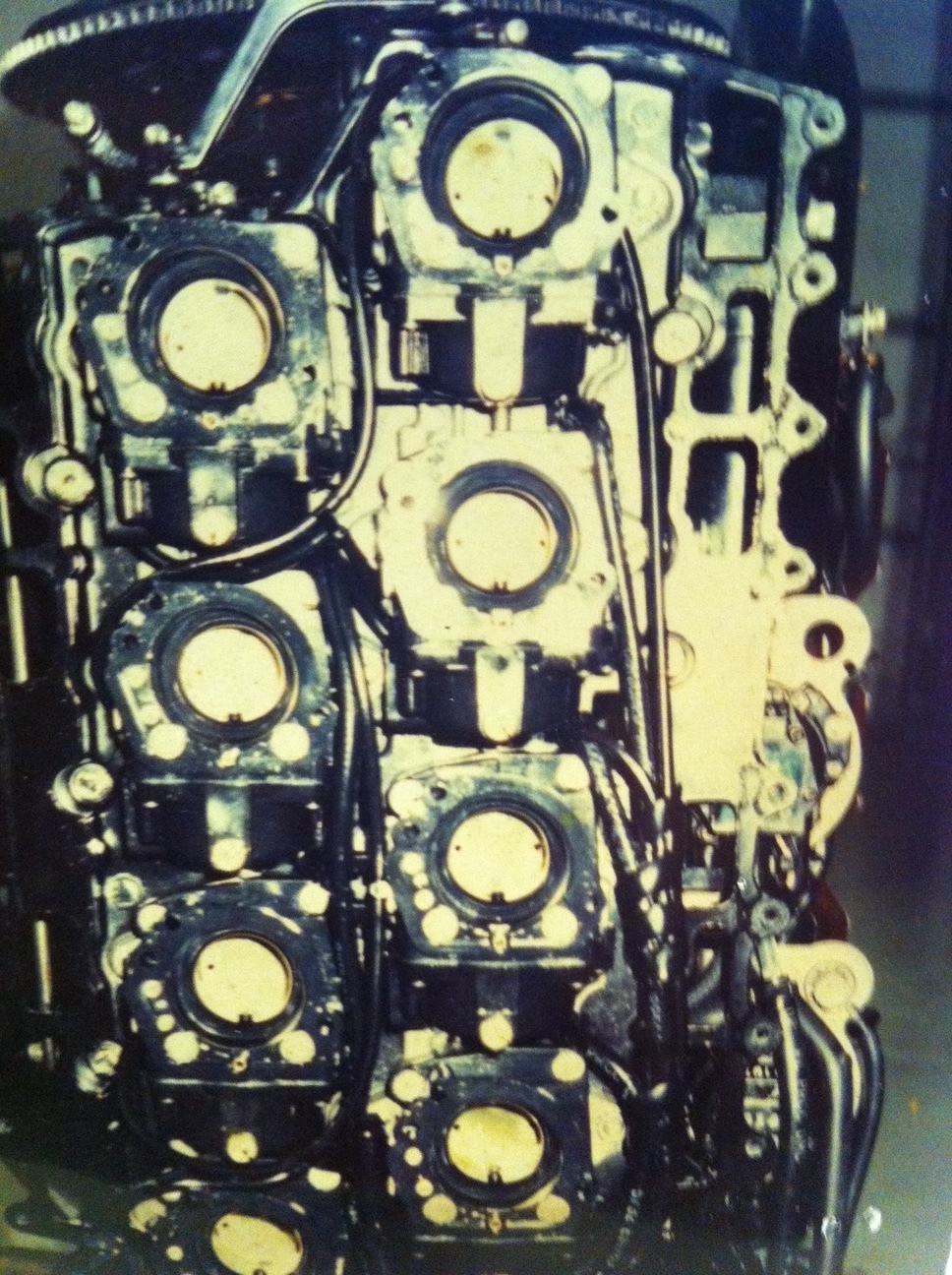

My boat had one 400 hp 4 liter 13.8 to 1 compression ratio 25 to 1 gas oil mix V8 2 stroke 6250 RPM 1/2 a gallon a minute at 77 MPH 6200 feet elevation. Then the governing board(TRPA) outlawed carbureted two stroke engines...
Attachment 44417Attachment 44418Attachment 44419

What kind of motor was that? Bored out Evinrude 300XP? I love 2 strokes. It's a shame Evinrude is pushing up daisies. I want to put an E-TEC into a small car.
It was a Johnson 3.6 300 HP. Bored out to 4 liters, finger ports added, 2 per cylinder. Boyson two stage fiberglass reed valves. Land and Sea dual spark plug high compression heads. Velocity stacks. Modified exhaust. Nose cone on the lower unit. Custom stainless steel engine bracket that moved the engine back 12 inches and put the prop shaft centerline to the keel. 13 1/4 X 29 4 blade stainless propeller. 12 X 24 cast aluminum K-Planes. Hydraulic steering. The boat was George Linder 21 Challenger with a balsa core hull. Wonderful boat in rough water.
