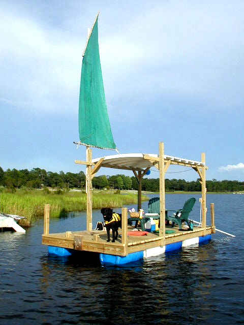

BoatBuilds.net: Shantydock Pontoon Boat by David Beede
This pontoon boat was built by David Beede on SimplicityBoats.com.

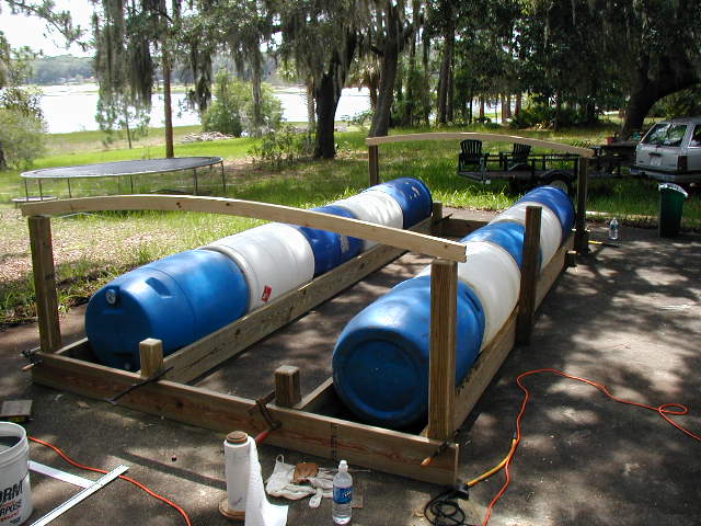

David admits that the boat is really a glorified large swim platform; nothing wrong with that. :)

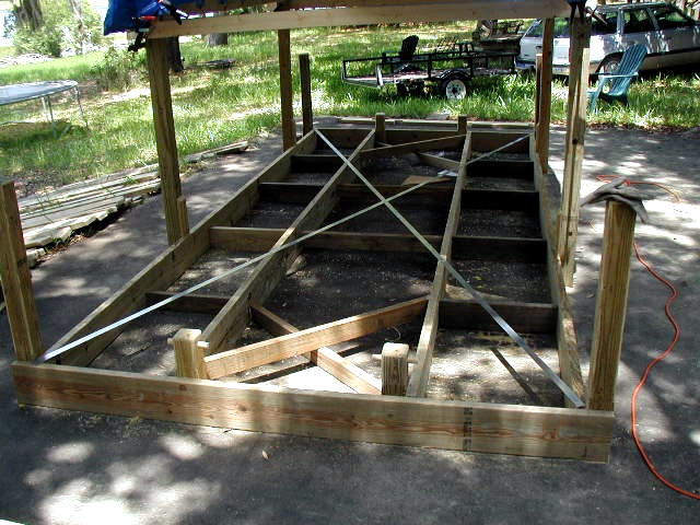

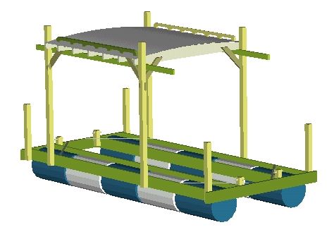

The details:

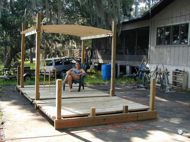

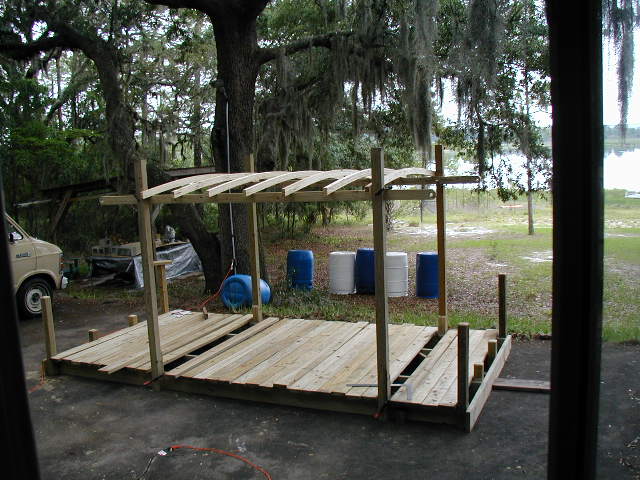

-pressure-treated 2x8's for frame
-4x4 roof posts and 2x4 roof supports

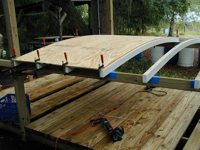

-plywood roof bent over arched rafters
-2x6 deck
-60-gallon $12 plastic barrels from feed store

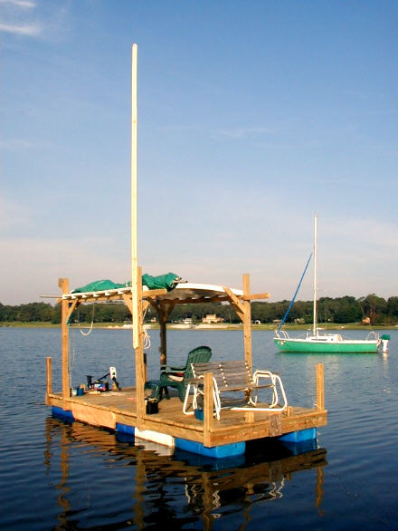

-16-foot spruce 2x4 for mast

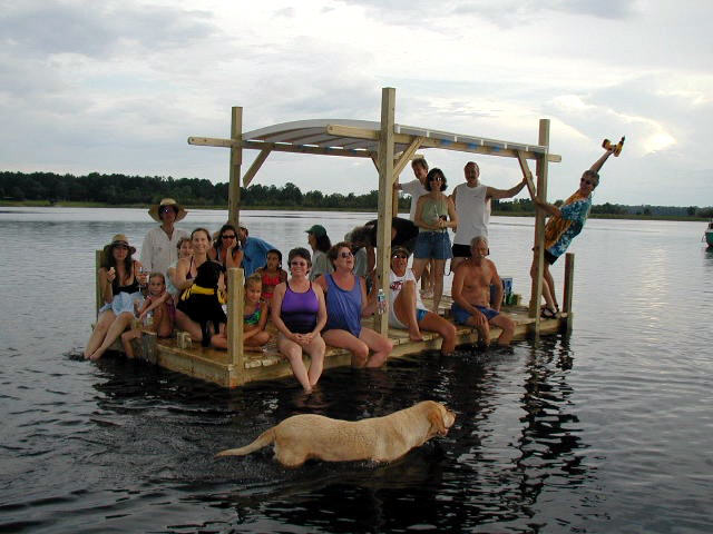

What's the boat capacity? Confirmed at 17 adults, 3 kids, and 2 dogs.
