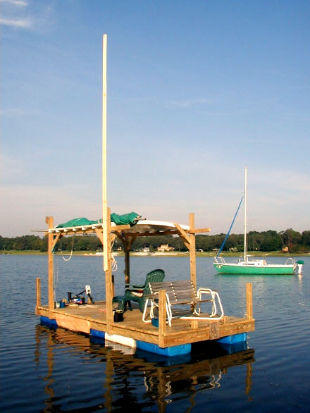

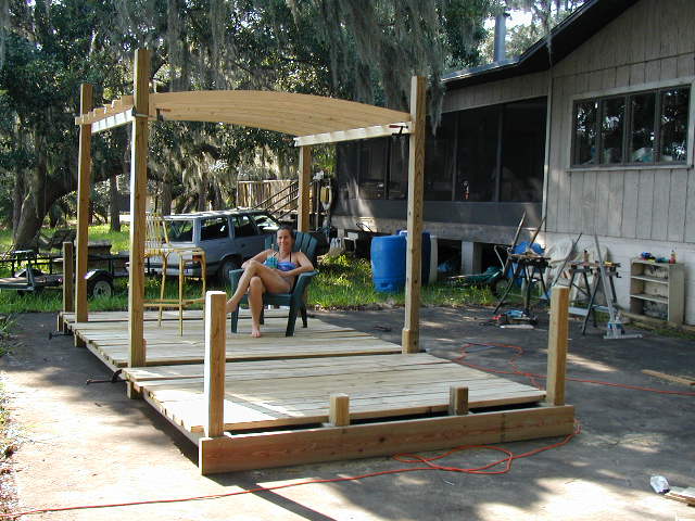

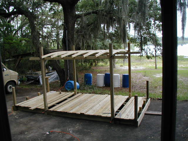

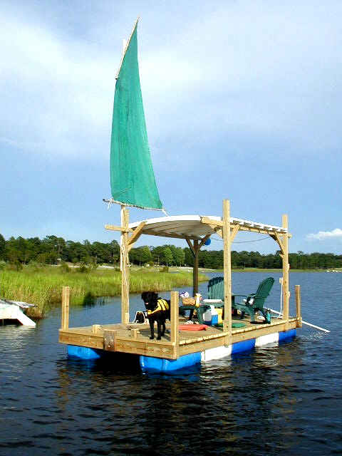

This pontoon boat was built by David Beede on SimplicityBoats.com.
David admits that the boat is really a glorified large swim platform; nothing wrong with that.

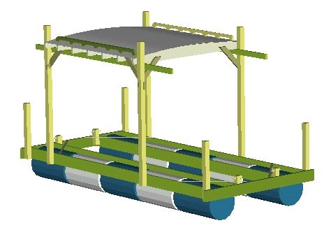

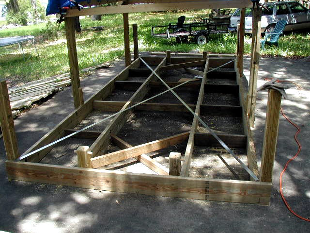

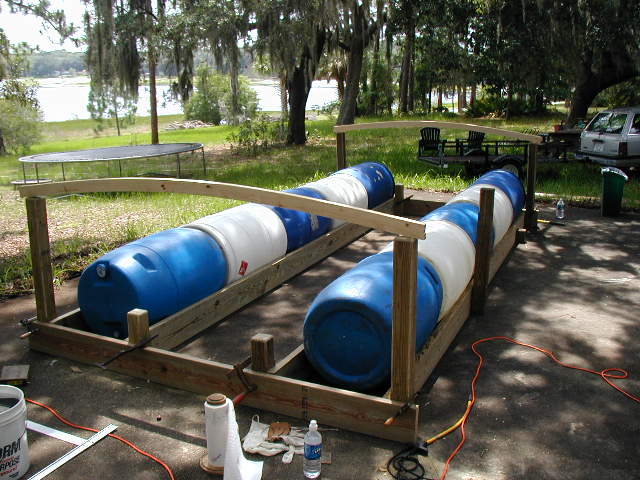

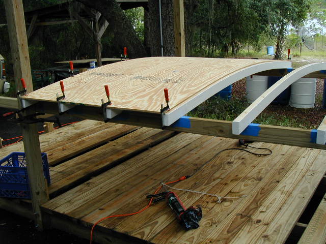

The details:
-pressure-treated 2x8's for frame
-4x4 roof posts and 2x4 roof supports
-plywood roof bent over arched rafters
-2x6 deck
-60-gallon $12 plastic barrels from feed store
-16-foot spruce 2x4 for mast

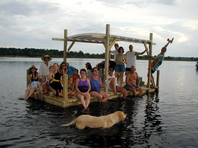

What's the boat capacity? Confirmed at 17 adults, 3 kids, and 2 dogs.
Shantydock Pontoon Boat by David Beede on SimplicityBoats.com
