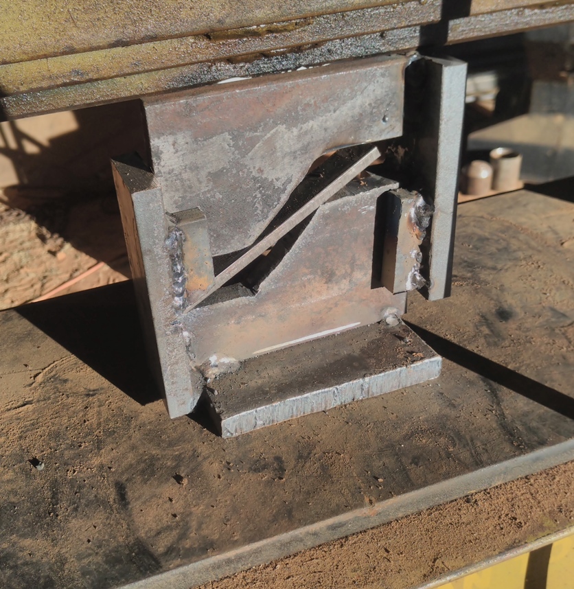

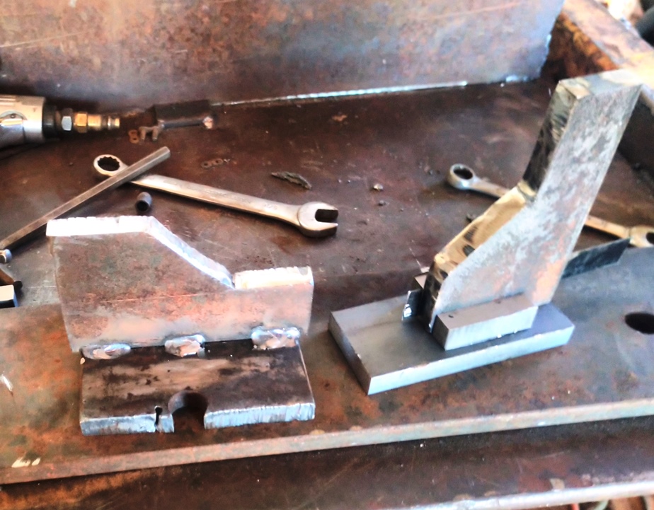

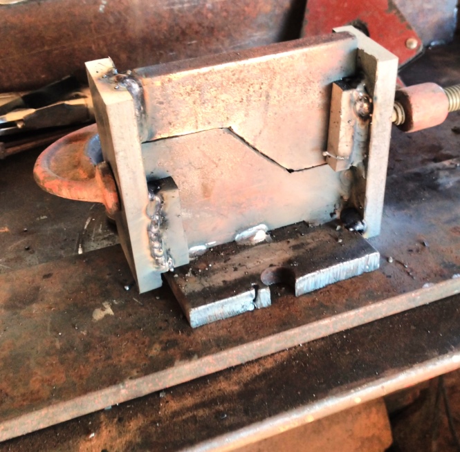

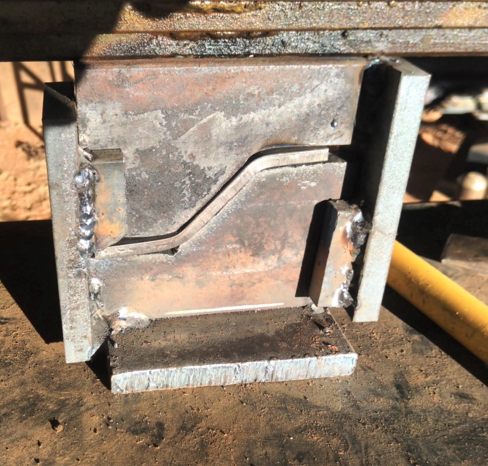

I have a small run series of some brackets to make and they all need to be very close to identical.
I could have used a bender for these easy enough but decided to just press them in a single operation by making a simple punch & die for my shop press
Attachment 40926
Attachment 40927
Attachment 40928
Attachment 40929
