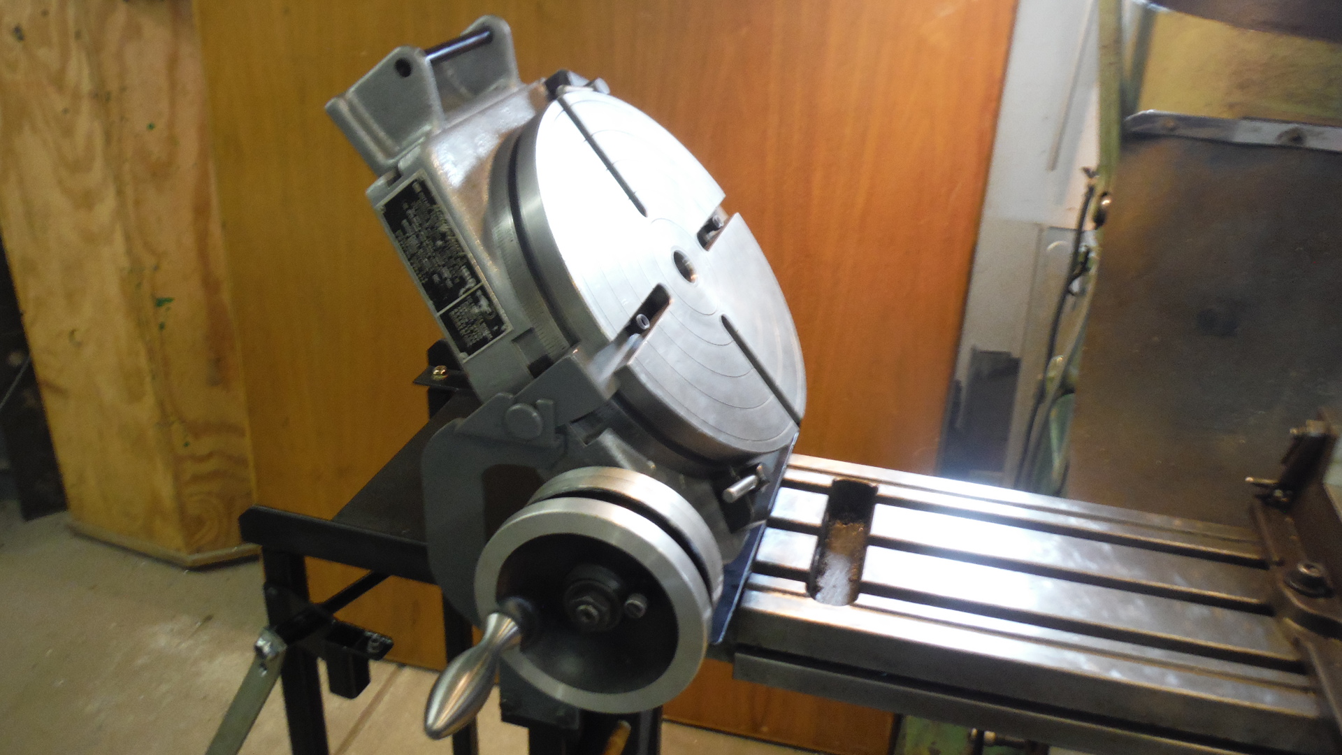

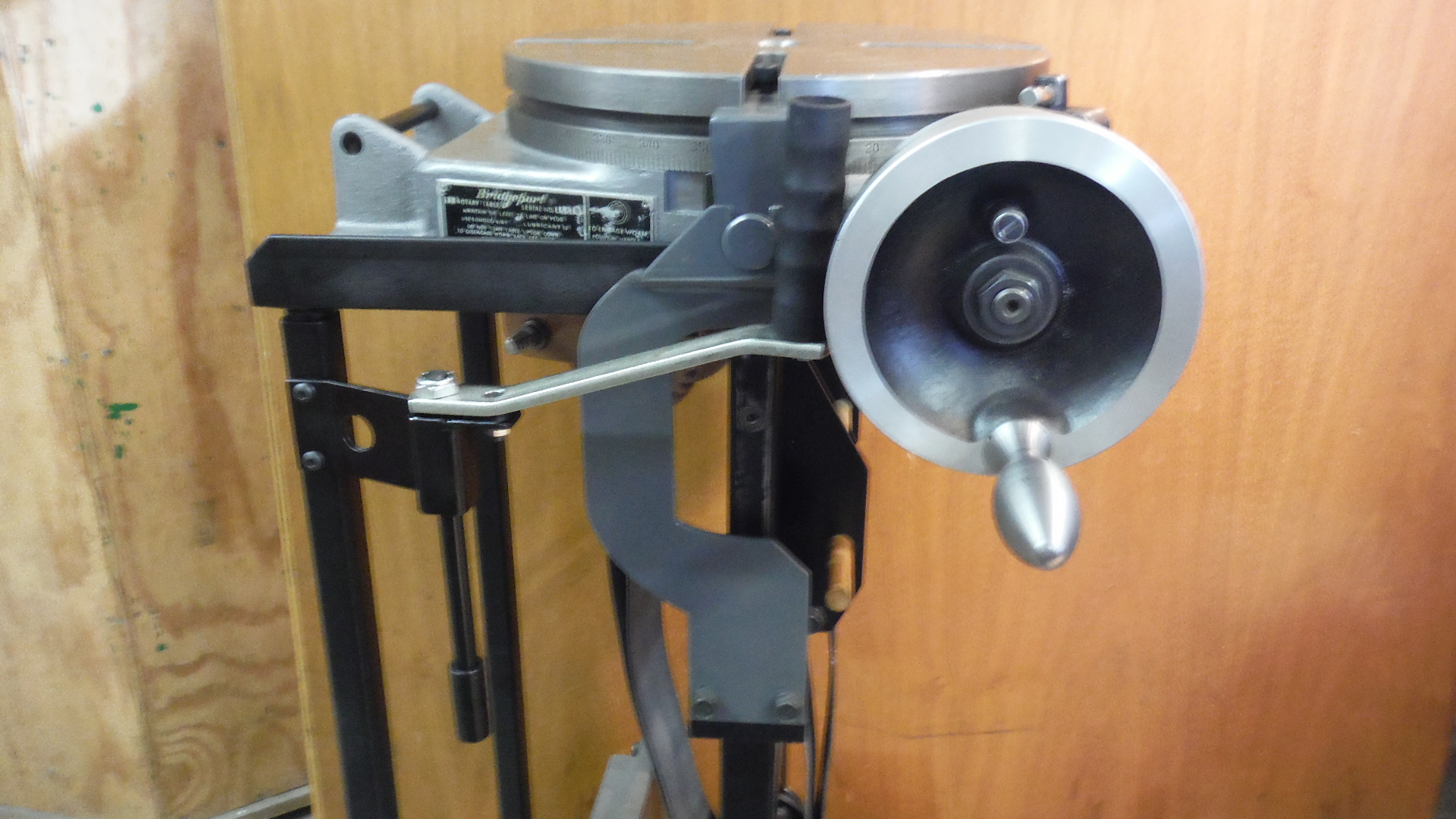

Came up with this stand/cart to store the RT horizontally, but through the use of a small hand winch, the RT could be raised and tilted 90º up so that the right-angle mounting bracket could be slid under and attached to it.
The stand is on 4 casters; 2 fixed at the end nearest the mill table and 2 swivel opposite. To move the RT onto the mill table, the table is lowered until the height is about the same as where the RT is on the stand. As a safety precaution, there is a wooden dowel that is inserted to lock the left mill feed handwheel to the stand so as to keep the stand from moving away from the mill.
The stand with BP RT in horizontal position. Crank for winch is stowed in a bracket that also supports the crank rod when in use.
The winch is just visible under the top framework of the stand. It sits at 20º off the y-axis

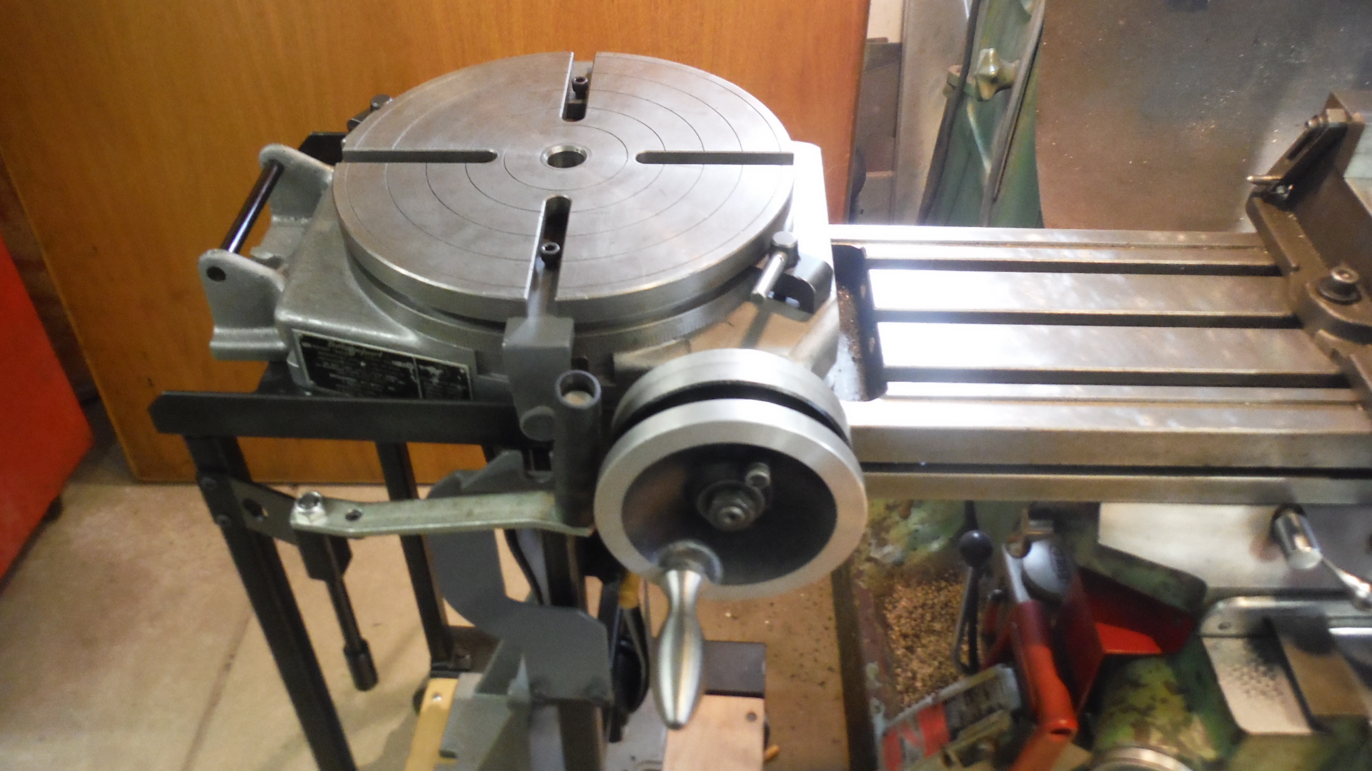

Stand is moved so that RT can slide onto mill table, which has been lowered into position.
Right below the handle of the handwheel (and barely visible) is the wooden dowel that locks the left-hand mill feed

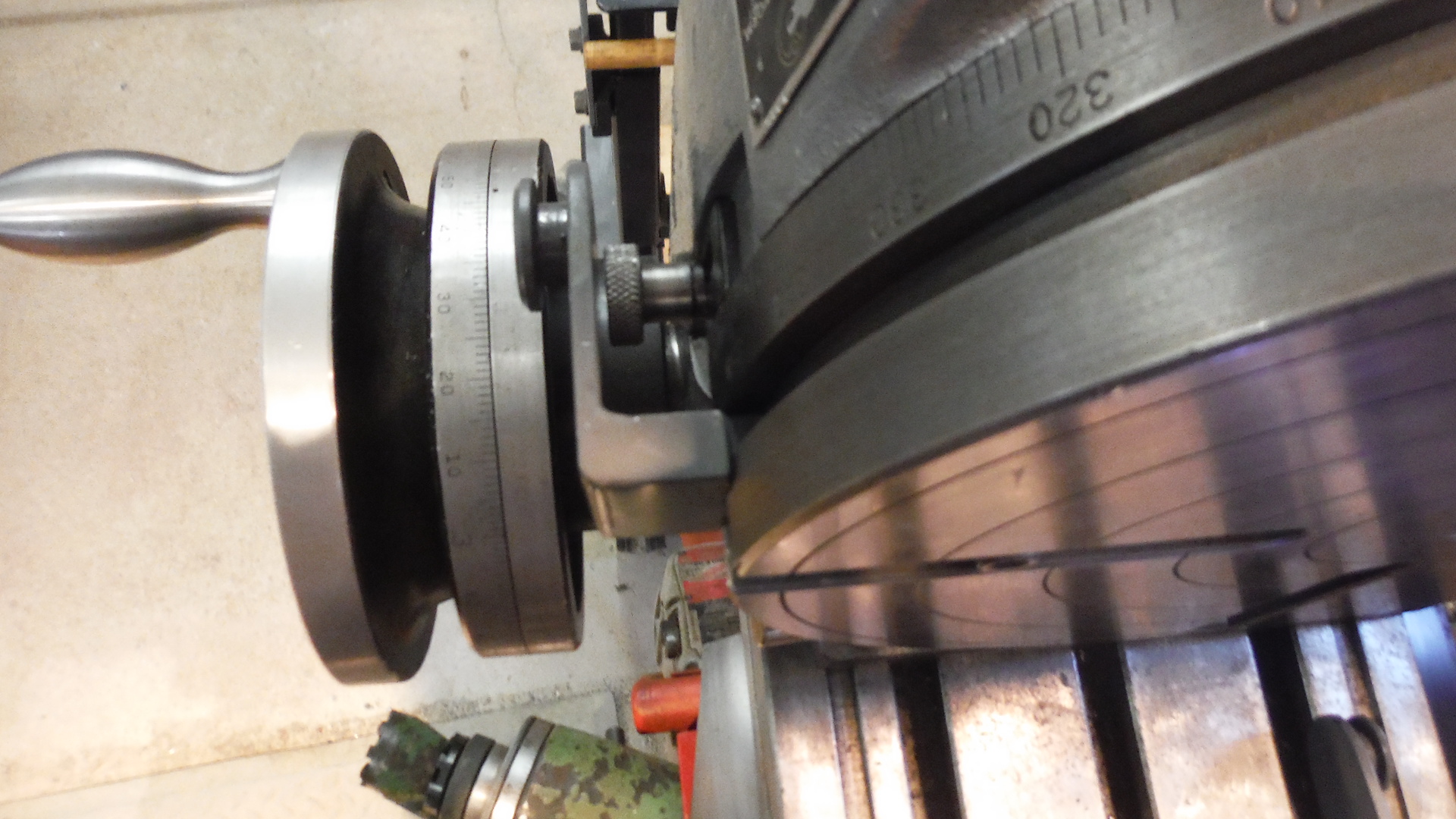

Here the offset pin bracket for the RT handwheel side is shown. I wanted to make sure the degree pointer didn't have to be removed.
The other pin bracket is similar but did not have an offset.
Attachment 38978

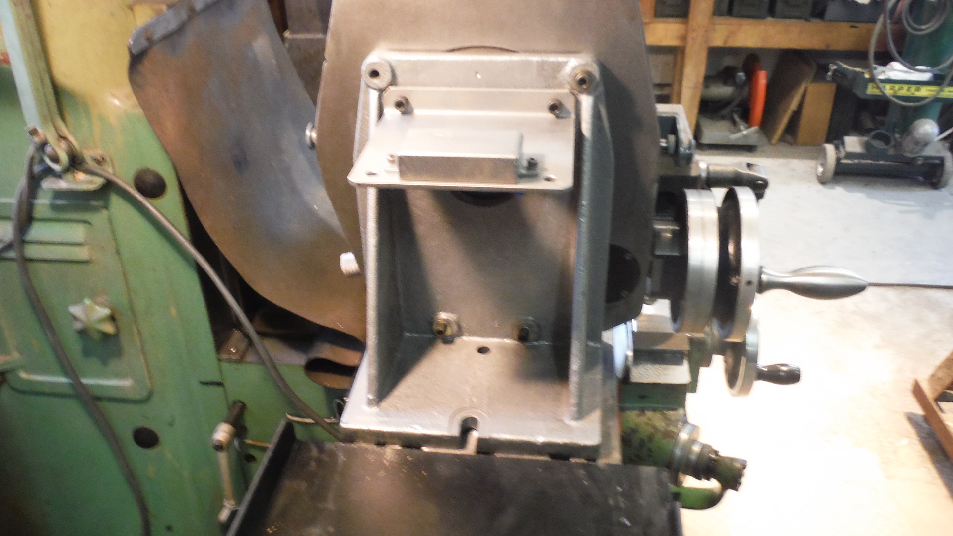

Right-angle bracket is loosely bolted to the RT in 4) places using 5/16-18 SHCS

On the open side of the right-angle mounting bracket I bolted on another bracket that serves two purposes.

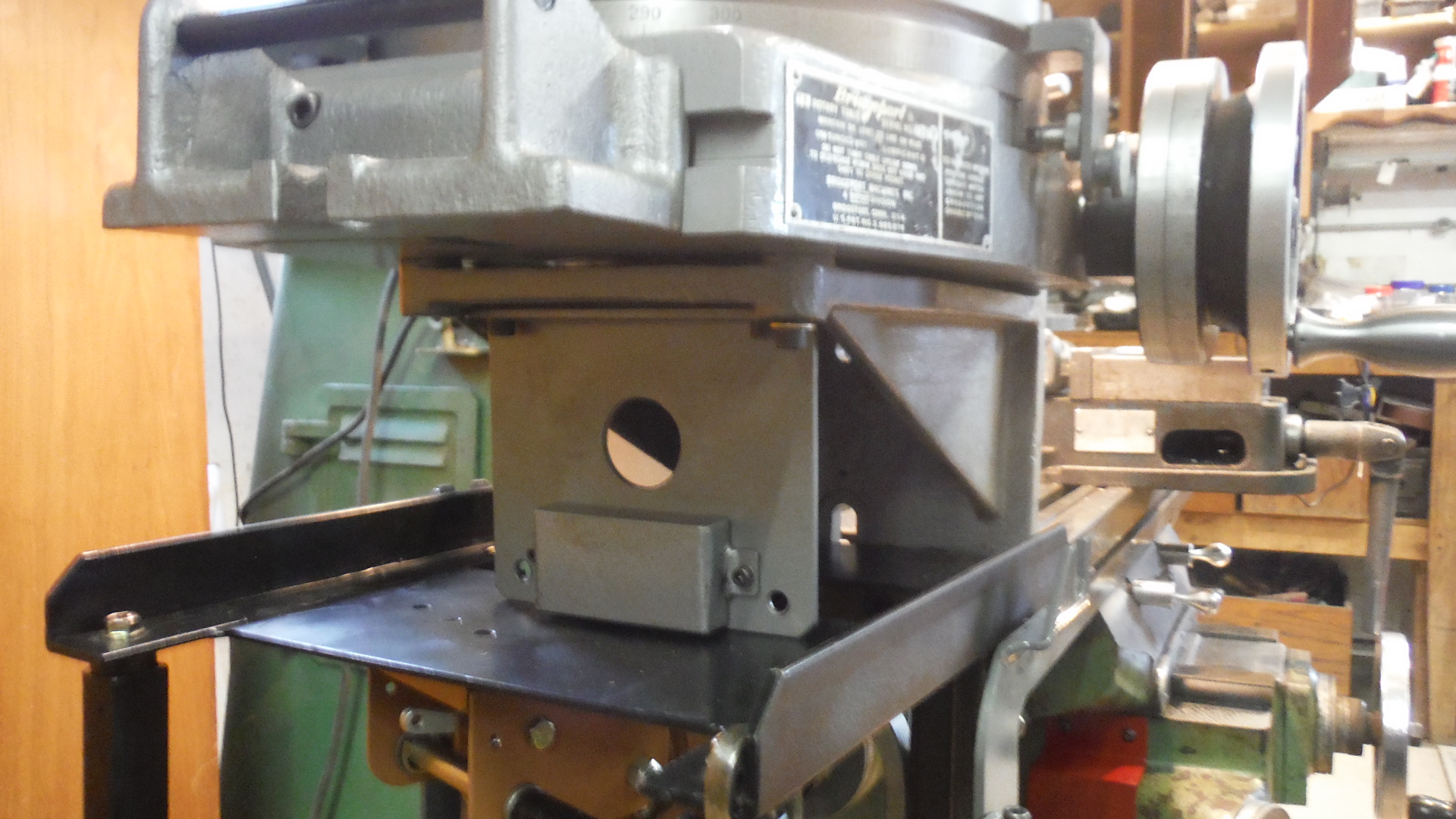

1) It is used to keep the whole assembly level when accessing the two 3/8-16 SHCS at the bottom....

Clear access to the 3/8-16 SHCS

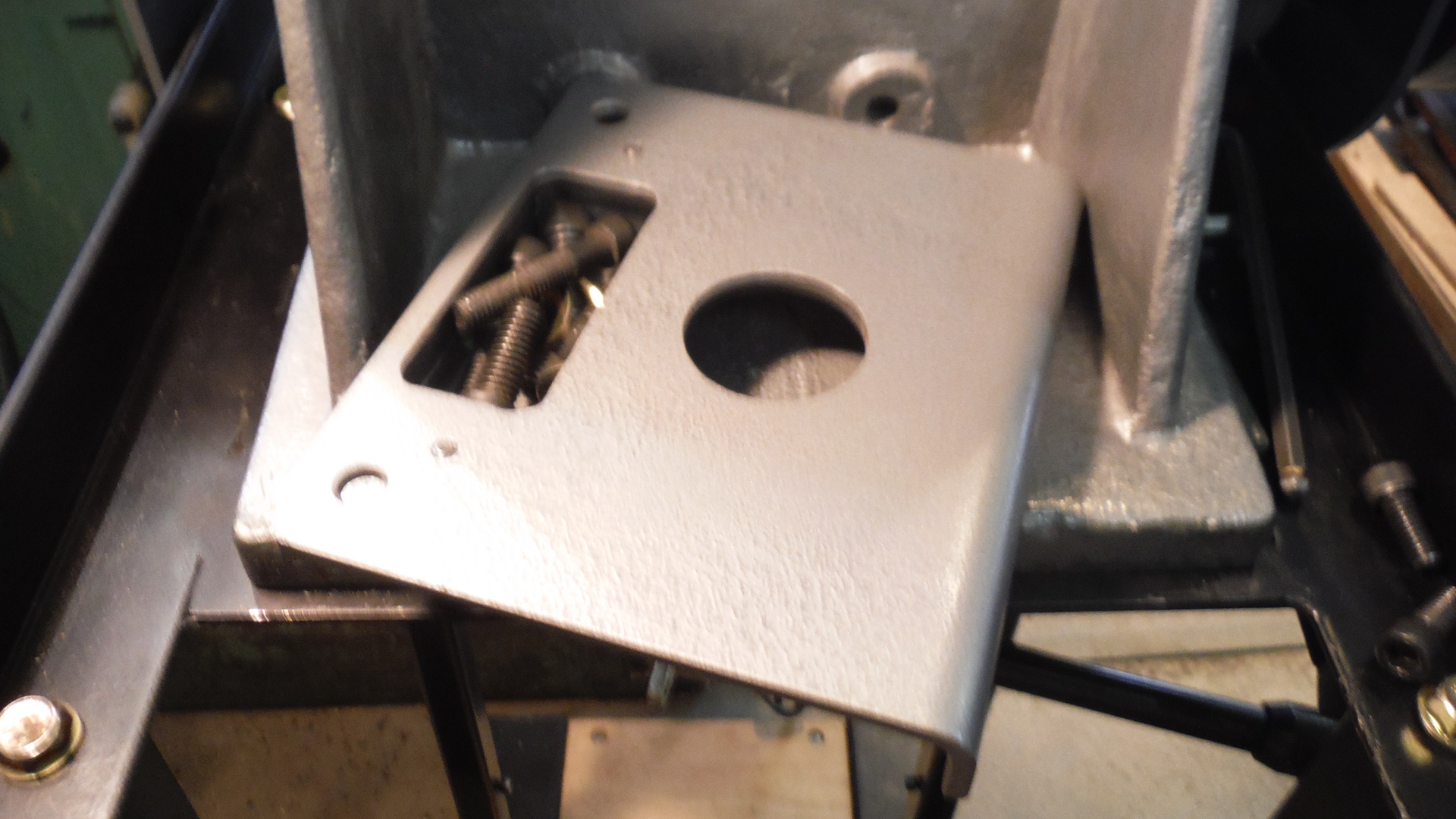

2) It has a small box to store the fastening cap screws.

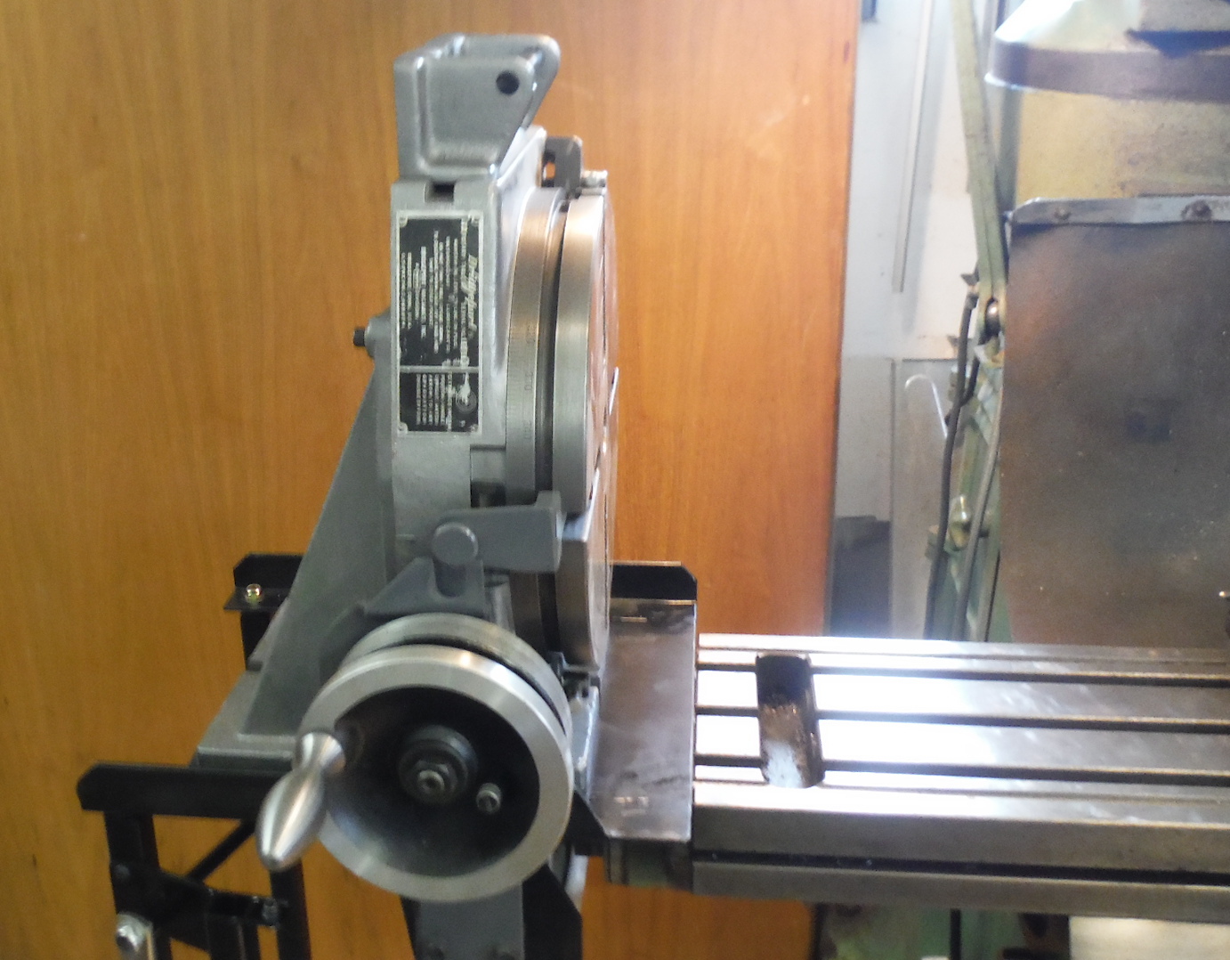

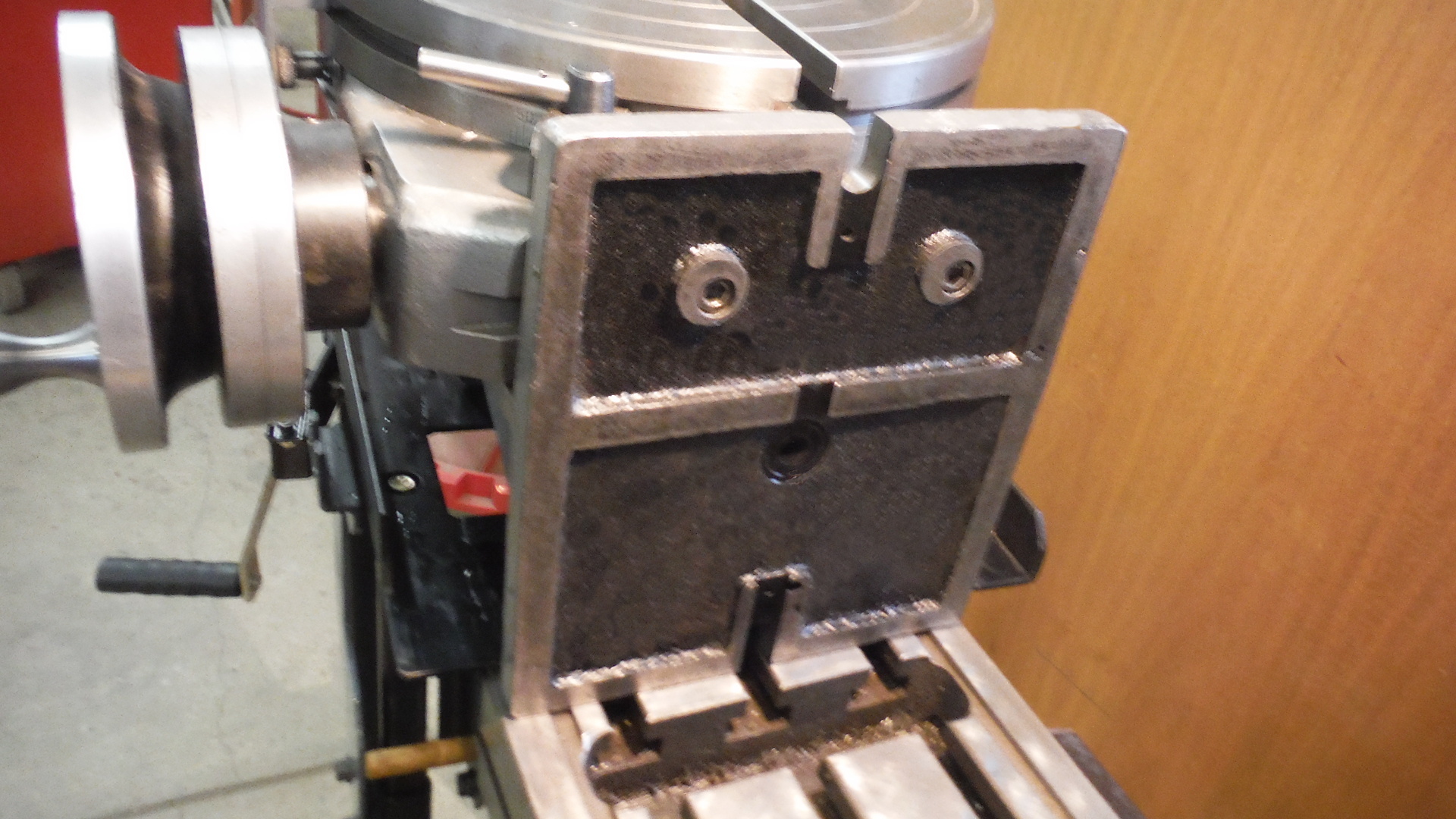

RT in vertical position ready to slide onto mill table
Attachment 38983

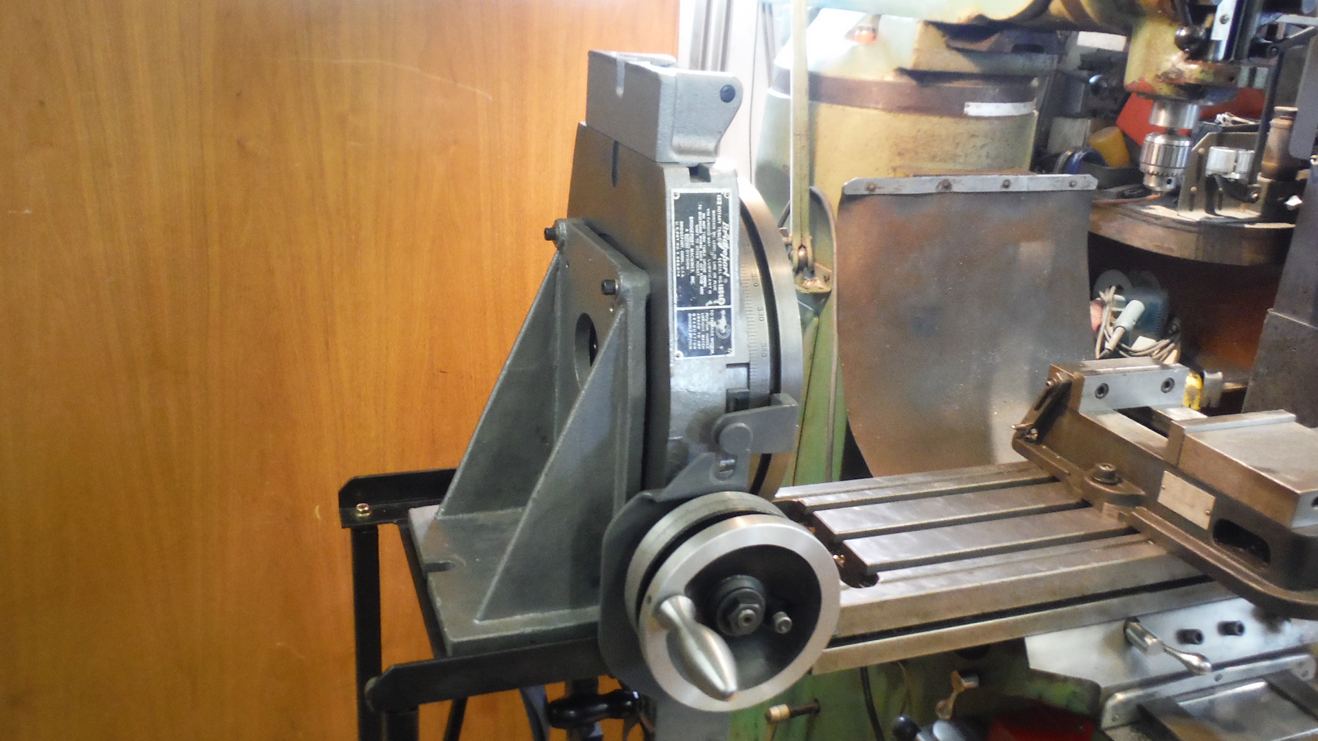

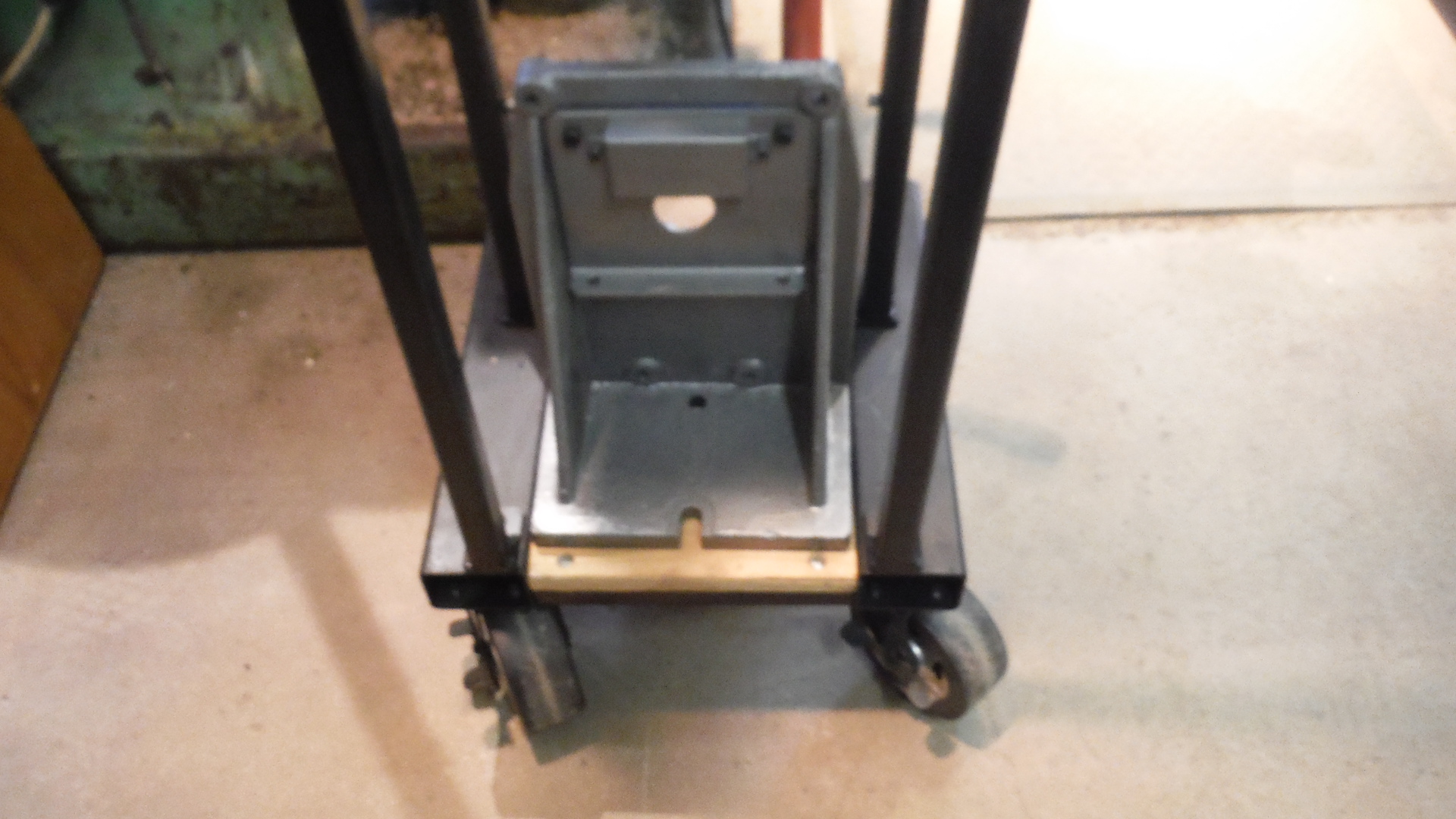

Right-angle mounting bracket is stored on the bottom shelf of the stand when not in use.
Attachment 38984
