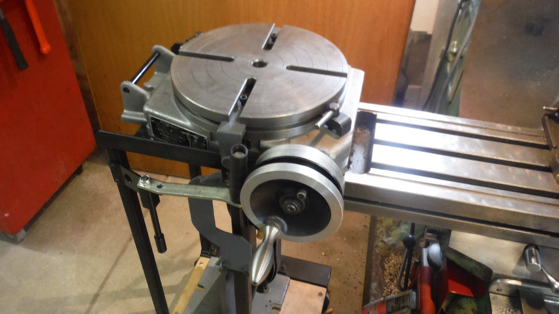

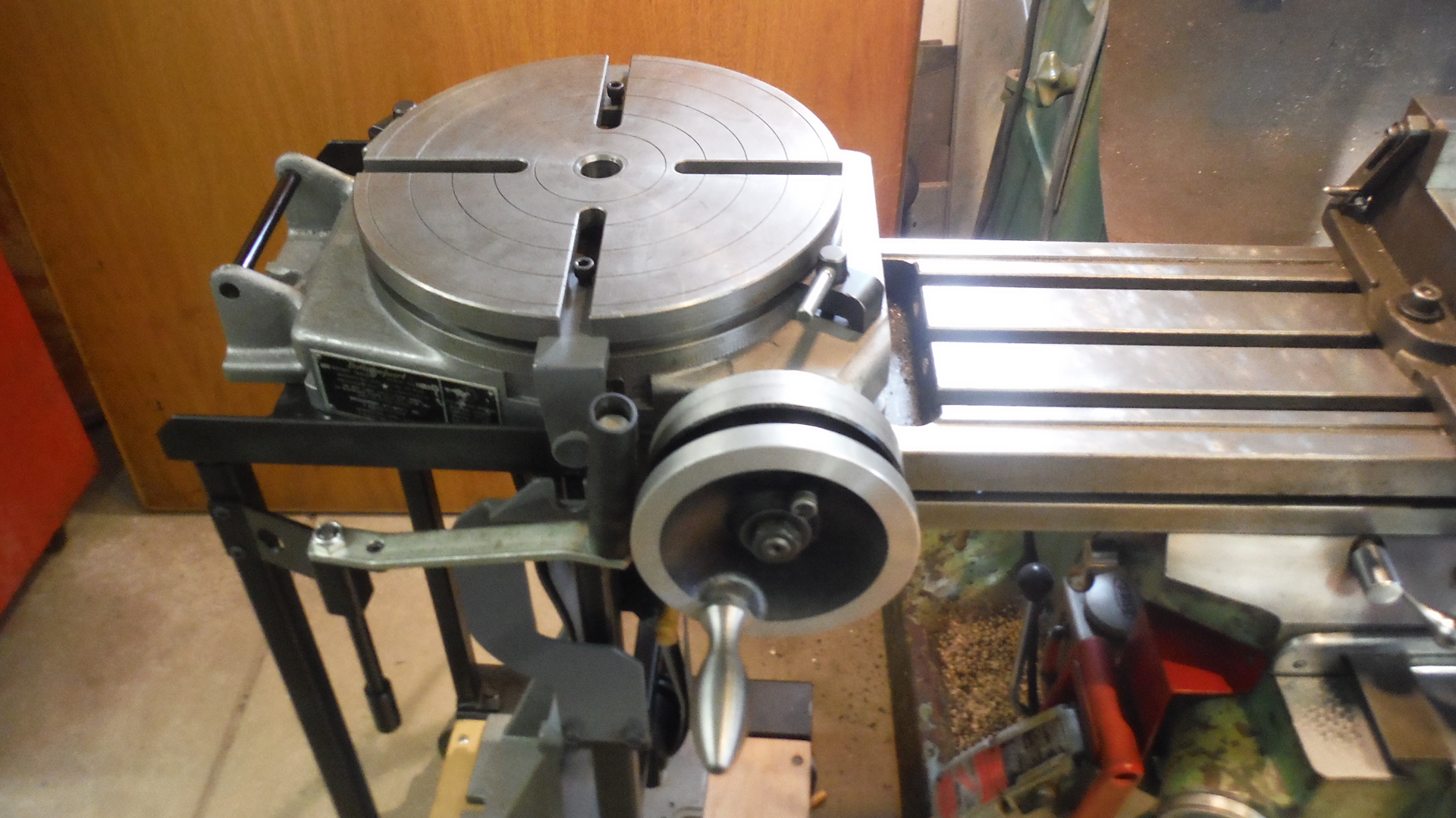

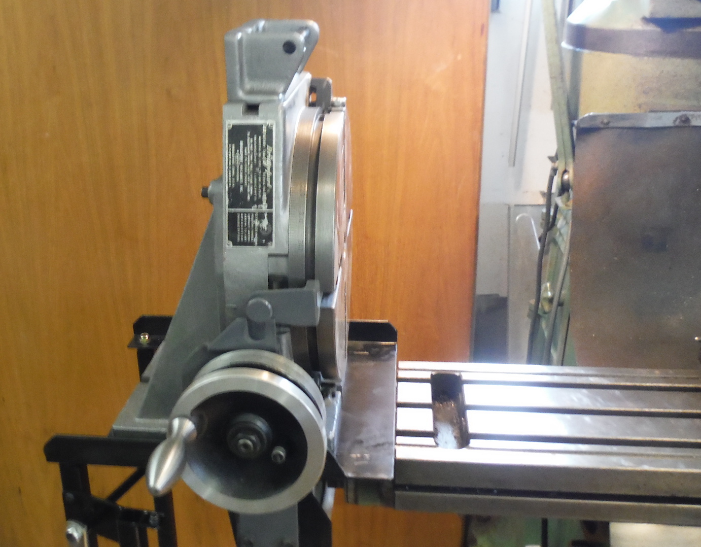

    Stand is moved so that RT can slide onto mill table, which has been lowered into position.
    Right below the handle of the handwheel (and barely visible) is the wooden dowel that locks the left-hand mill feed
Name:	RT Stand_3.JPG

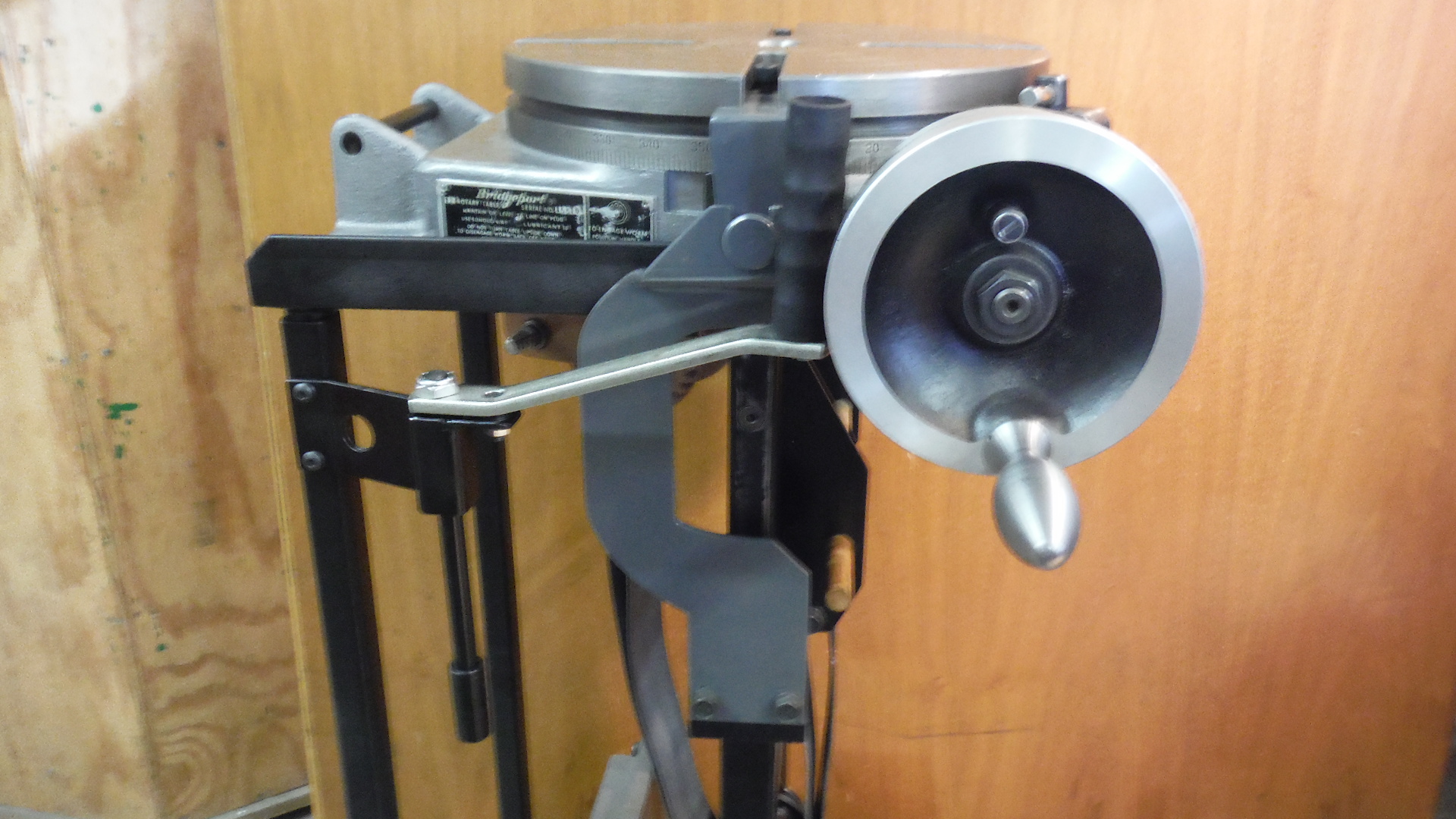

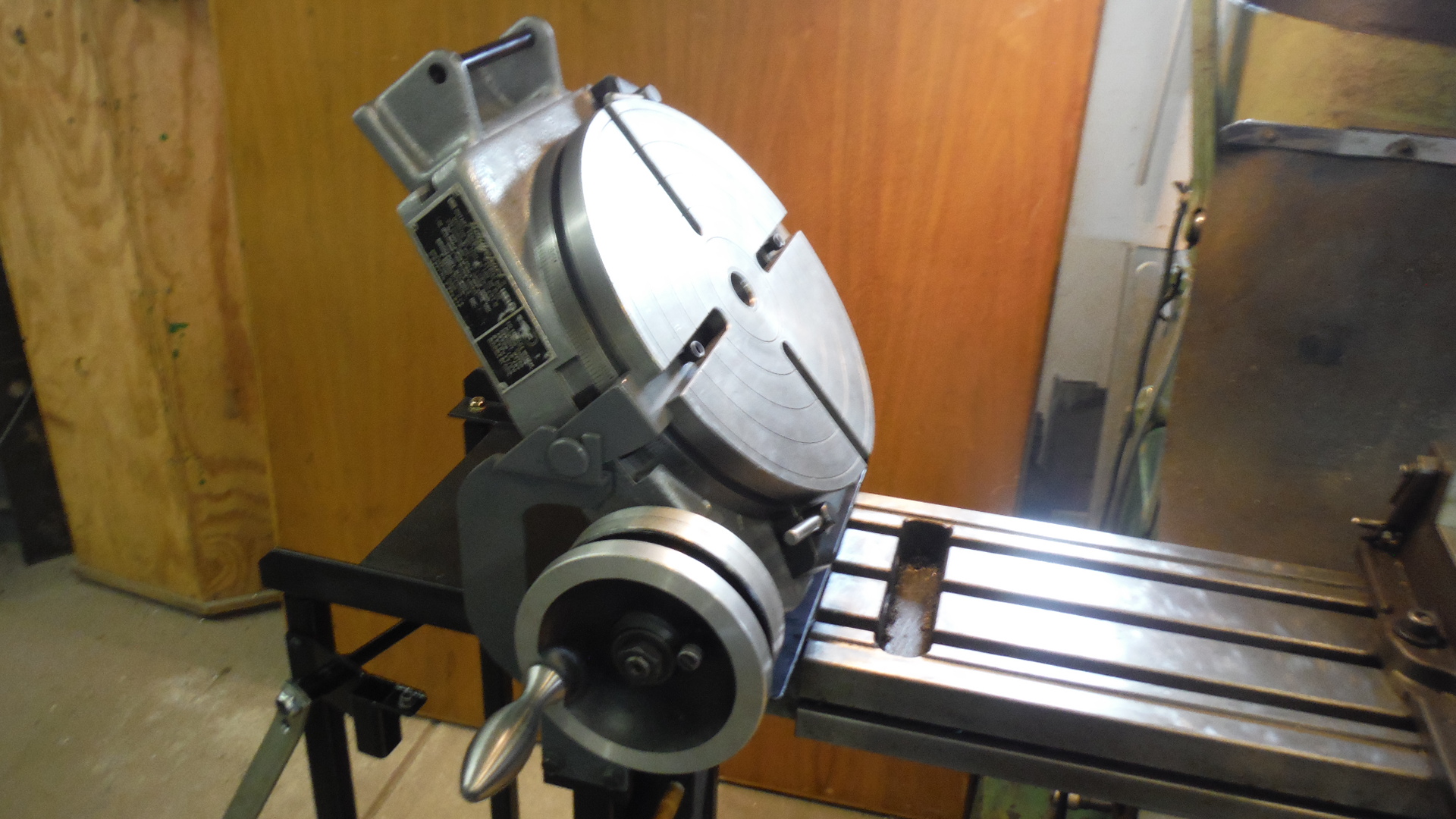

    Here, the winch is pulling up on the 2 sliding vertical brackets that engage the 2) pin brackets that have been inserted into the top slots of the RT
    This shows the RT in the transition from horizontal to vertical. The pin brackets allow the RT to swivel freely.
    Fortunately, the guess of center-of-gravity was very close..... no tendency to tilt one way or the other.
Name:	RT Stand_6.JPG

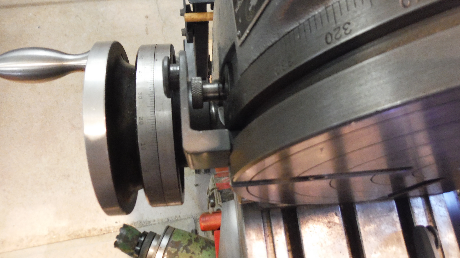

    Here the offset pin bracket for the RT handwheel side is shown. I wanted to make sure the degree pointer didn't have to be removed.
    The other pin bracket is similar but did not have an offset.
Name:	RT Stand_5.JPG

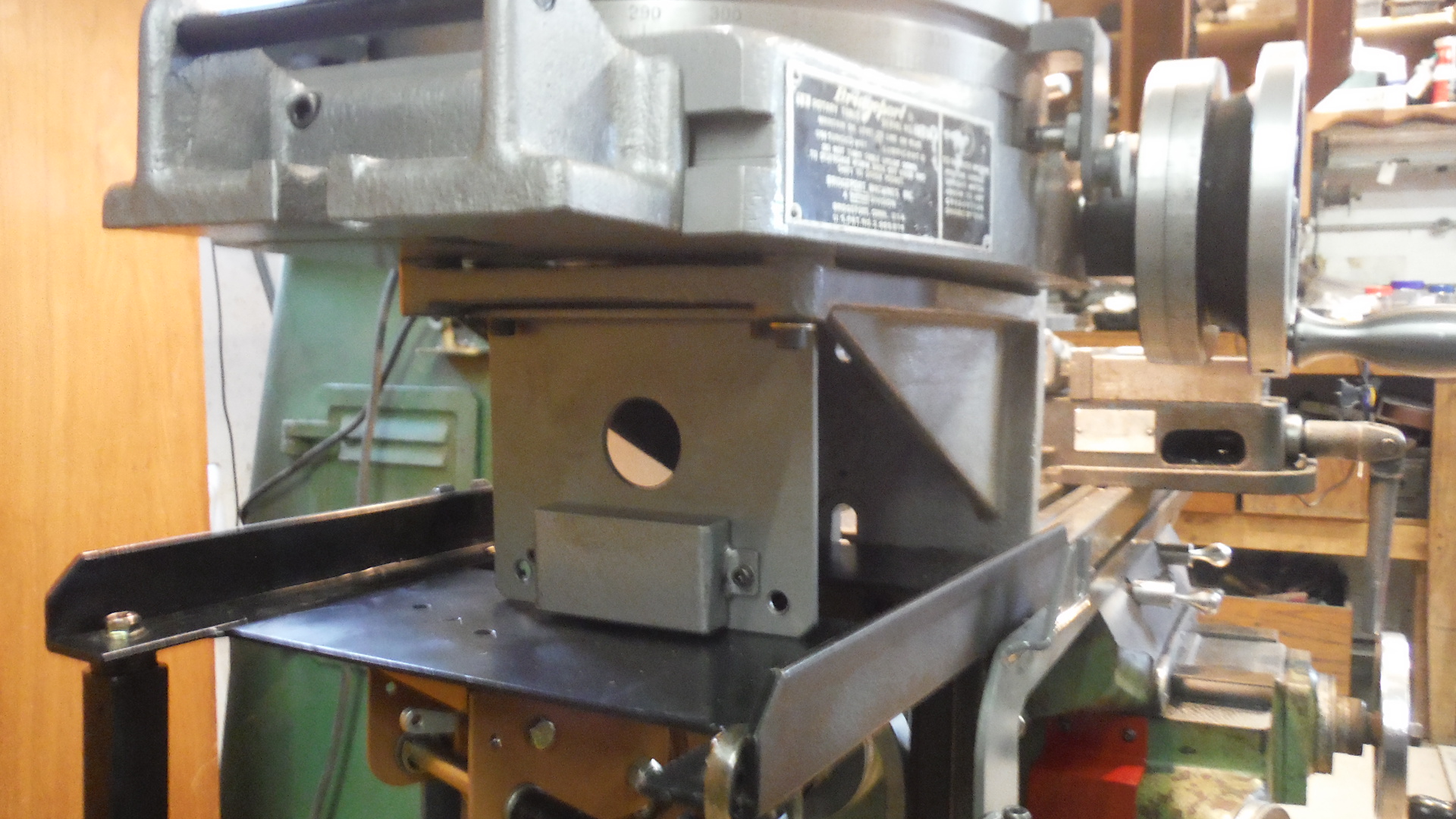

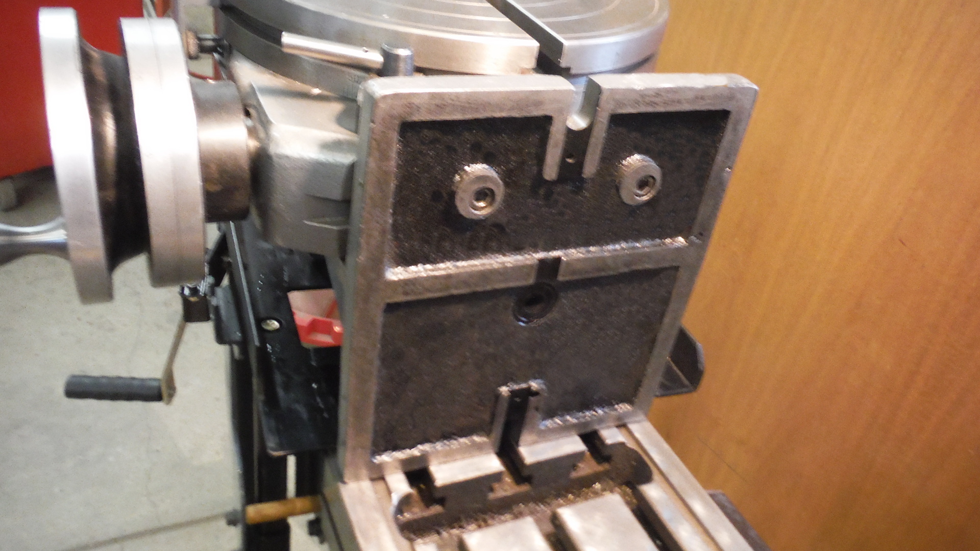

    Right-angle bracket is loosely bolted to the RT in 4) places using 5/16-18 SHCS
Name:	RT Stand_90.JPG

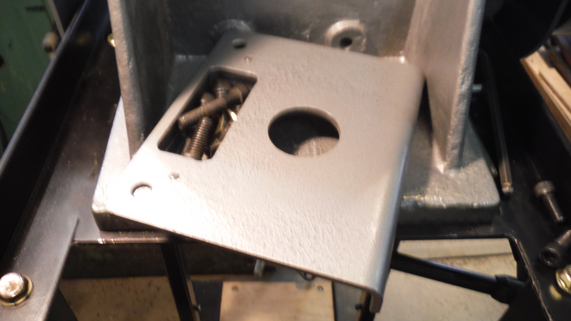

    On the open side of the right-angle mounting bracket I bolted on another bracket that serves two purposes.
Name:	RT Stand_8.JPG

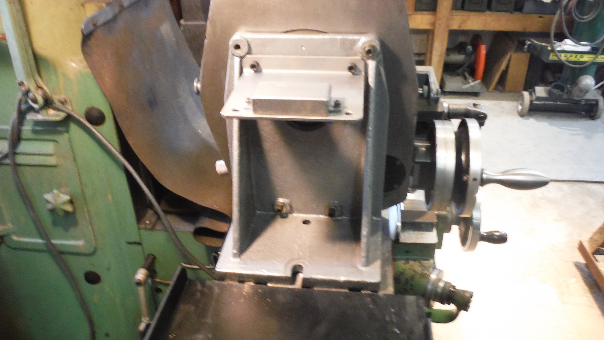

    1) It is used to keep the whole assembly level when accessing the two 3/8-16 SHCS at the bottom....
Name:	RT Stand_9.JPG
    Clear access to the 3/8-16 SHCS
Name:	RT Stand_10.JPG

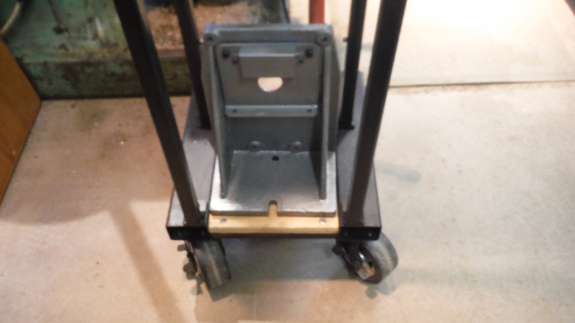

    2) It has a small box to store the fastening cap screws.
Name:	RT Stand_7.JPG
    RT in vertical position ready to slide onto mill table
Name:	RT Stand_11.JPG
    Right-angle mounting bracket is stored on the bottom shelf of the stand when not in use.
Name:	RT Stand_12.JPG
