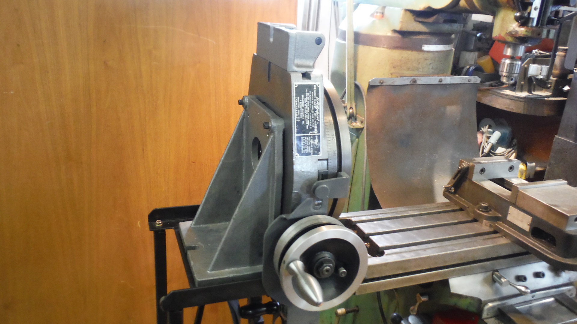

    The thing about 12" BP RTs is that they weren't designed to be mounted vertical without a right-angle mounting bracket of some sort, unlike a Troyke. Fortunately, a bracket was purchased soon after getting the RT in '86 just for that purpose. Horizontal or "normal" isn't a problem; you just need two of the mounting ears that typically come with it.
    SO,..... How to store the RT when not in use and make it easy to mount/dismount? Thought about making a jointed arm affixed to the mill column that would allow swinging the RT out of the way. Did some checking and measuring; it would need quite a bit of room just to clear the mill column and mill bed.
    But, the biggest concern was how to readily convert the RT from Horizontal to Vertical or vice versa.
    Came up with this stand/cart to store the RT horizontally, but through the use of a small hand winch, the RT could be raised and tilted 90º up so that the right-angle mounting bracket could be slid under and attached to it.
    The stand is on 4 casters; 2 fixed at the end nearest the mill table and 2 swivel opposite. To move the RT onto the mill table, the table is lowered until the height is about the same as where the RT is on the stand. As a safety precaution, there is a wooden dowel that is inserted to lock the left mill feed handwheel to the stand so as to keep the stand from moving away from the mill.

    RT in vertical position ready to slide onto mill table
Name:	RT Stand_11.JPG
