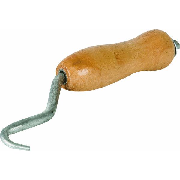

    Except for looks I am partial to rebar tie wire and a dummy stick
