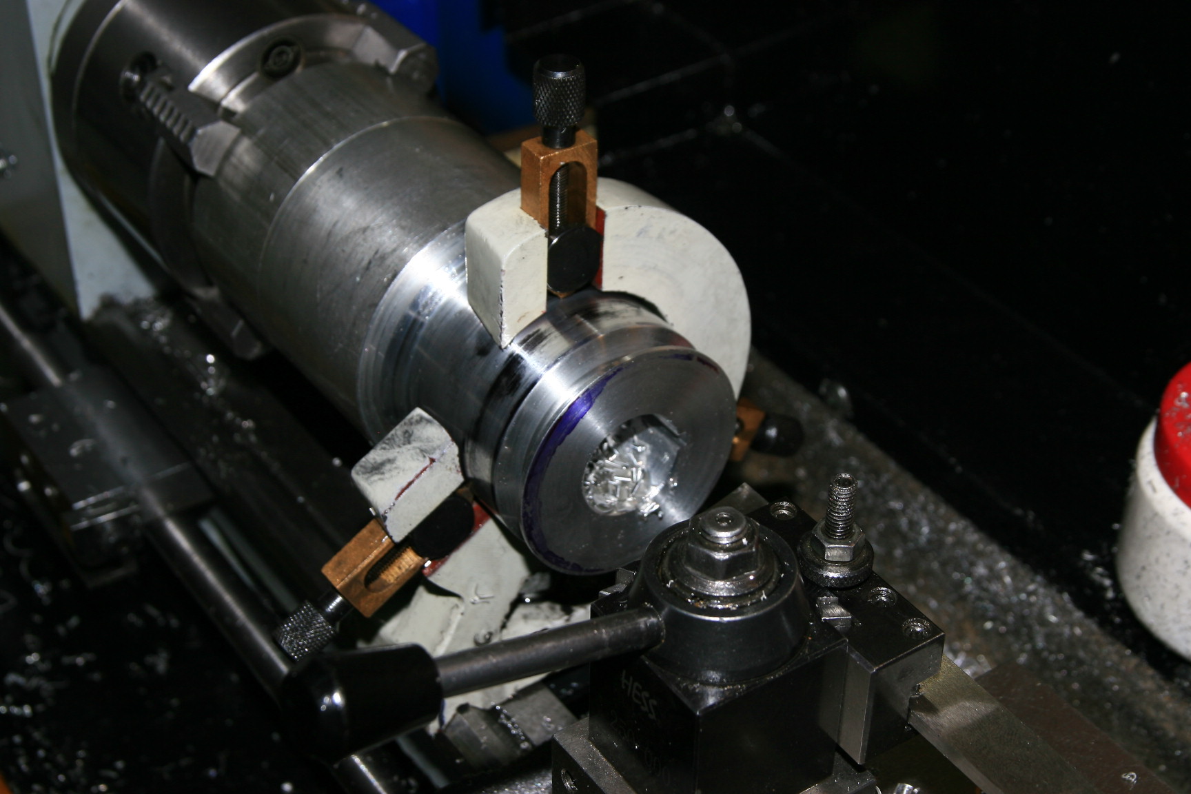

    Not a new idea but I thought I would post my latest use of a tool I did not have.
    The price of broaching sets is right up there to the point of tools I would like but
    have not purchased yet. Since my new pulley needed a keyway slot and it was
    made from aluminum I thought I would try the lathe method.

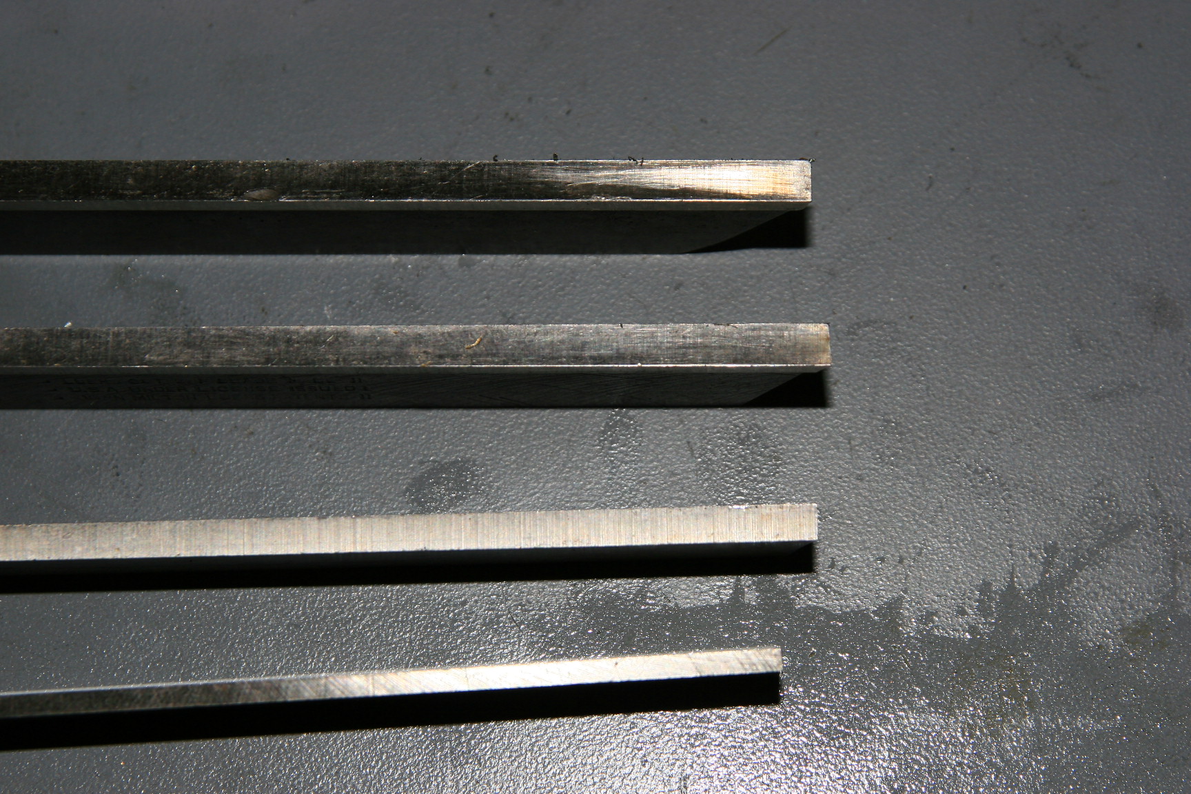

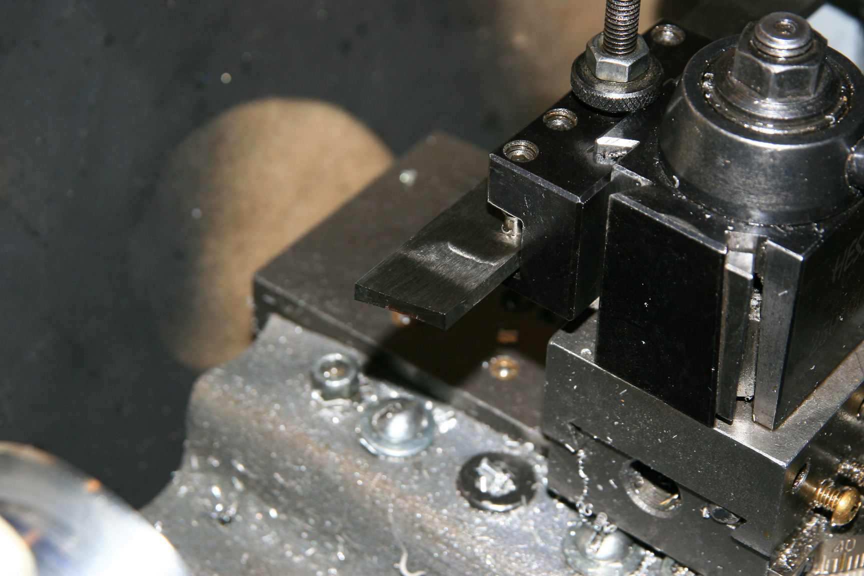

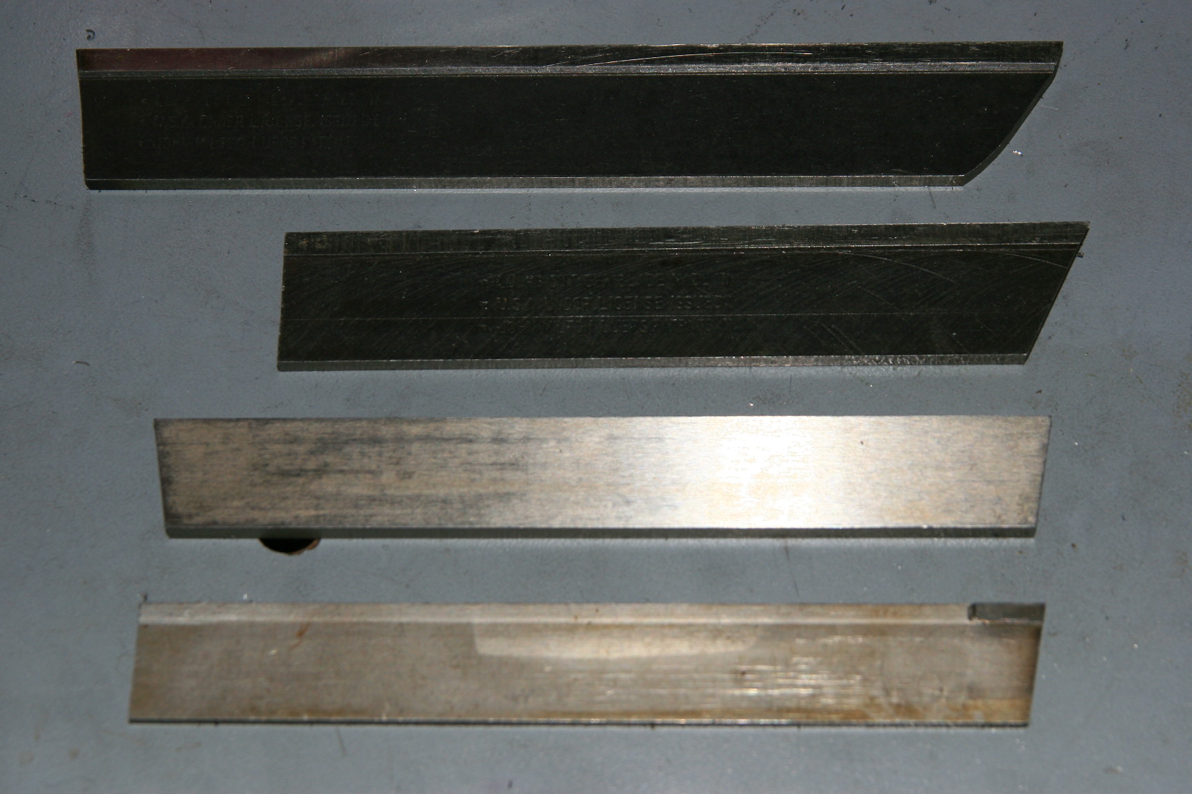

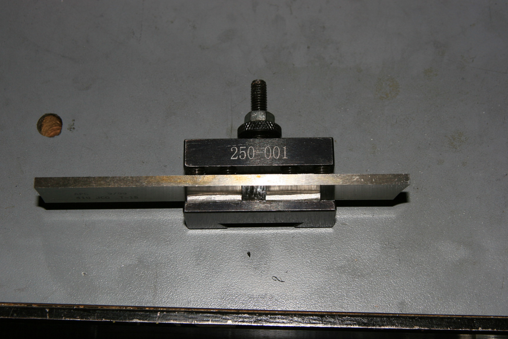

    On hand were a couple of cutoff tool bits that I don't use on my lathe since they
    are a bit on the large size for a mini lathe. So I mounted one HORIZONTALLY in a
    tool holder and went to work. The pully was still attached to the 3.5" chunk of
    aluminum round stock. I only took .001" on each pass to keep the pressure down.

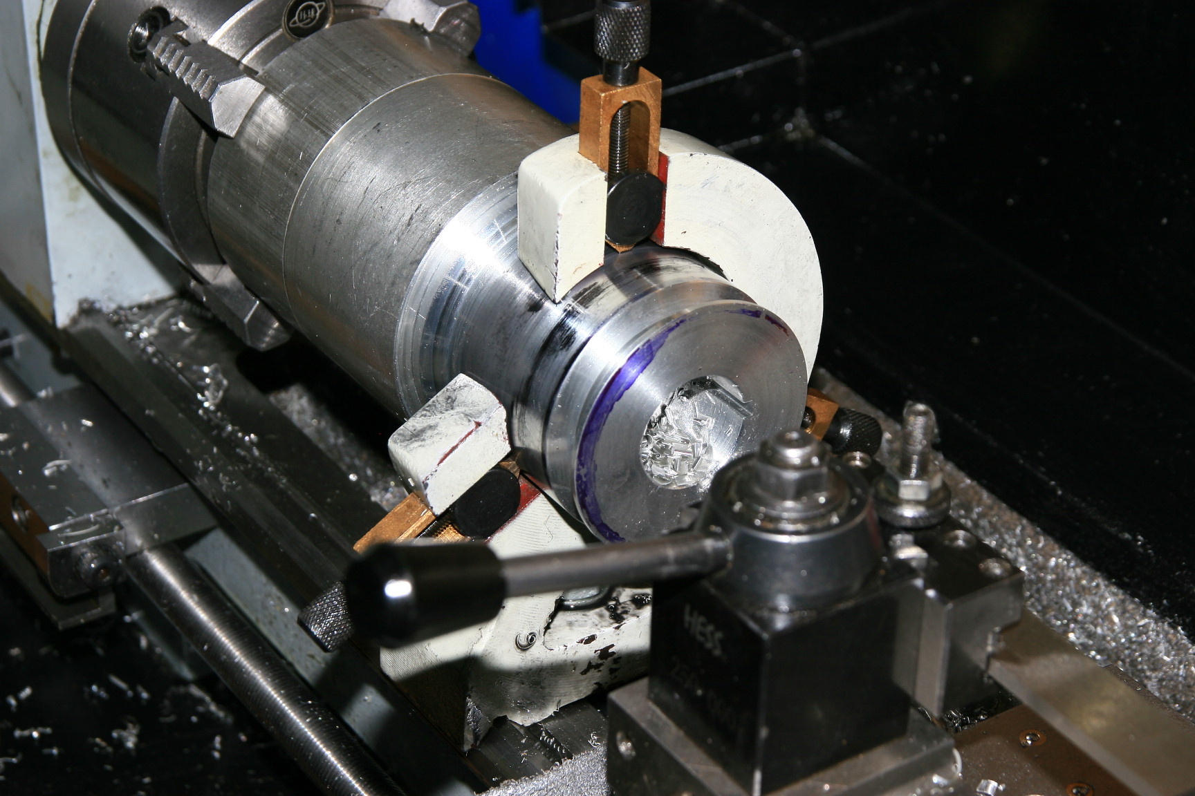

    After 30 minutes I had "broached" a 4mm keyway in my new pulley. Since I was
    broaching in a blind hole I added an extra step to move the cut curl inside the
    pulley after each cut. This doubles the time to complete but was necessary
    to get the "chip curls" out.
    One thing to note is the steady rest. It is being as a spindle lock in this picture to
    hold the pulley firm and not allow it to rotate. Don't forget to unlock it prior to
    running the lathe with power! No I did not do that, just thought I would mention it for safety reasons.
    This should work with steel but I would take a .0005" cut for the first attempt.
    Cheers, JR

    Great job jjr2001. Times call for broaching without standard means. Cutoff blades are made in enough width/ height sizes to render most keyways. I can't say whether flat or hollow ground type work better. I do think flat tapered blades are stiffer than T's, helpful when goal is depth. A cutoff tool normal edge will shear, but found a hook [per broach or bandsaw tooth ] break chips best. Easy with an abrasive cut off wheel.
    If possible, drill through part wall, perpendicular and just beyond end of keyway. When cutting blind, the relief lessens crowding.

    Thanks for the tips Toolmaker51. Next time I think I will grind a hook on the cutoff blade.
