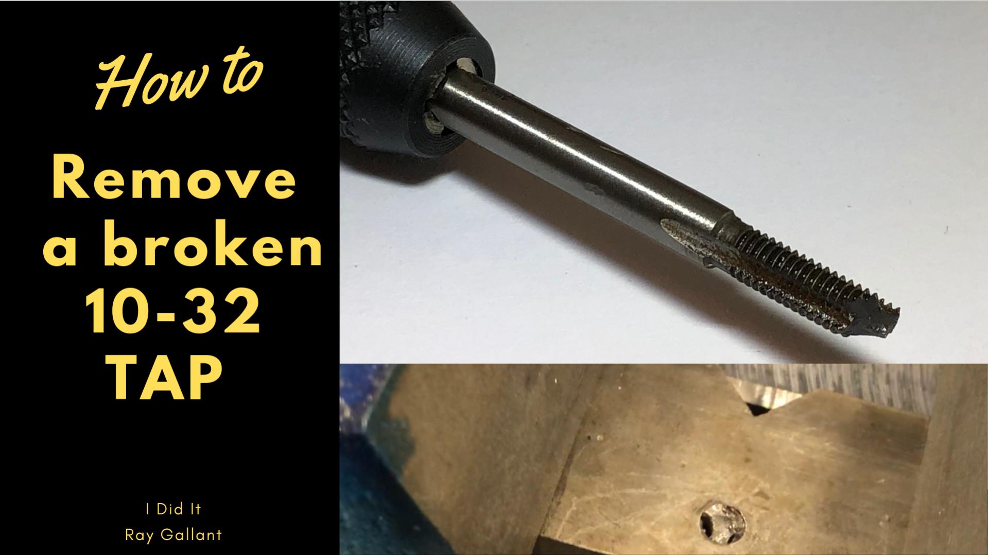

    Hi
    Thank you for inviting me into the form ( i am new first time post)
    I like to contribute just not take
    I am attaching a video i made trying to restore a small hand vice
    2 mistakes first in a rush i cross thread a hole second mistake used a cheep tap to to clean the hole then snap
    broken 10-32 tap

    I'm assuming that was a carbon steel tap, right?

    Hi Doug
    I tried to reply to you earlier but it did not go threw
    The tap was a 10-32 HSS
    The drill was a 1/8 masonry bit (did not work because it has a negative rake angle)

    Reason I was asking about it being a carbon steel tap was I never broken a tap that small nor have I ever had to to drill or mill out a tap in all my 45 years of machining, not saying I never broke a tap, I've always been lucky enough where the tap protruded enough to grab it with something and worry it out.

    The braking of the tap was 100% my fault
    I was in a rush to finish up the video and testing out a go-pro
    I should have stopped an hour earlier but i was so close to finishing
    going fast only took 100 times longer
    Ray

    I used to work with a friend and we tapped hundreds of 6-40 thread blind holes in customers firearms. My friend would break a tap off at surface height or below about a half-dozen times a year. Fortunately, my wife has family members than have an EDM shop. I would just hand it off to them and they would burn the broken tap out.
