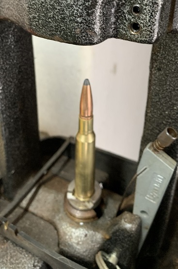

    Yes I know, I should have bought a kinetic bullet puller a long time ago, but to be quite frank I only ever needed one once before in my 40 years of hunting and that was because I got a whole lot of mixed bullets from a friend of a friend of a friend, so basically only wanted the brass and for that I borrowed the friends kinetic puller.
    So during the LockDown I decided to reload this season's bullets. All went well till wifie called me for breakfast, gone was my routine. when I got back I pushed a bullet into an empty shell Click image for larger version.

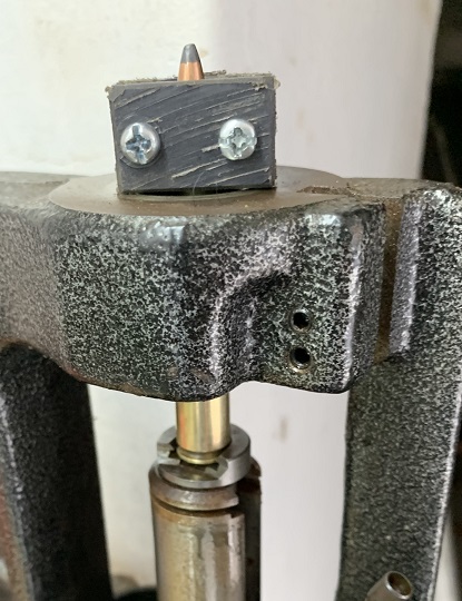

    So the bullet had to come out because I only have 20 x 162G bullets left and that is usually a season's shooting for me.
    So a quick search on the internet did not prove very helpful. The plans there was was definitely going to destroy the bullet or the brass if not both.

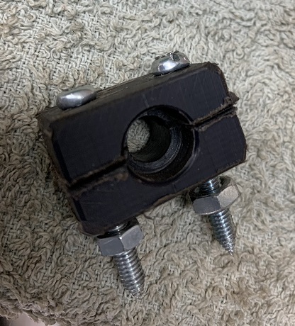

    Plan 1 - Small nylon block drilled to 7mm (had to mention this earlier, Caliber is 7 x 57) and then split in half with a small metal saw and then 2 x 5mm scrws with nuts and washers to clamp the whole lot together.
    Then push the press up and hook the shell holder to the case and gently pull down.

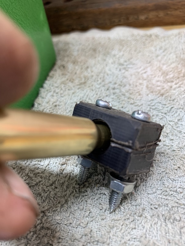

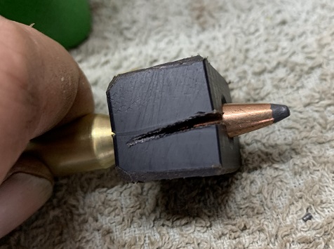

ID:	34491 and it does not work...Click image for larger version.

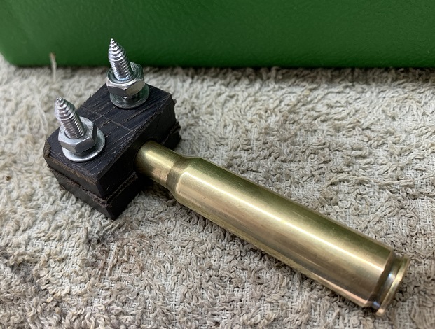

    But I am not one for giving up, Drill out the one side so the brass can go into the nylon block and the clamping force of the bolts can be more in line with the full diameter of the bullet.
ID:	34493 Click image for larger version.
ID:	34494 and again it slips out.

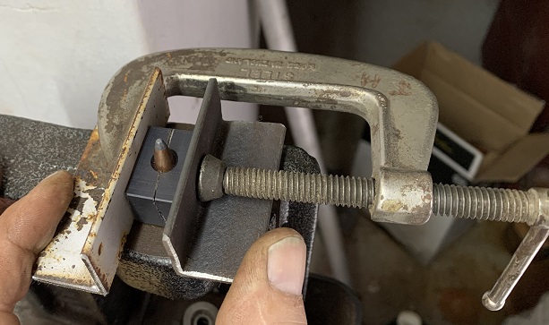

    Second nylon block...6.5mm hole, recess to allow brass into block, Do not cut all the way through, leave the clearance part for the brass in tact.

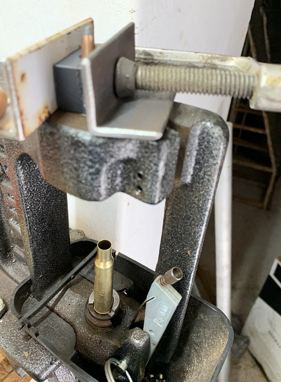

ID:	34495 then add 2 pieces of 25 x 25 x 3 angle iron and with 4 hands clamp the whole lot together.

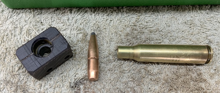

ID:	34496 and this time it works Click image for larger version.

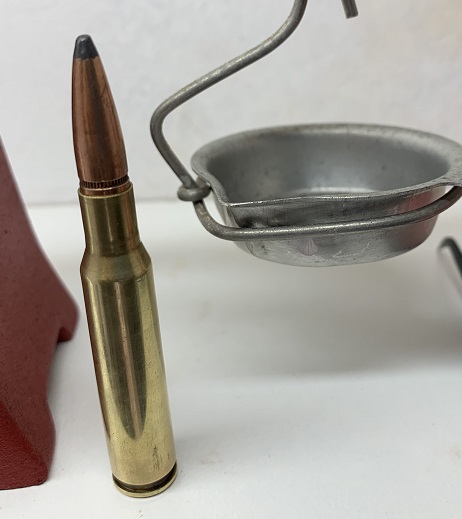

ID:	34498 Mic'ed up the bullet in 4 planes and no distortion after the clamping, ready to be used again, brass is perfect.
