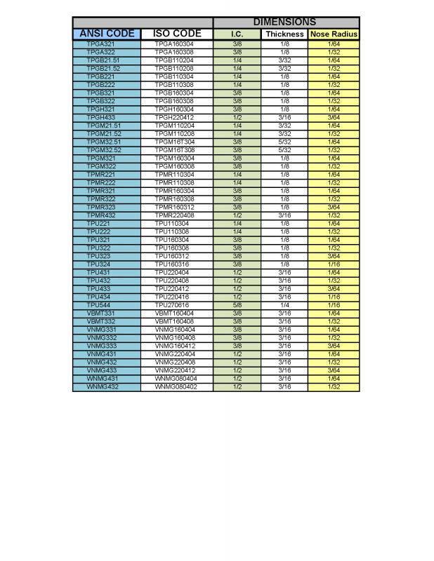

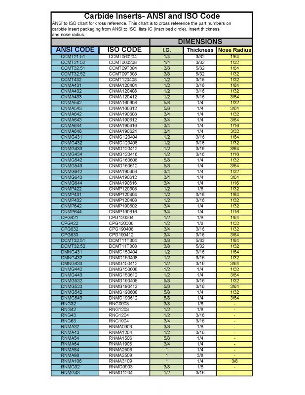

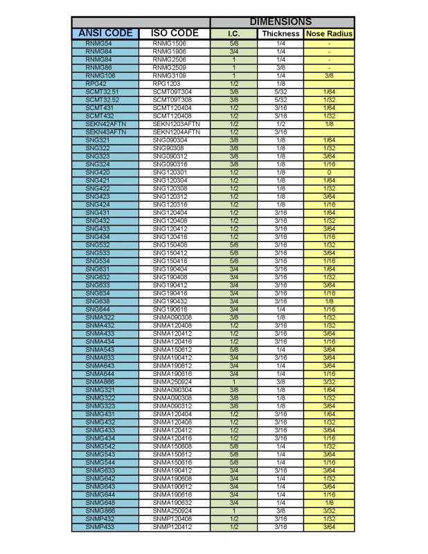

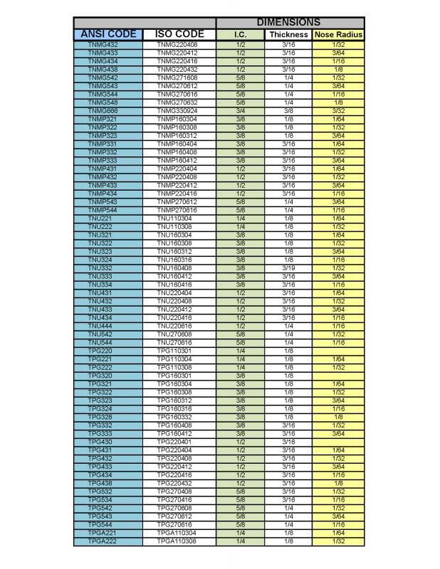

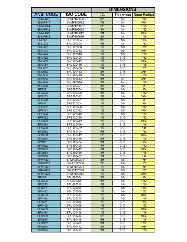

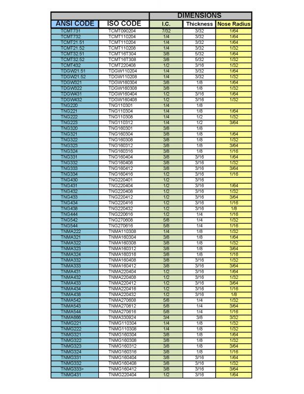

I've looked for a long time for some charts like this. ISO & ANSI insert designations can be confusing for me sometimes. After a long search I found these and thought they maybe useful to someone else too. A big thanks to qtstools.com which is where I found them.:hattip:
Attachment 20048Attachment 20049Attachment 20050Attachment 20051Attachment 20052Attachment 20053
