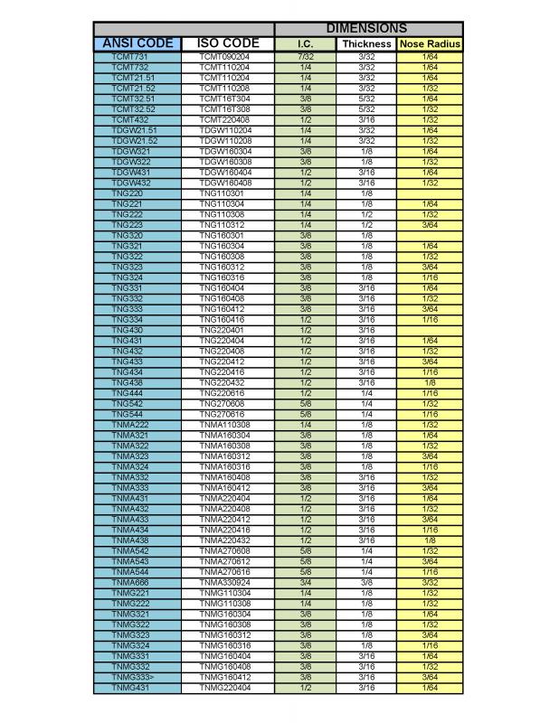

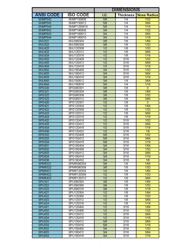

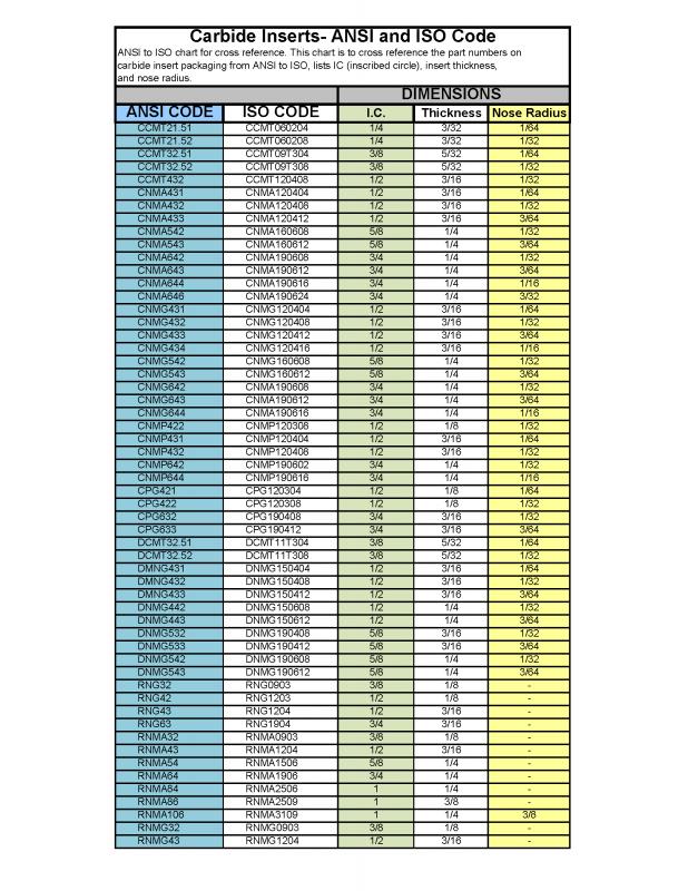

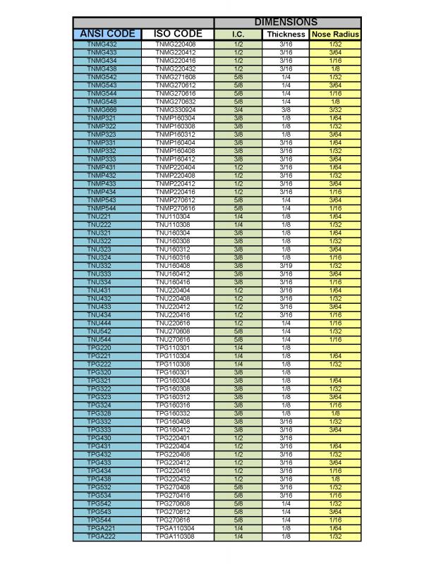

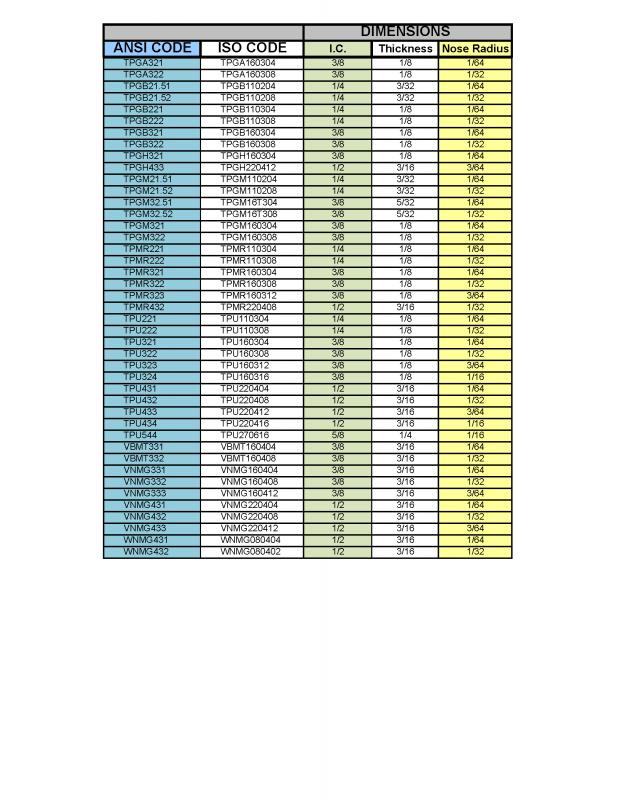

    Carbide Insert equivalent & comparison charts
    I've looked for a long time for some charts like this. ISO & ANSI insert designations can be confusing for me sometimes. After a long search I found these and thought they maybe useful to someone else too. A big thanks to qtstools.com which is where I found them.
    Carbide Insert equivalent & comparison charts-iso-ansi-insert-crossover1_page_1.jpgCarbide Insert equivalent & comparison charts-iso-ansi-insert-crossover1_page_2.jpgCarbide Insert equivalent & comparison charts-iso-ansi-insert-crossover1_page_3.jpgCarbide Insert equivalent & comparison charts-iso-ansi-insert-crossover1_page_4.jpgCarbide Insert equivalent & comparison charts-iso-ansi-insert-crossover1_page_5.jpgCarbide Insert equivalent & comparison charts-iso-ansi-insert-crossover1_page_6.jpg

    Thank you - most useful.

    Thanks for the site reference, there's a lot of great info available!

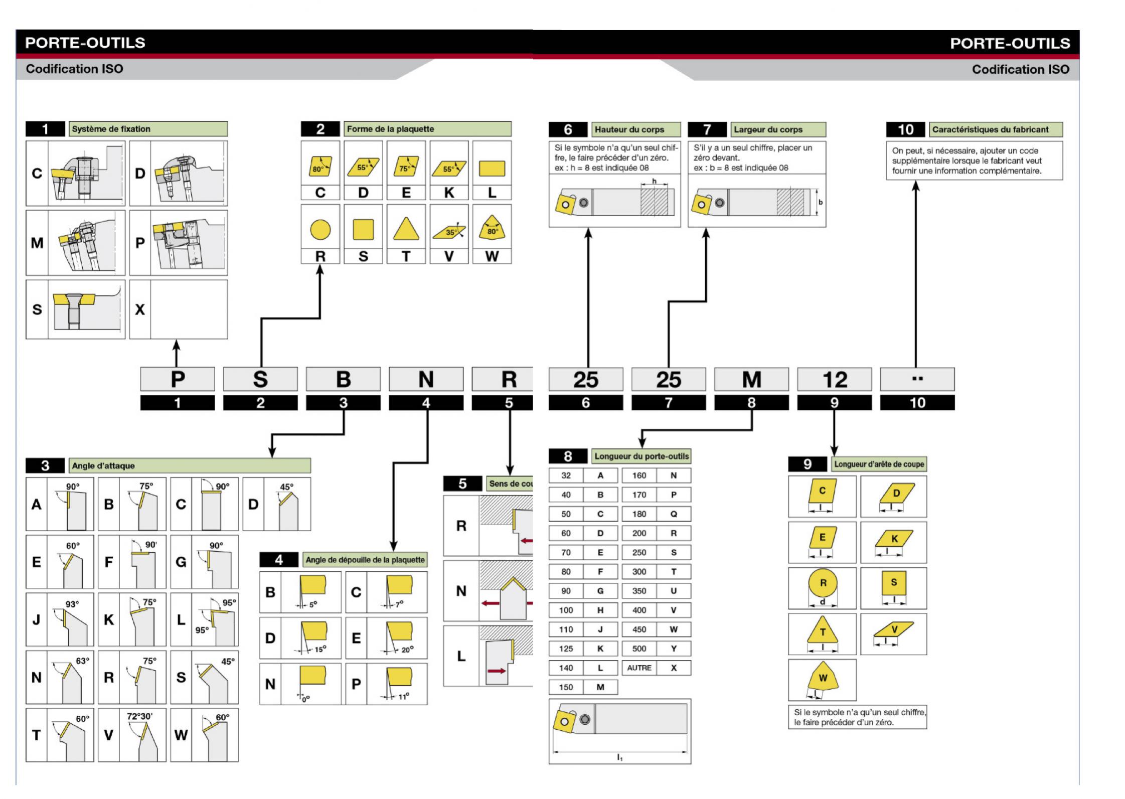

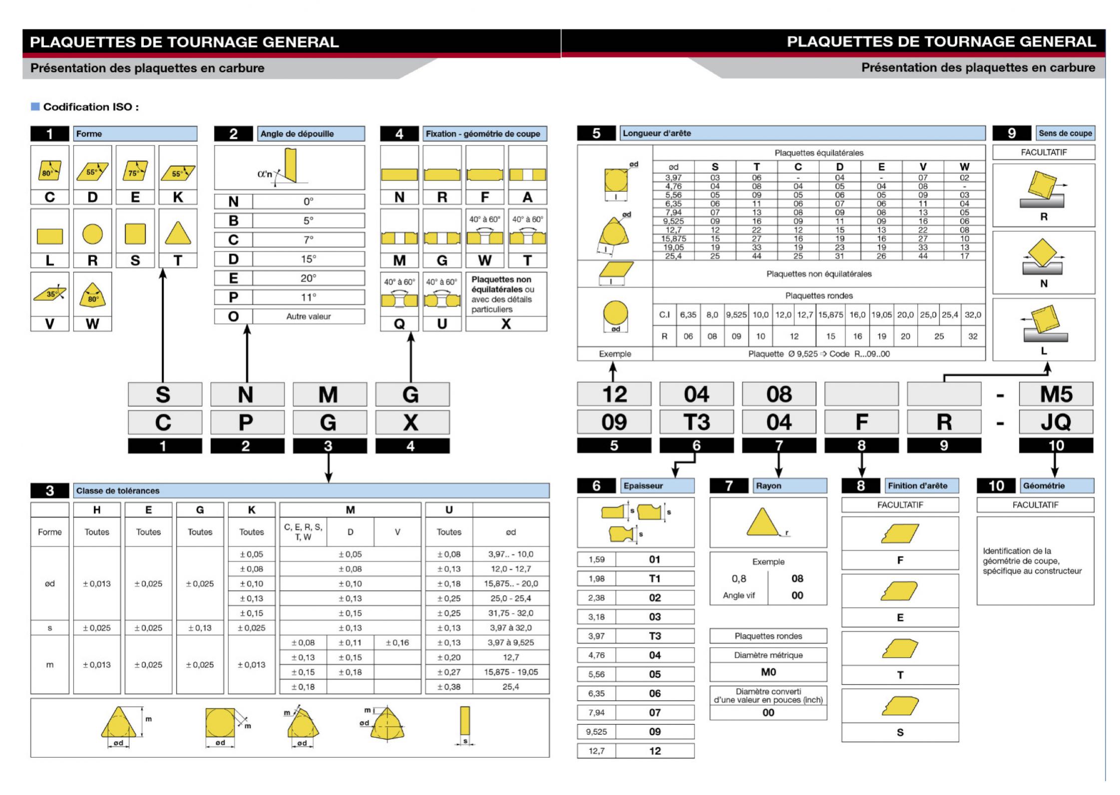

    Hi Steve,
    Thanks for this completes charts, if somebody is interested, I have the profiles for standardised carbure inserts normally in pdf but they are in images on those links, hope that can help you too.
    Have a nice day.
    Pierre
    Carbide Insert equivalent & comparison charts-codification%2520iso%2520plaquettes%2520et%2520p-o%2520.jpg
    Carbide Insert equivalent & comparison charts-codification%2520iso%2520plaquettes%2520et%2520p-o%25201.jpg
