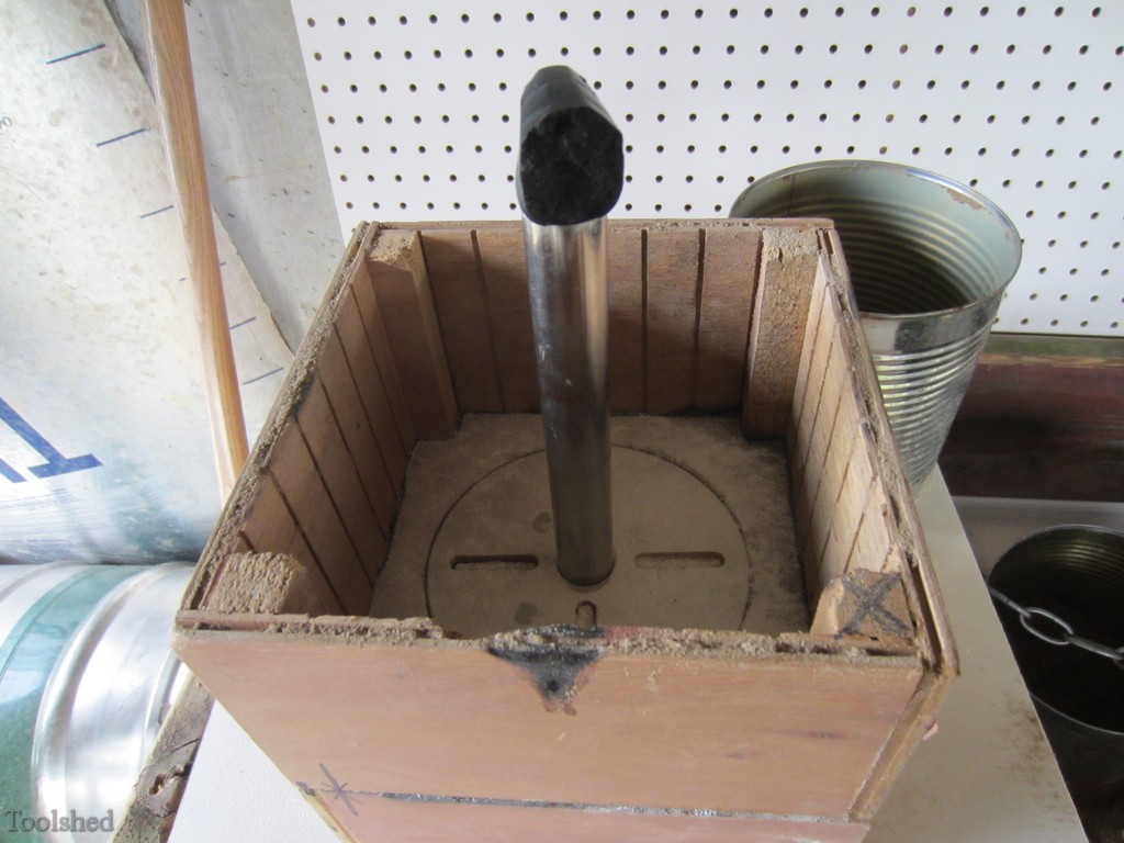

Howdy y'all! New supporter here. Love this stuff. Anyway, for my own introduction I'd like to put forth one of my builds.

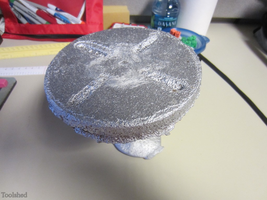

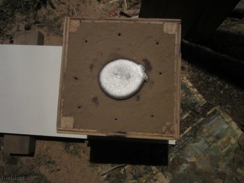

Being able to cast your own tools is a real gift. This was a faceplate I made for my small craftsman lathe. I had intended there to be slots through it but that didn't work out.
Initial casting. You can see I used the pouring sprue as the MT2 beginning:
Attachment 49217 Attachment 49218 Attachment 49219

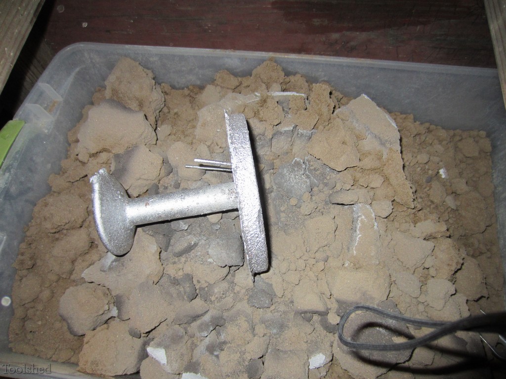

Rough cast:
Attachment 49220

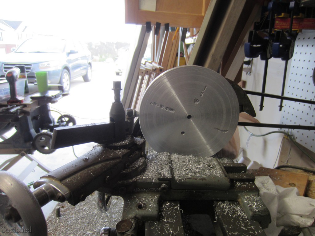

Turning it all pretty:
Attachment 49221 Attachment 49224

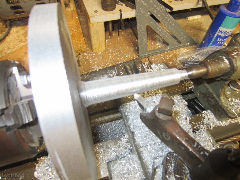

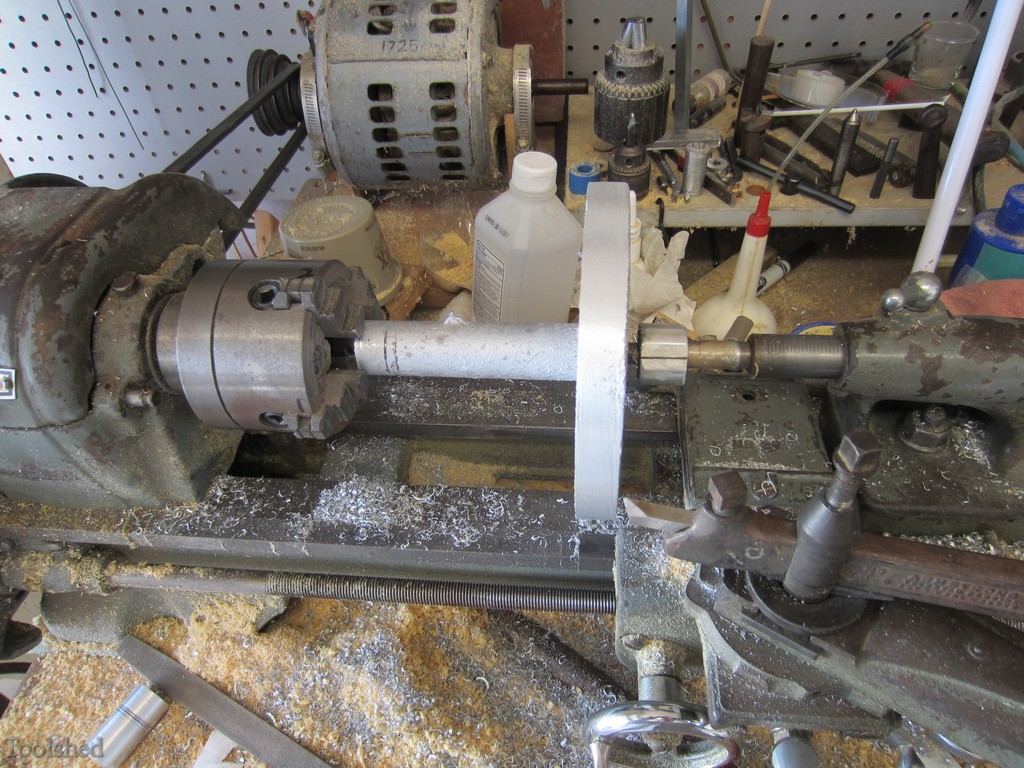

Turning the morse taper with tailstock offset:
Attachment 49222

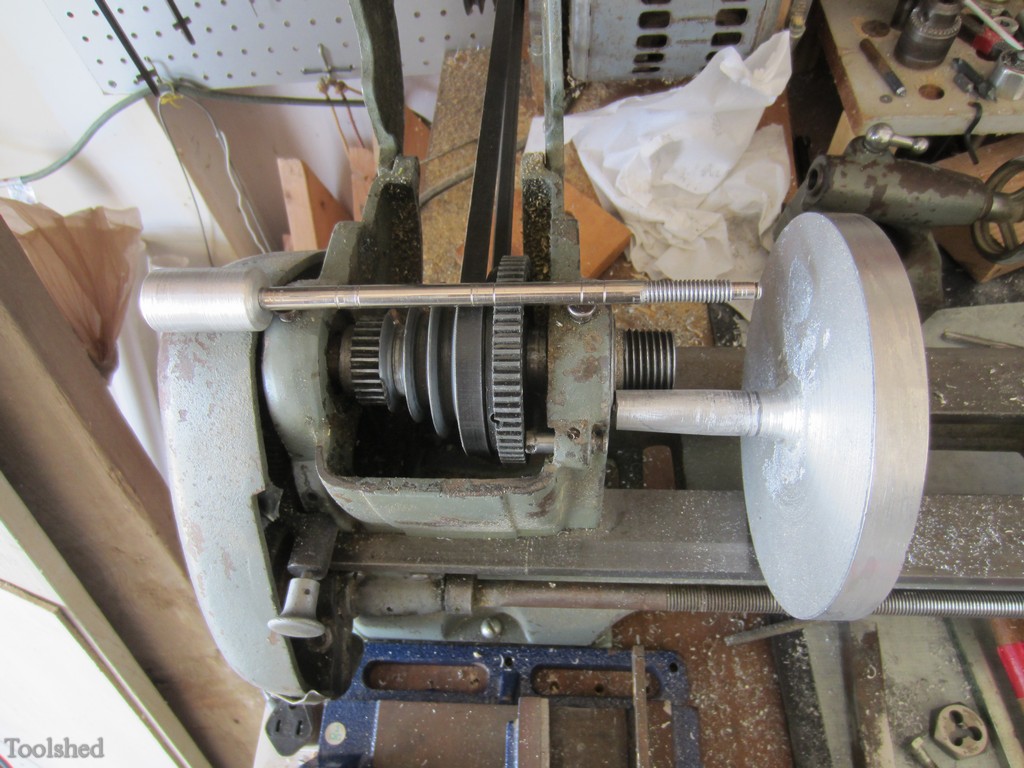

Adding a drawbar:
Attachment 49223
