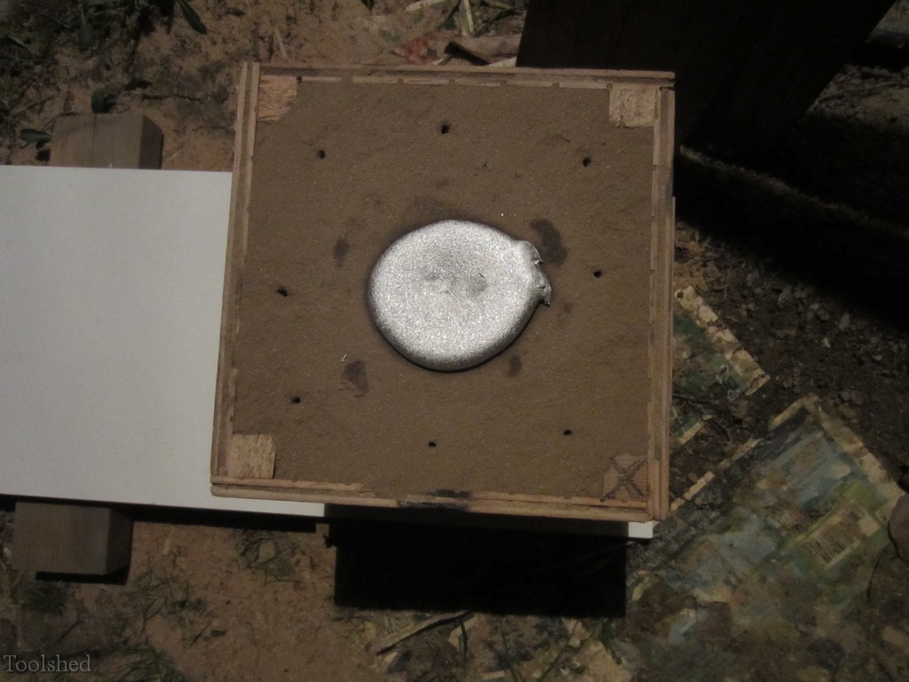

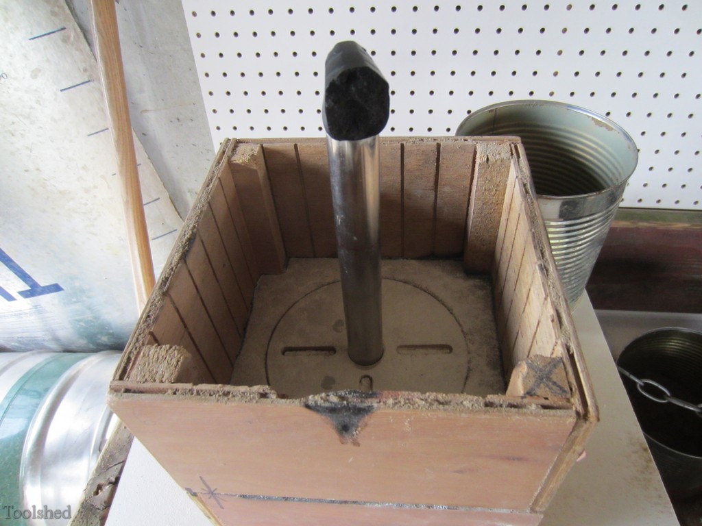

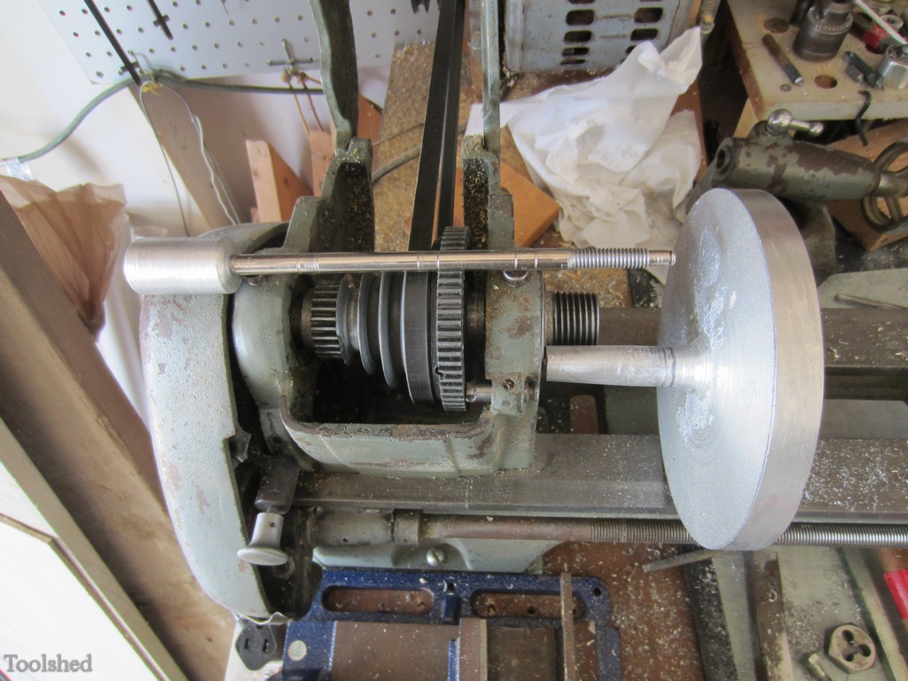

    Howdy y'all! New supporter here. Love this stuff. Anyway, for my own introduction I'd like to put forth one of my builds.

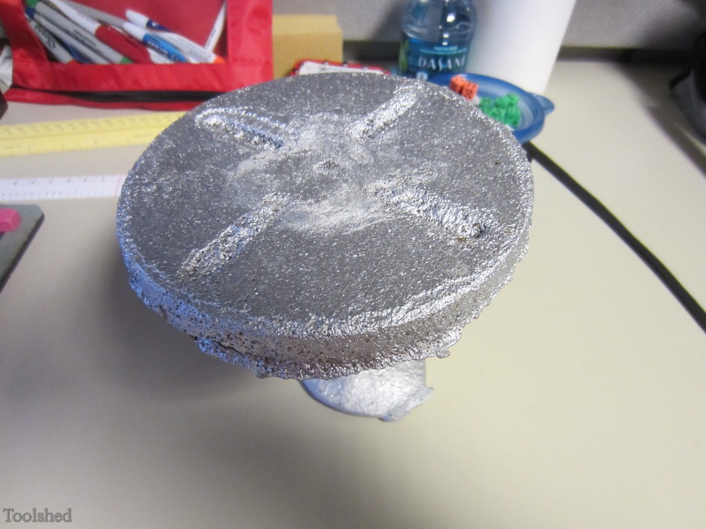

    Being able to cast your own tools is a real gift. This was a faceplate I made for my small craftsman lathe. I had intended there to be slots through it but that didn't work out.
    Initial casting. You can see I used the pouring sprue as the MT2 beginning:
    Cast Aluminum Faceplate For Lathe-lathefaceplate_4.jpg Cast Aluminum Faceplate For Lathe-lathefaceplate_10.jpg Cast Aluminum Faceplate For Lathe-lathefaceplate_13.jpg

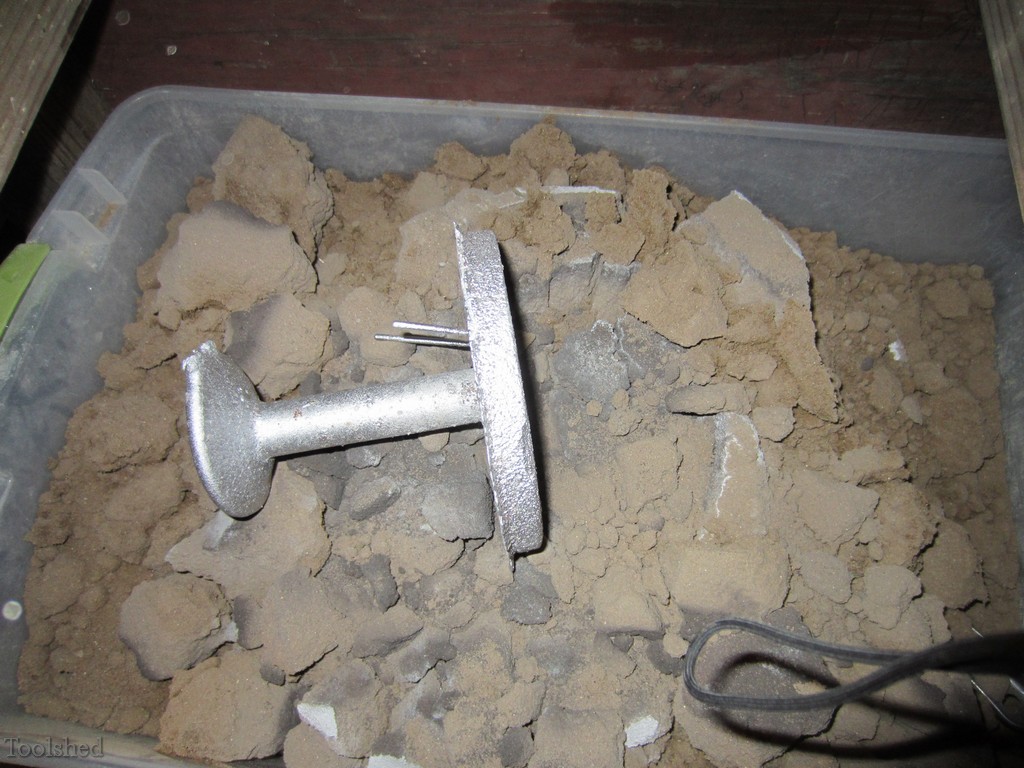

    Rough cast:

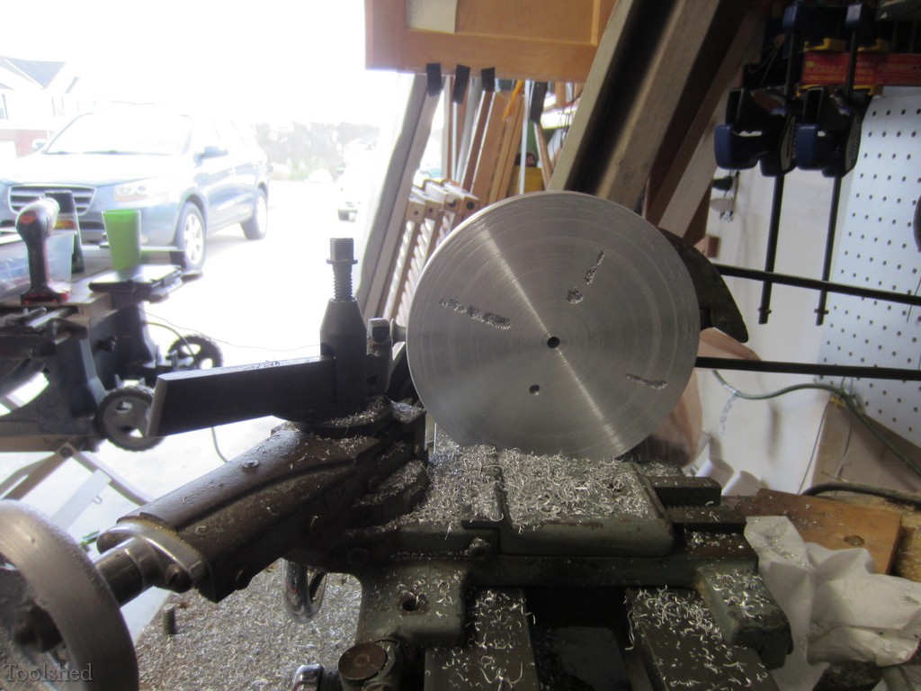

    Turning it all pretty:
    Cast Aluminum Faceplate For Lathe-lathefaceplate_chucked_5.jpg Cast Aluminum Faceplate For Lathe-facingthefaceplate_4.jpg

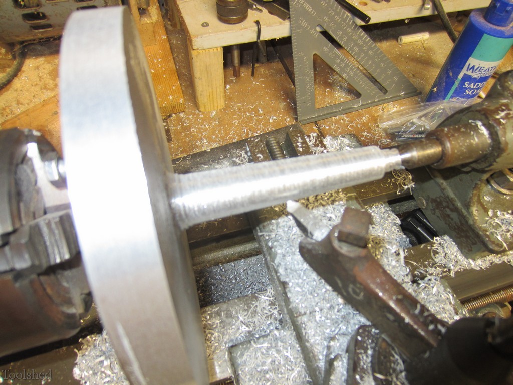

    Turning the morse taper with tailstock offset:

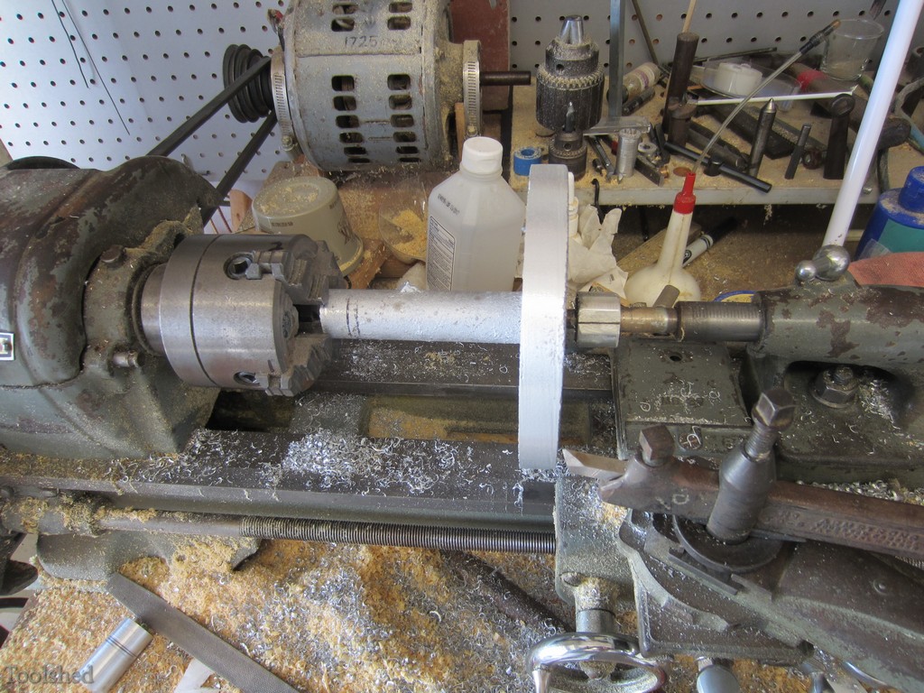

    Adding a drawbar:
