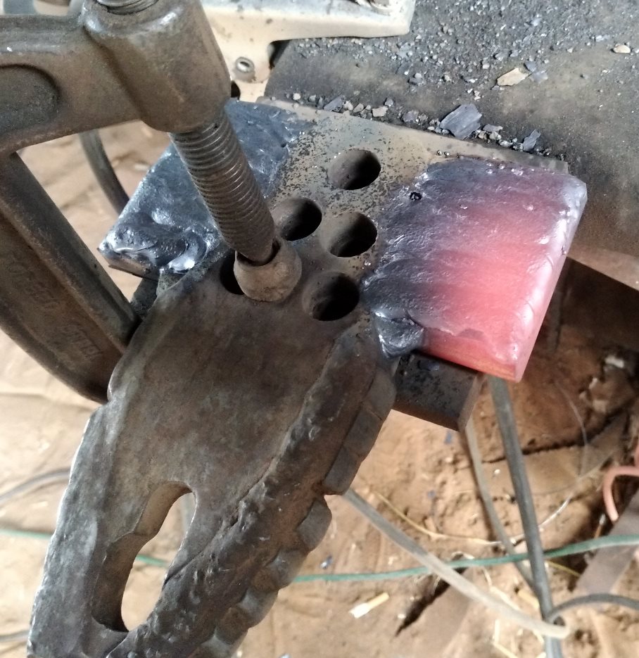

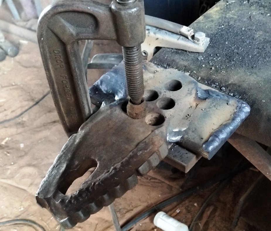

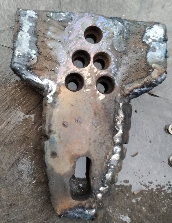

    A while back I made a 9-inch bit for horizontal boring My friend needed a smaller one but larger than the standard 4inch but not as large as the 9inch. I welded extension tabs to a worn standard bit then hard faced it
