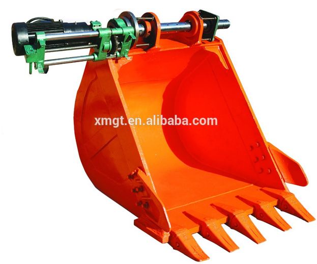

i need to build a portable boring machine, to sleeve two 3 1/2" x 20" pin holes in an excavator which are worn tapered up 5" any help appreciated.

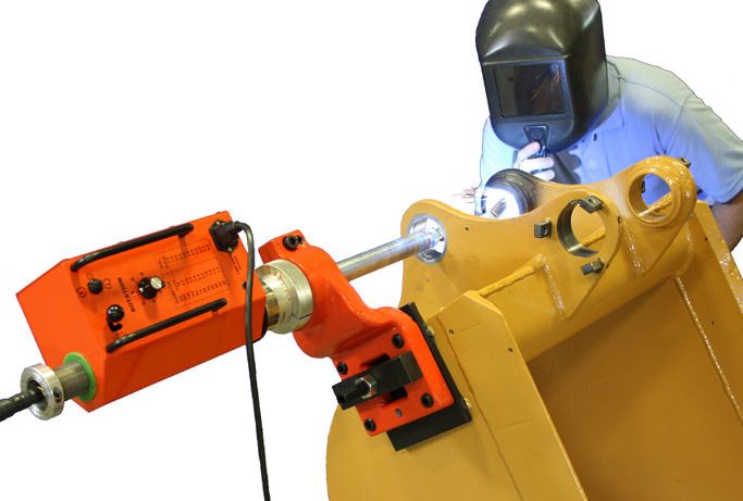

Take a look at those portable cylinder boring tools. They are designed to swing a single cutter through the bore. There are also welders to bring the bore back to size so you can remachine them to final size. Attachment 17601Attachment 17602
By the way, there are machine shops that specialize in on-site heavy machinery work.
Use a drill with a magnetic base as a milling machine with suitable supports for a boring bar.
My son has done this for a living and there is not much to it if you want to do it farmer style, you jut make an of set carriers on each side to hold your boring bar made out of a hefty piece of shafting which can use metal to metal close bored holes with plenty of lube.
The drive can be just about anything that can be speed controlled ie: gear mtr with chain and sprocket drive/large drill mtr.
When you finish one side flip boring bar around and repeat. you weld your offsets on to the equipment how ever you can get a good purchase on your equipment.
You will weld your sleeves once you get done with a pin to hold them straight while welding, should not take but a light ream to finish up the holes.
Good luck just remember its not as hard as it looks and keep it simple.
