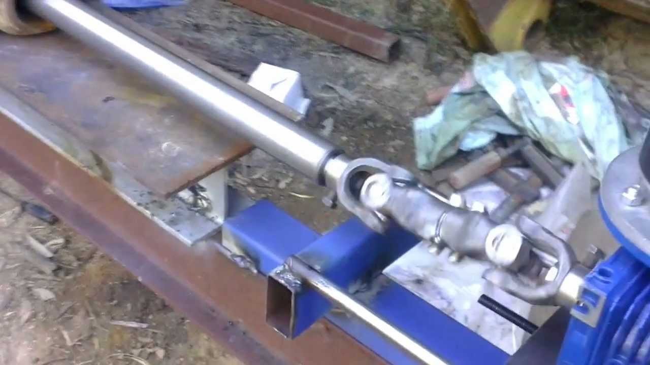

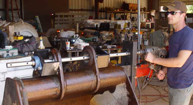

I have built two of these rigs. I used a milwaukee mag drill motor. It had the gear reduction option plus a variable speed VFD control and is rated for a 1.5 inch drill bit. It was very similar to this picture. Which uses the Milwaukee drive motor. I built a very similar rig with two precision shafts and an acme thread drive and a hand driven feed.
http://www.homemadetools.net/forum/c.../2017/04/1.jpg
You will then need a boring bar that will accept the square lath style carbide bits. We cross drilled and tapped ever 3-4 inches. Square holes can be broached or inserts sweated in.
You will find that simply sticking a mag drill on will not give the results you want. The vibration will move the drill around and the rack gear has too much play, this will cause bit chatter and quickly destroy both the bit and the work. I also found that connecting the boring bar directly to the motor made it hard to line up and caused vibration. I used a short drive line with two U-joints, this allowed for a slight misalignment while still providing a precise feed.

You will also need a couple line up cones to center the bar to the bores while you tack weld the flange face bearing plates on.
http://www.homemadetools.net/forum/c.../2017/04/3.jpg
Also some "L" shaped plates to give a standoff distance between the bearing plates and the pin boss. This lets you see in and should give you enough space to adjust the bit without dismounting everything. Here they used angle iron.

The important thing is to have a very precise low back lash feed and a powerful enough motor that you can control the speed of.
There are many ways to build this that will work. The first portable line bore I built, I used a milling table off of a shop drill, to which I mounted the Milwaukee drive motor. It was rigid and fed smoothly without chatter. It was just really heavy to lug around and setup. But as it was a proof of concept, I just used what I had at hand before laying out a lot of money. After I seen it worked, I harvested parts for my next build which turned out much like the one above, only without the shiny paint.

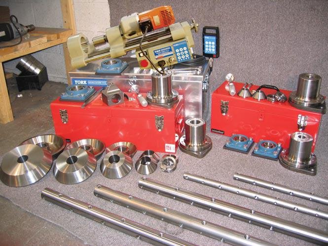

Renting a machine, or hiring one might also be a cost effective option rather than building your own. It can be a rather costly thing to build if your only doing a few bores. There are ready to run options out there. Portable Line Boring Machine Tools for Heavy Equipment Bore Repair
The ready made boring bars are worth buying. It's hard to make them cheaper than you can buy them. And the chrome plated shafts last.

I had to do the same job many years ago and we rented a Climax portable boring machine. For a 1 time job I think that would be the easiest solution. Should be able to find one most anywhere as we are in a town of less than 20,000 people and had no problem. Climax has a rental program and here is their contact link We're Here To Help! - Contact Us - CLIMAX Portable
