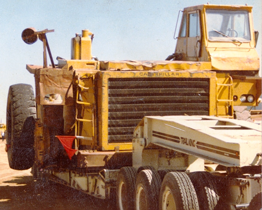

    This is an old rebuild but while browsing through my D10 dozer blade pics I happened on them and thought some would enjoy seeing some sledge hammer torch and welder body work
    This is how they look when they come in on the trailer

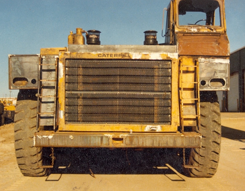

    parts get hacked off and new ones made from Hardened plate steel mostly ASTM 514 "T1" and schedule 80 pipe

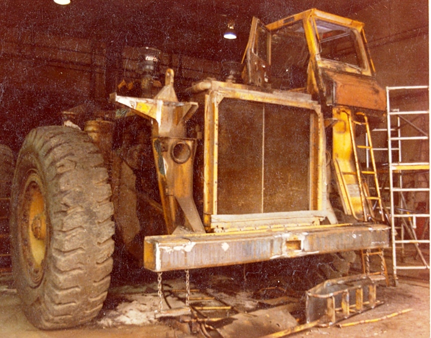

    ready for sand blasting and paint note the 12 oz beverage can on the bumper

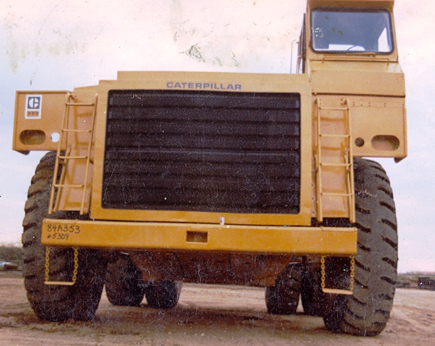

    after painting they had to look like brand new or I didn't get paid
