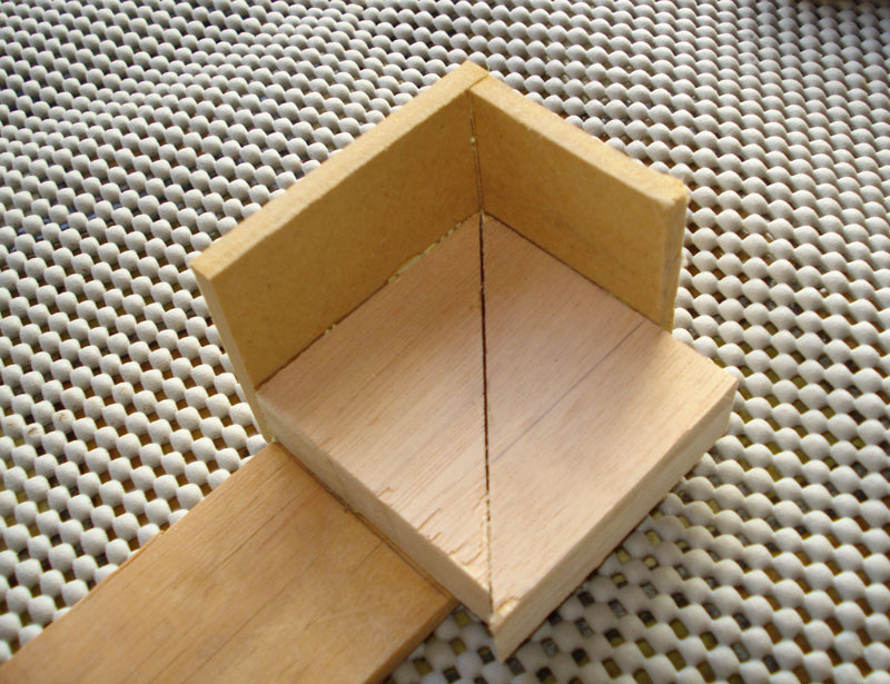

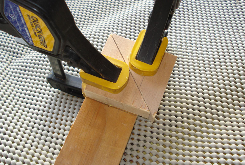

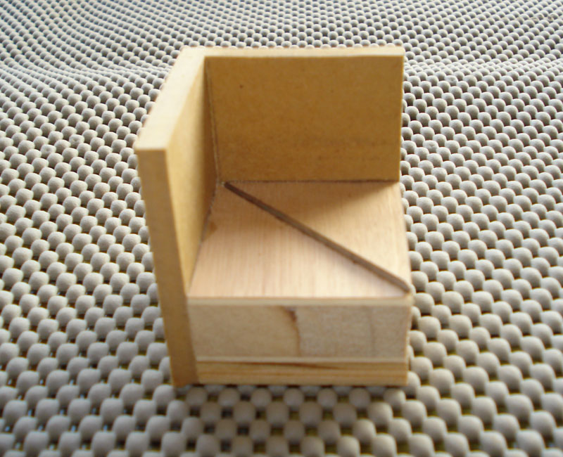

    CENTER FINDER
    This center finder is made with scrap wood and a cutter blade.
    It is useful to locate the center on round, square, or octagonal material (wood or plastic), for turning.
