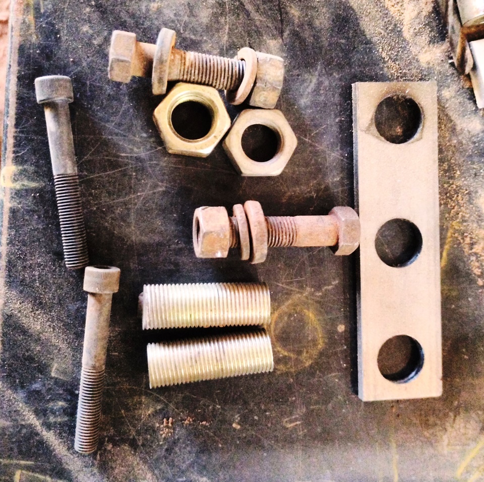

here is what I did I stated with 2 pieces of 5/8" fine threaded rods . the rods were the cut offs of semi truck air brake chambers so they are hardened grade 8 to start out with. and 2 5/16 socket head bolts a pair of fine thread 5/8 nuts and a pair of 1/2" fine thread bolts I wound up not using the 2 in the picture because I found a pair of 1/2" socket head bolts with better threads

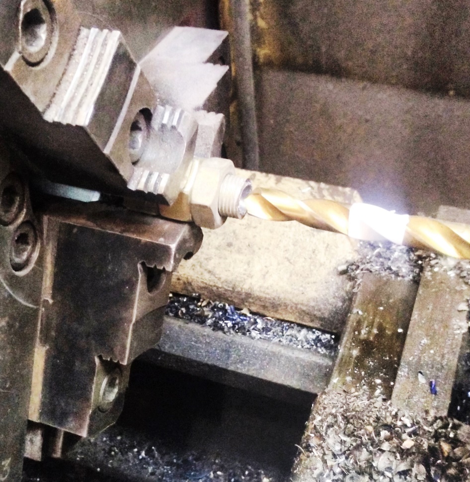

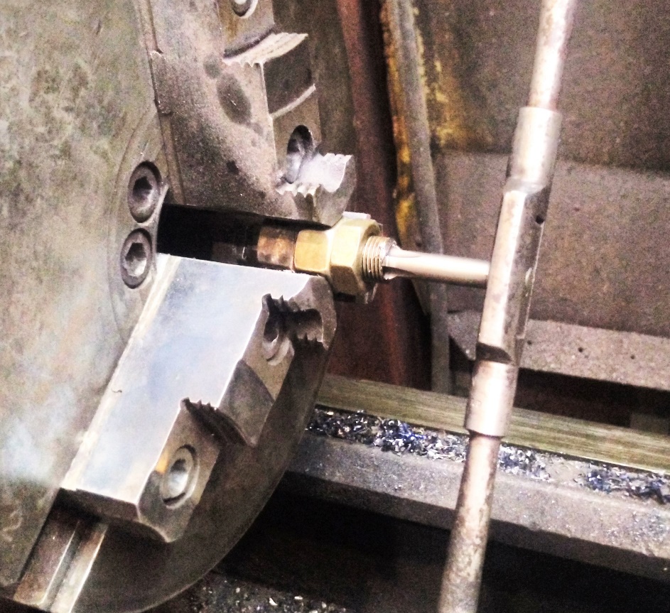

I drilled the rods with a 5/16" drill bit then counter drilled with a 29/64" to the depth of the white tape then threaded the inside to 1/2-20 TPI then filed flats on 1 end to fit a 9/16" wrench
turned down and off most of the head on the 5/16 bolts cross drilled to the chain pin size and parted them off. cross drilled the 1/2" bolts and parted them off as well and ground flats on them to the thickness of a chain link. then sawed the 5/8' nuts in half to make 4 jam nuts

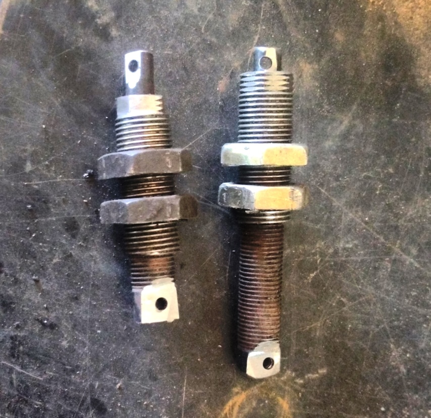

this is how they turned out.
Attachment 40932
Attachment 40933
Attachment 40934
Attachment 40935

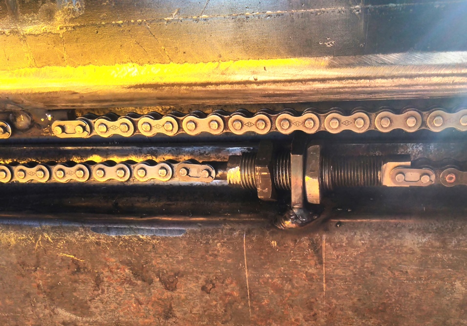

you can see all 4 ends of the 2 chains once the chains are tight it is just a matter of moving the jam nuts one way or the other on either side of the machine to achieve the correct position for the part they are connected to
Attachment 40936
