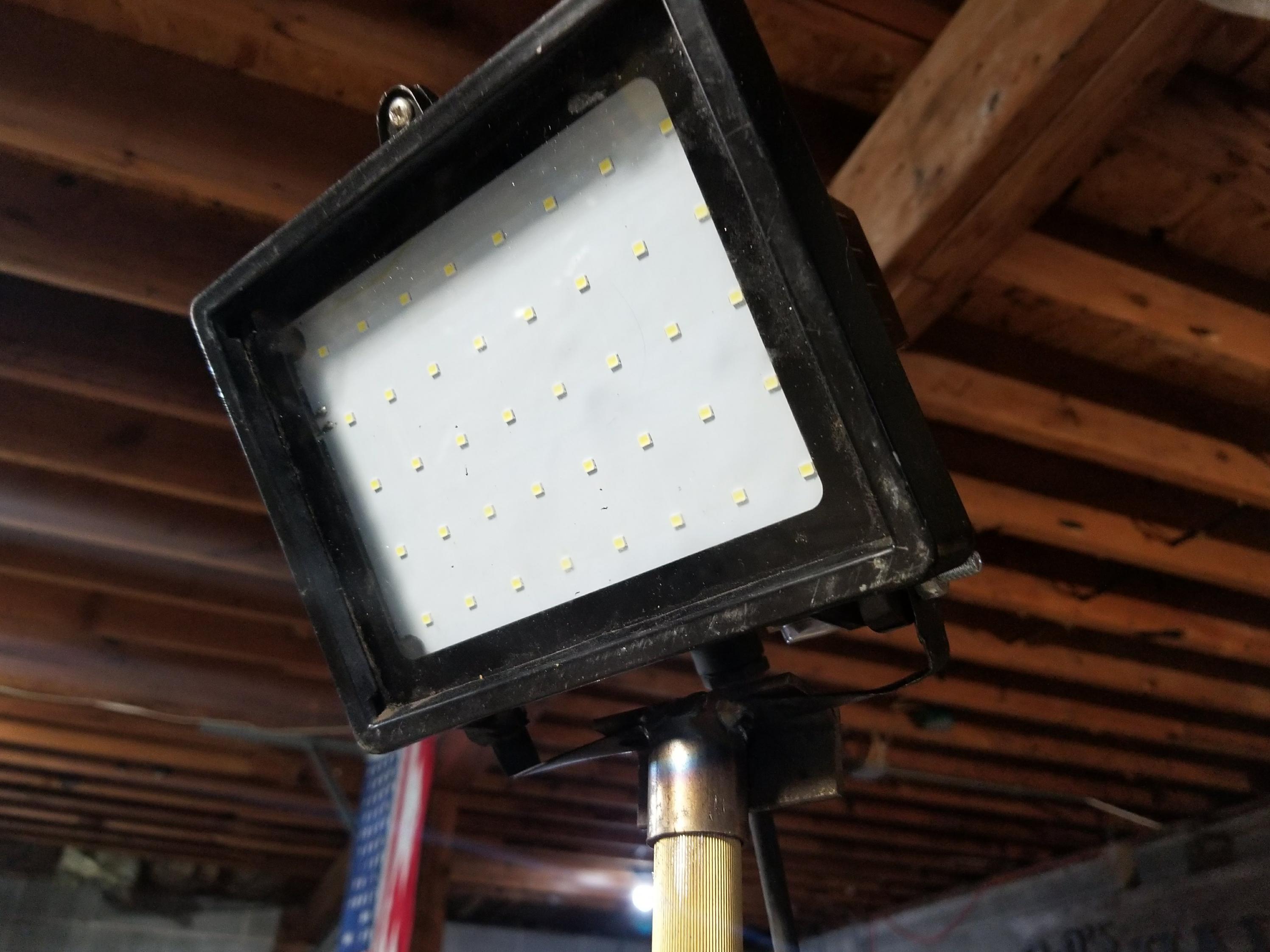

Parts:
-LED or Halogen Work Flood Light +/-10$

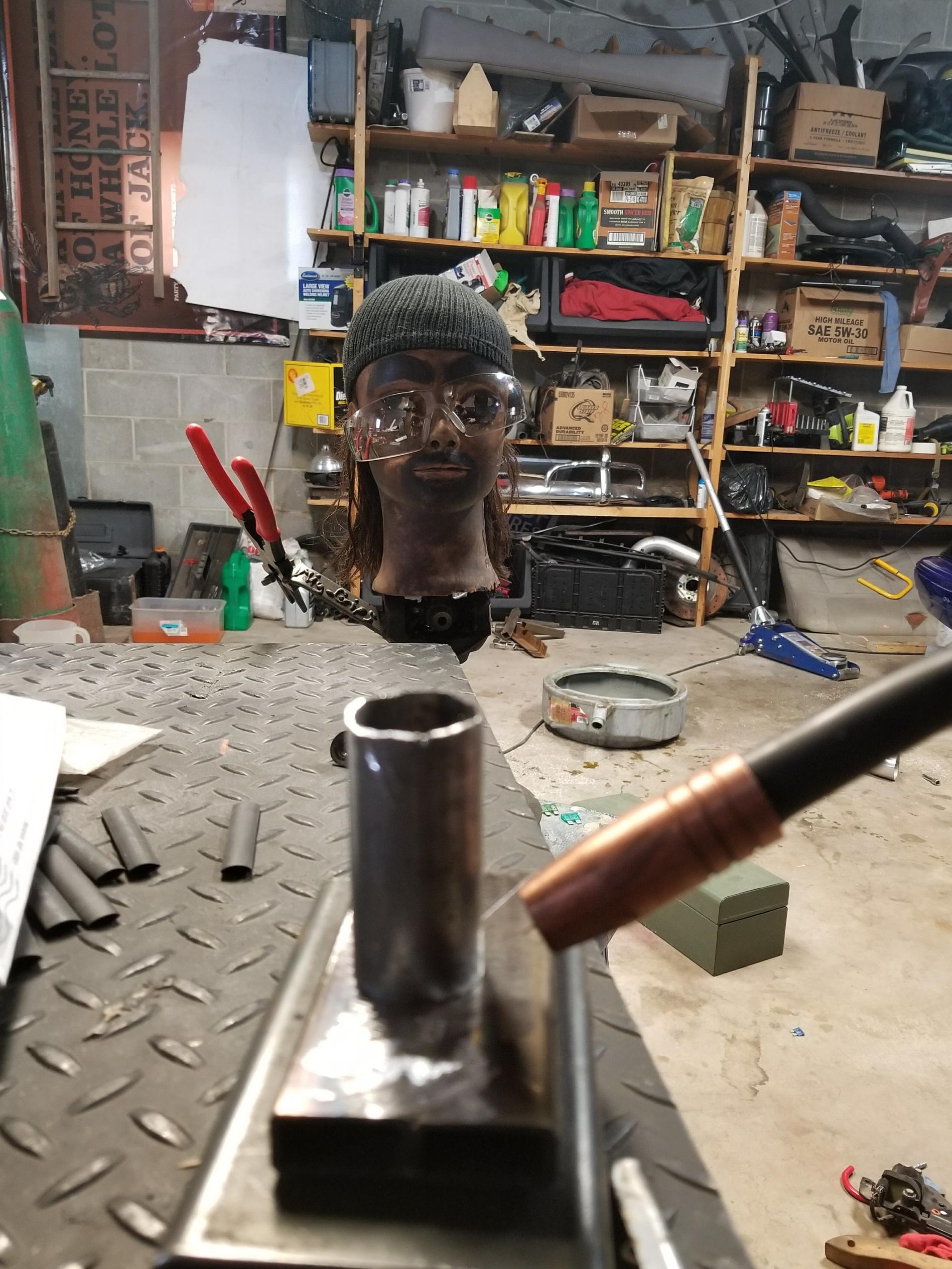

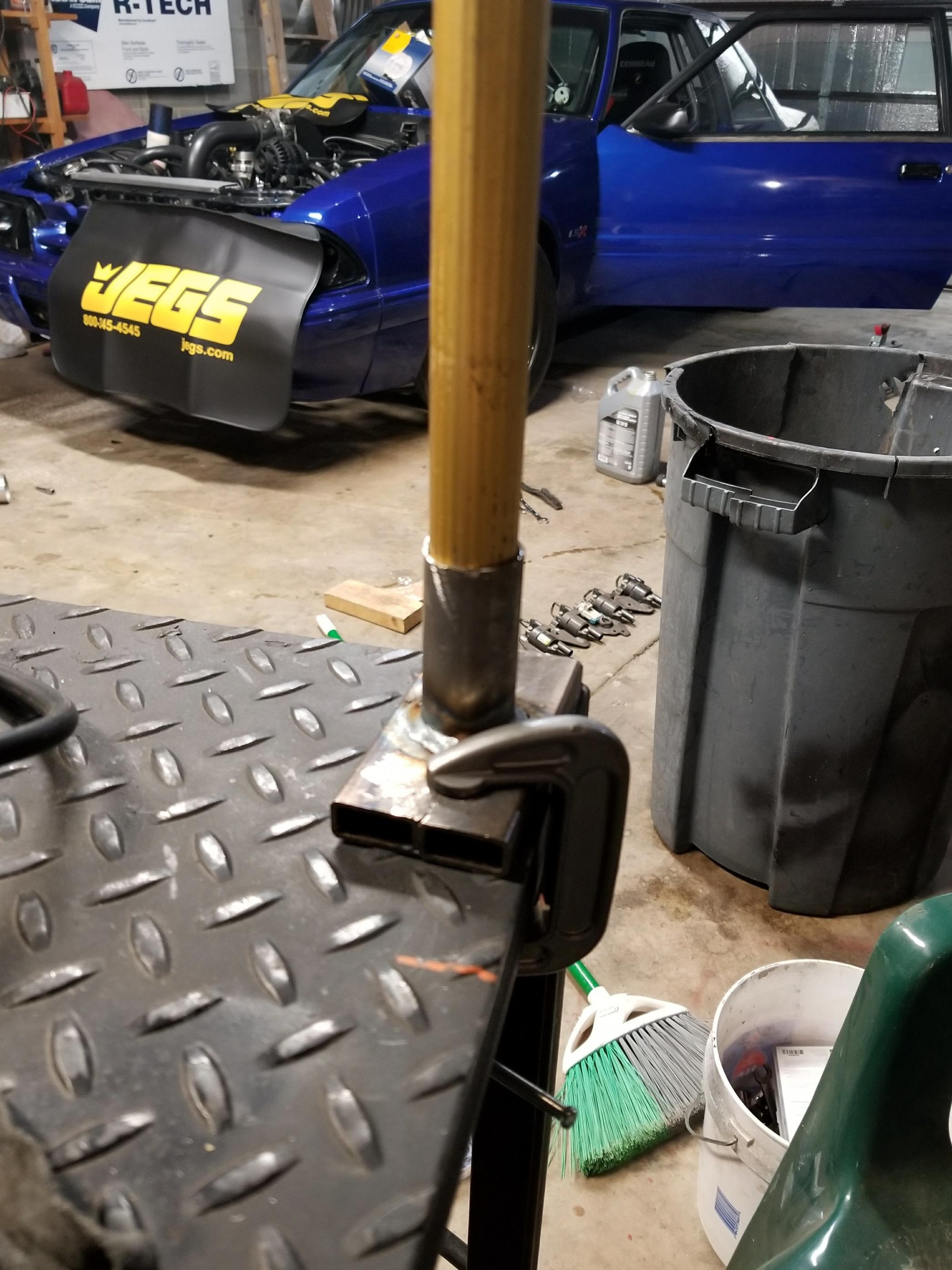

>>>Table mount fixture
>>>>Scrap round with the ID just big enough to fit the paint roller extensions OD FREE
>>>>Scrap rectangular tubing FREE
>>>>C-clamp depending on your table.. 1$ ?

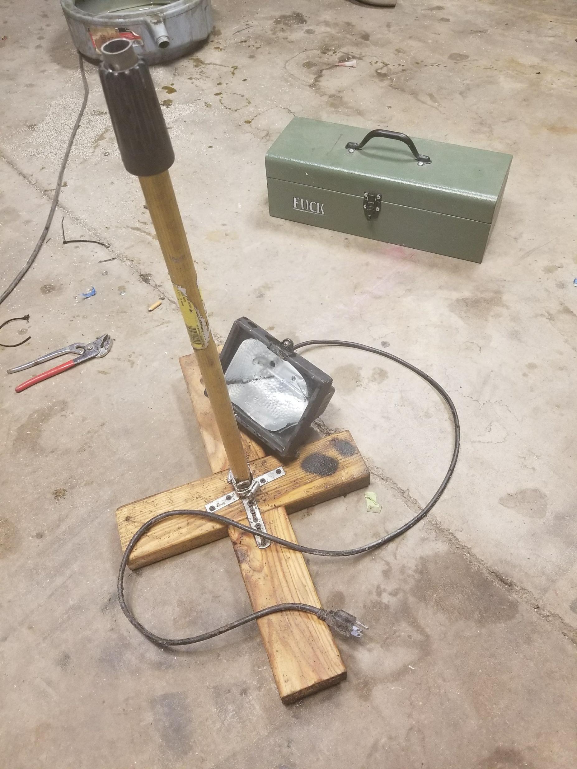

Attachment 22790
Not much to it really. Function over Fancy

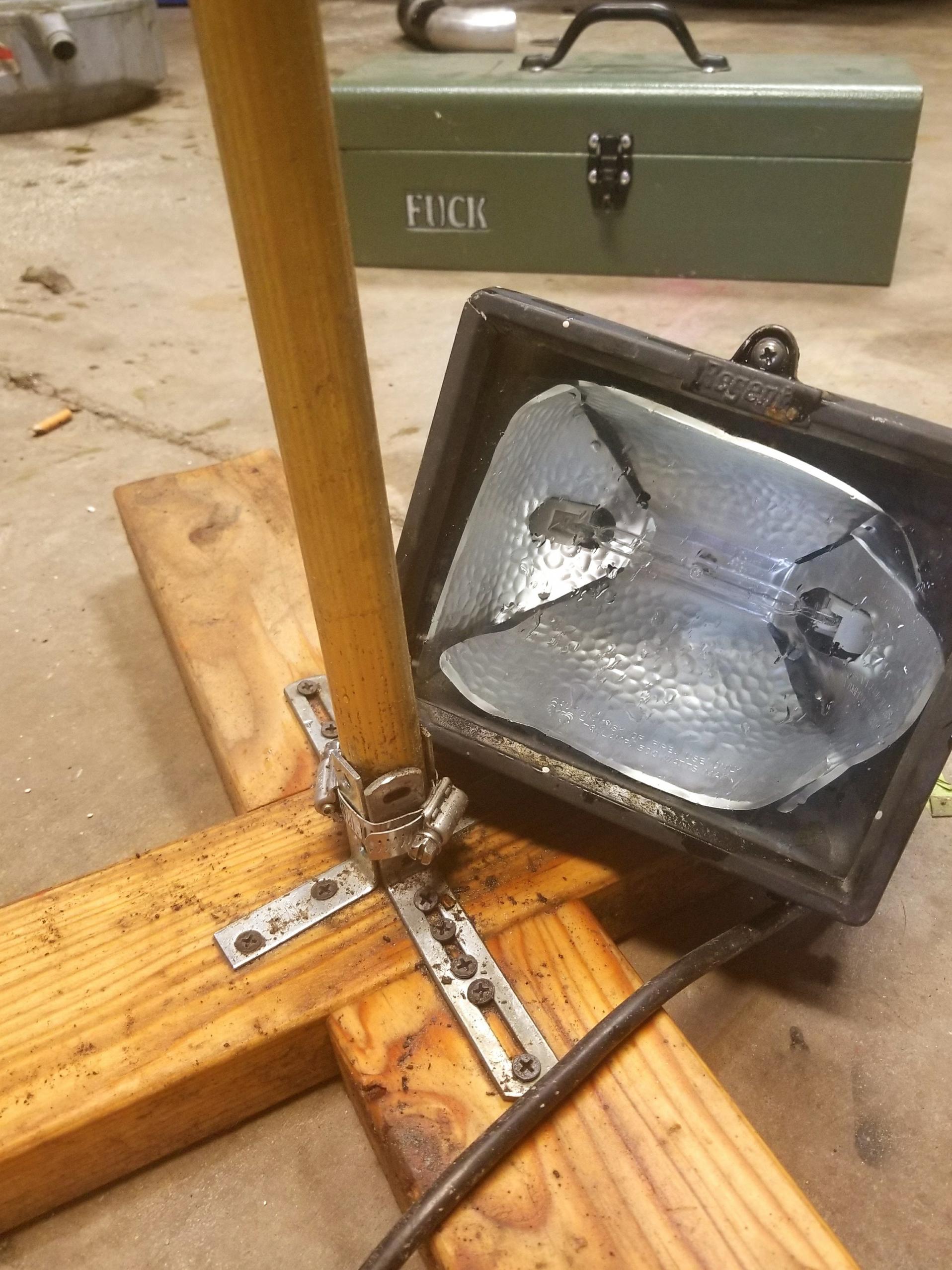

Attachment 22791
This shows the precision that went into making the floor base mount using your 2x4s, 90* metal bits and worm clamps

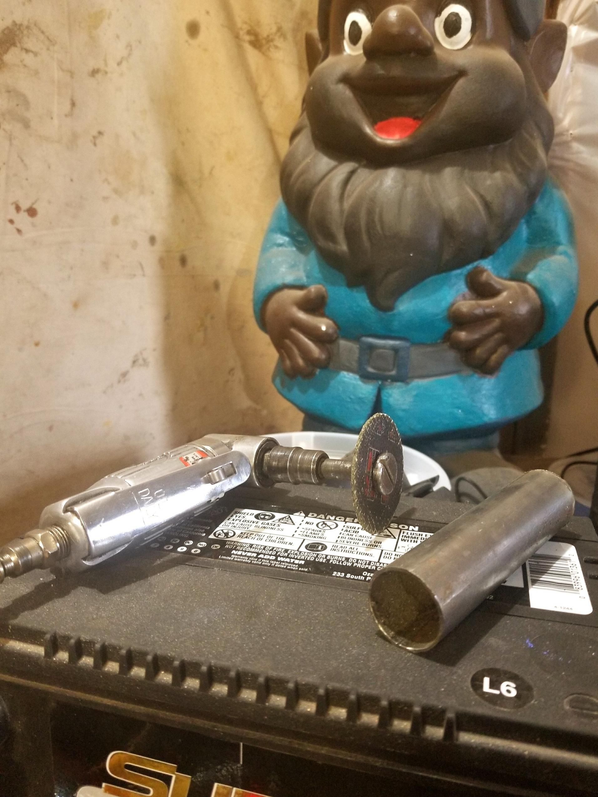

Attachment 22792
get your cutting tool of choice and cut to whatever length needed to keep the extension pole from moving around

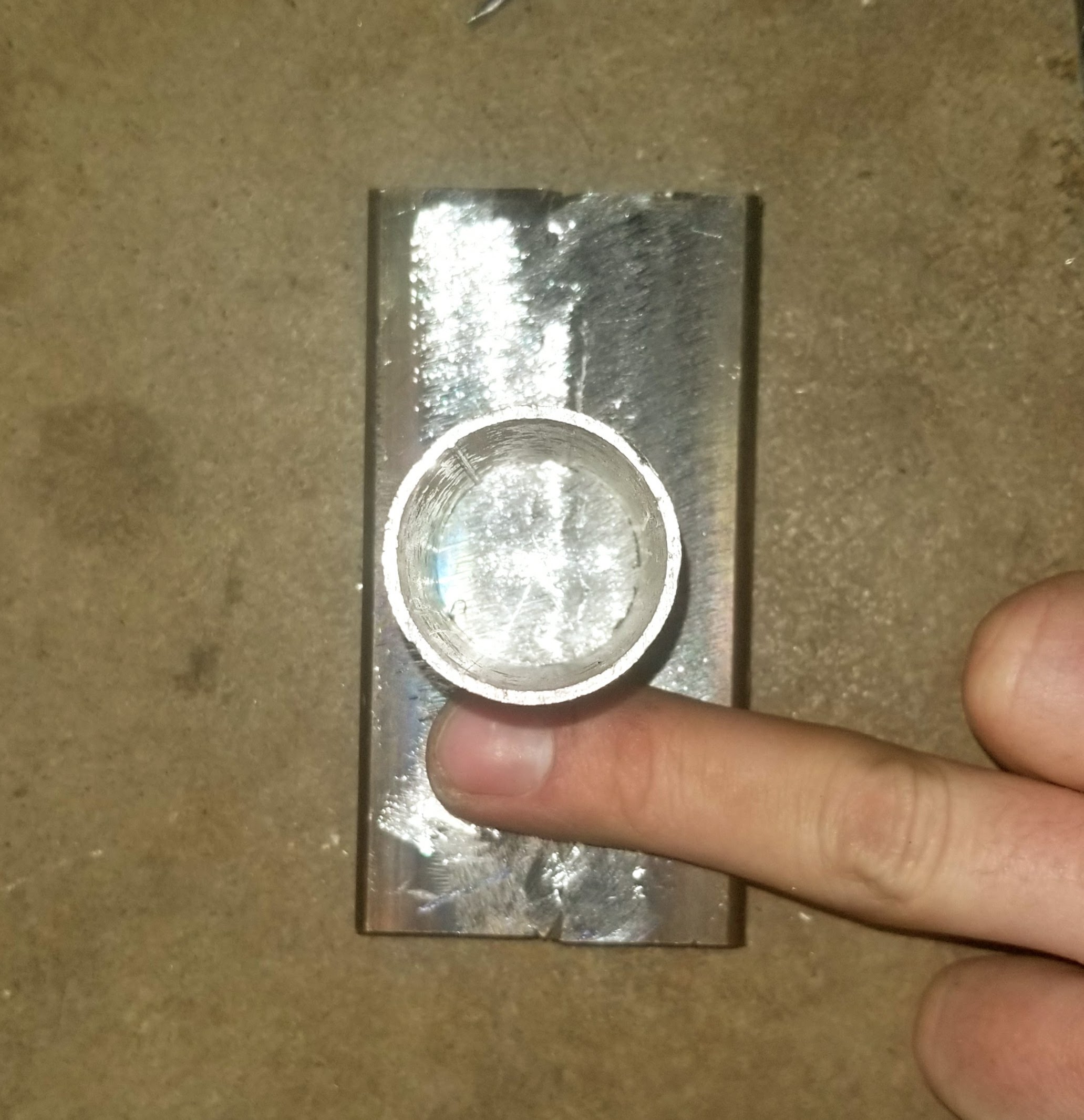

Attachment 22793
use your favorite finger caliper to get the pole sleeve nice n center

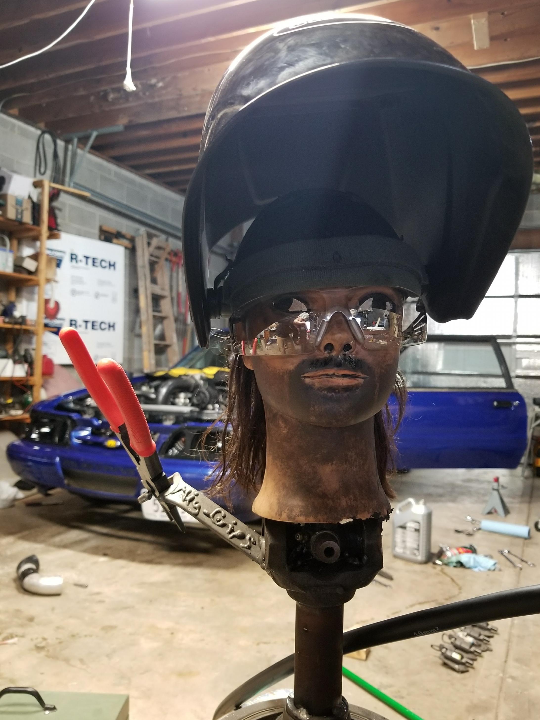

Attachment 22796
grab a clamp, position where is convenient and give that clamp a good twist er 2
Attachment 22797
Now your workbench has a fair amount of light and can position where is going to work the best.
