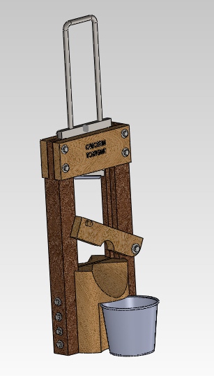

in this first image you see the guillotine in the raised and locked position
Attachment 5333

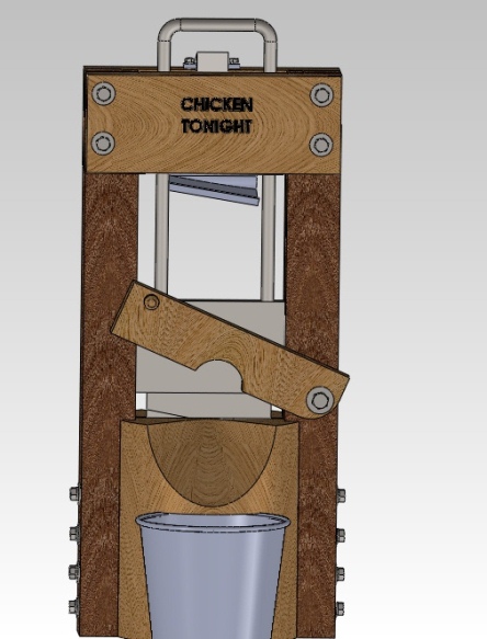

After placing the head in the grove lower the head lock
Attachment 5336

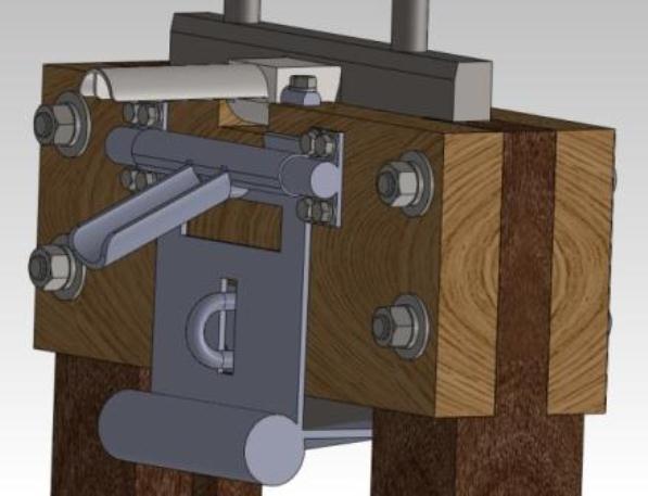

this image shows the double lock safety mechanism in the locked position
before the blade can fall the lower handle must be raised. It is impossible for the blade to fall if the trigger handle is depressed unless the safety lock is held open with the same hand
Attachment 5334

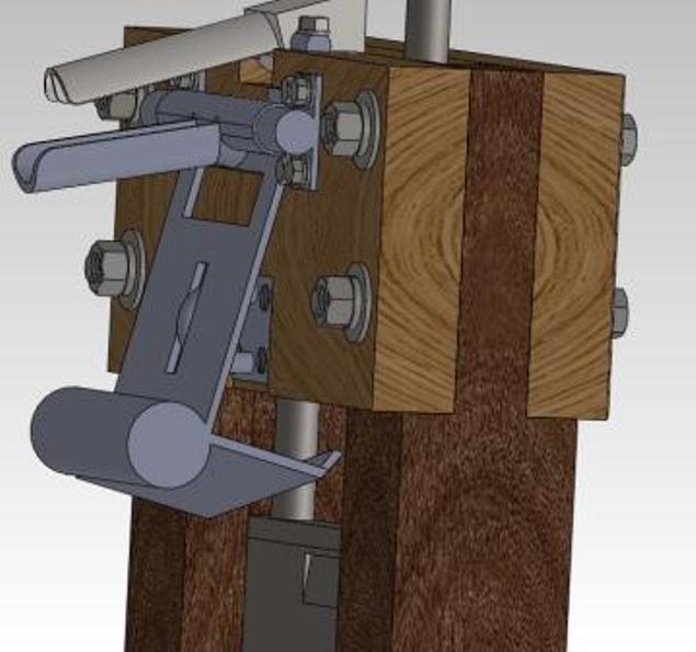

then apply pressure downward on the upper handle to release the trigger plate holding the blade while holding onto the legs of the bird
Attachment 5335

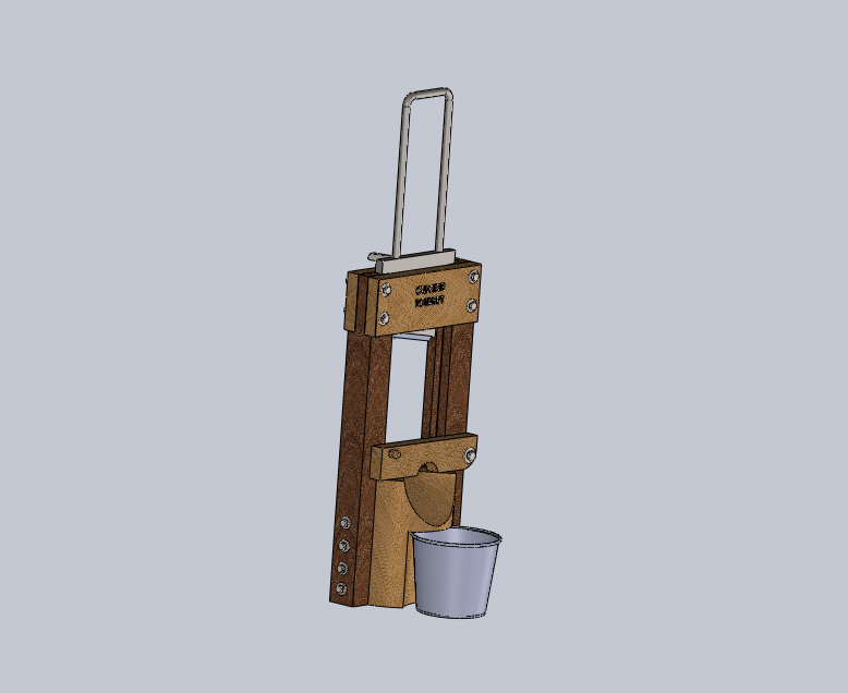

the head will fall in the bucket you place the bird in another bucket or drum with a catch and hold net much like a very small basket ball net to allow it to bleed out this prevents it from flopping around and bruising the meat while it bleeds out.
Attachment 5337
