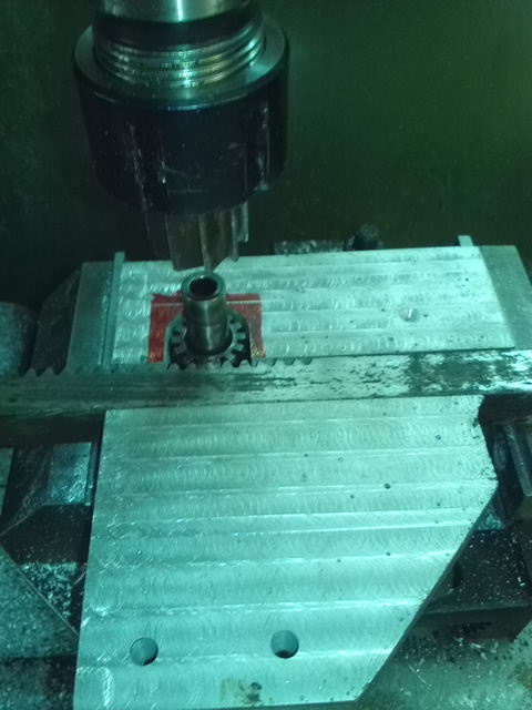

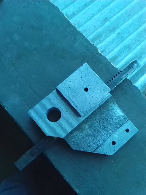

i have a chinese lathe and there's some systems that doesn't work well when you carry relatively heavy work ,the clutch is one .

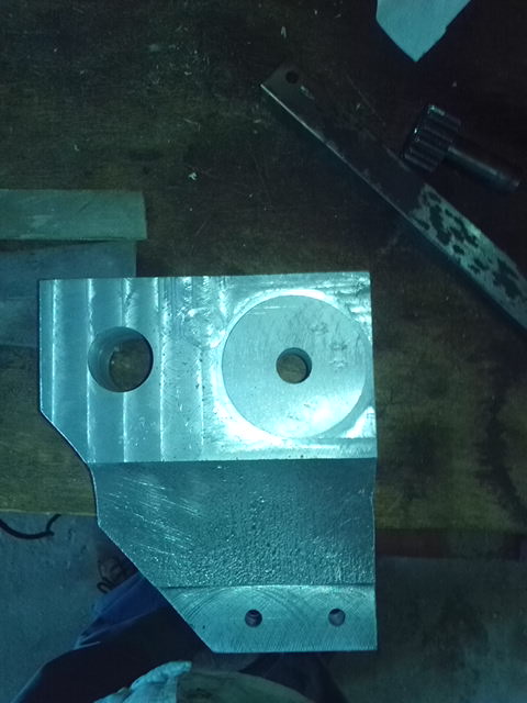

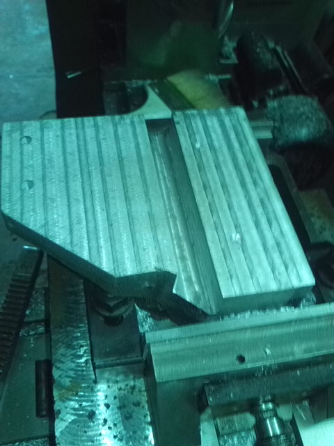

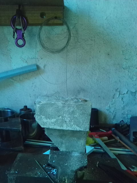

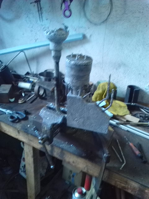

i've found a solution based on scrap parts , my English is a little rusted so i put pictures ,the first is the molding of the bloc
Attachment 6751

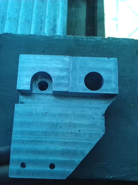

here the casting raw

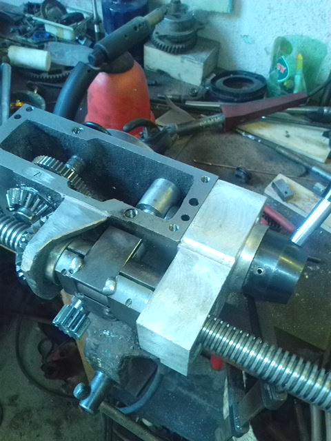

Attachment 6752

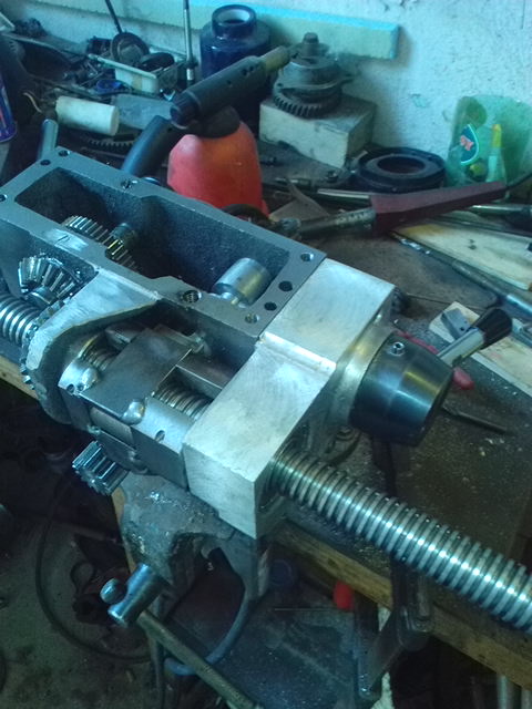

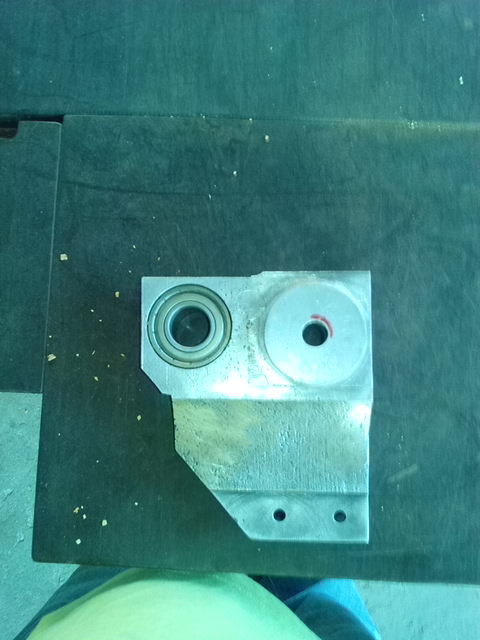

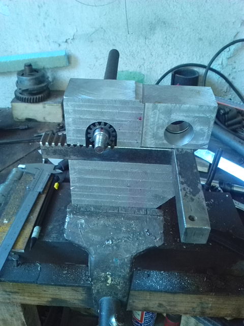

this is the parts that drives the added clutch shell

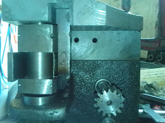

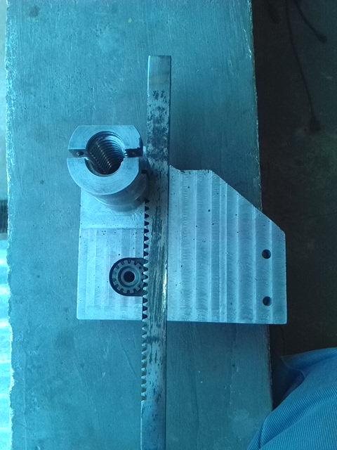

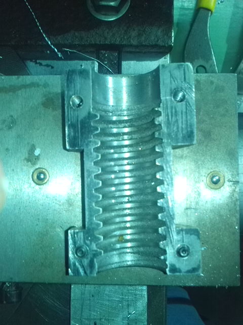

i' ve made a new nut in two parts , one moved by the original system one by the added system
Attachment 6754
unclutched position
Attachment 6755
clutched
Attachment 6756

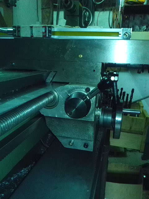

finished work
