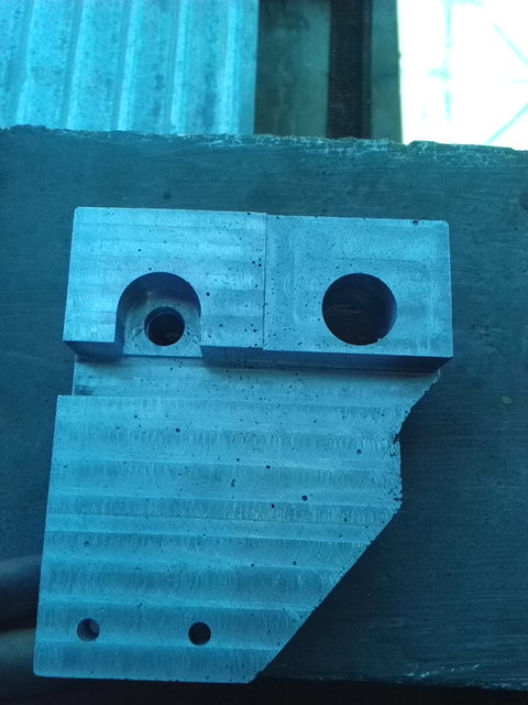

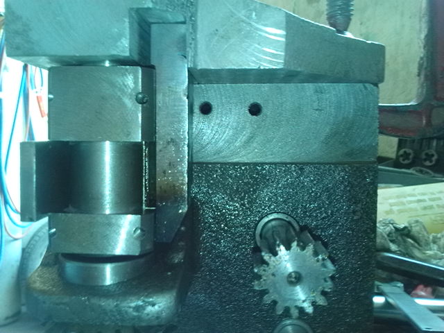

    i have a chinese lathe and there's some systems that doesn't work well when you carry relatively heavy work ,the clutch is one .

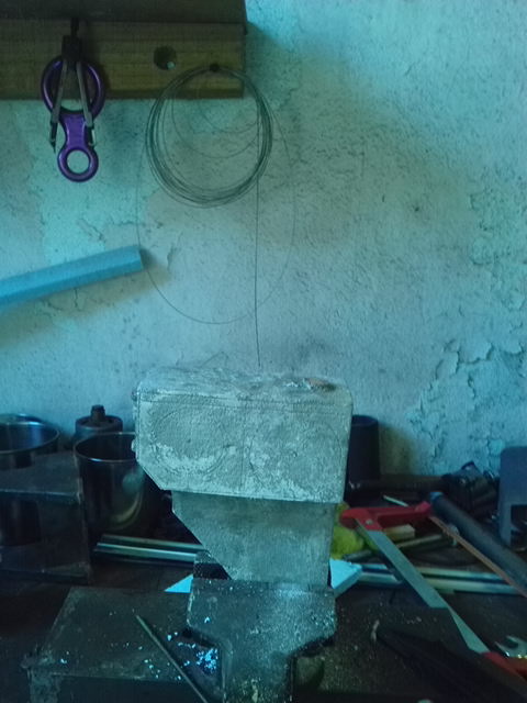

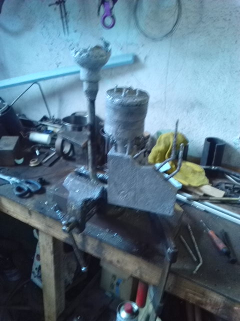

    i've found a solution based on scrap parts , my English is a little rusted so i put pictures ,the first is the molding of the bloc
    here the casting raw

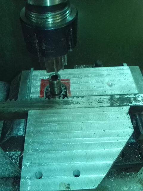

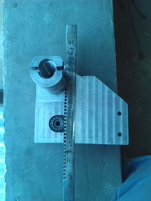

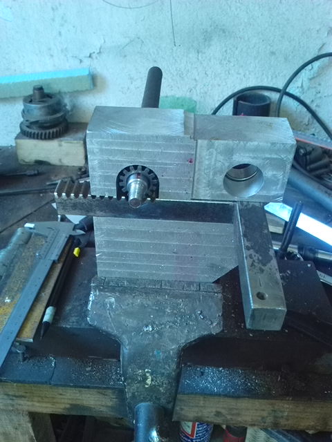

    this is the parts that drives the added clutch shell

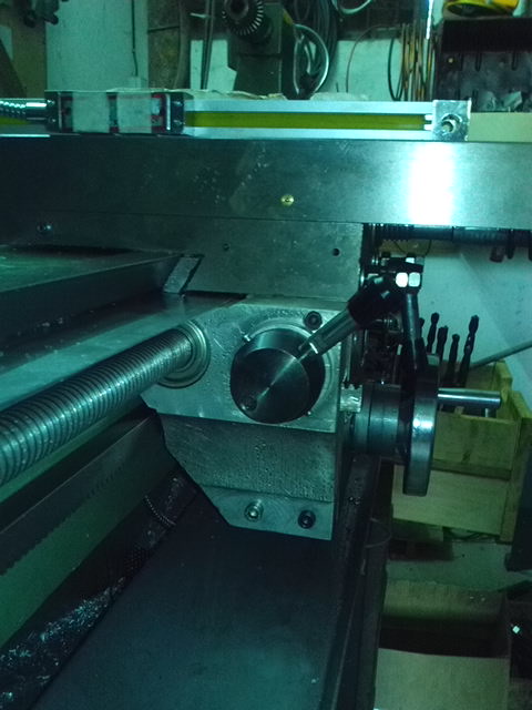

    i' ve made a new nut in two parts , one moved by the original system one by the added system
    unclutched position
    clutched

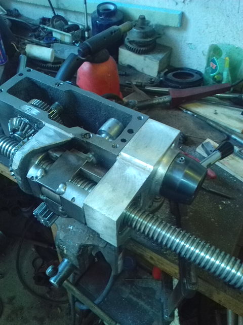

    finished work

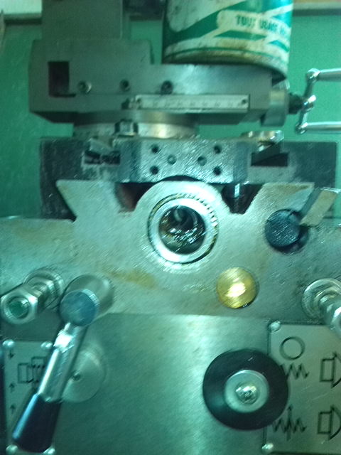

    Attached Thumbnails Attached Thumbnails chinese lathe main screw clutch-mis-en-place-2.jpg

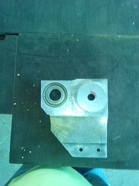

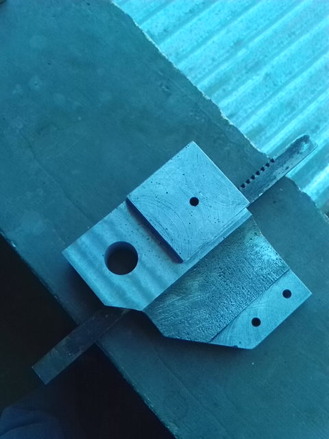

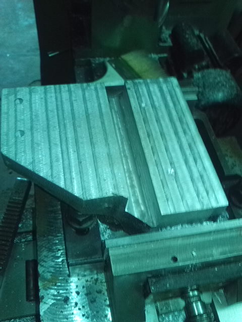

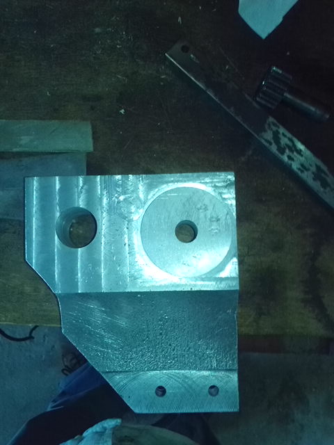

    ok i've to add some détails to my post just to make the way clear .
    so after casting the work begins by cutting around the blank
    after milling the faces cut the slot ,bore the pignion place and the main screw hole
    it will look like this now lets machine the front face
    first step ,the square boss is for the clutch bar it will be rounded later

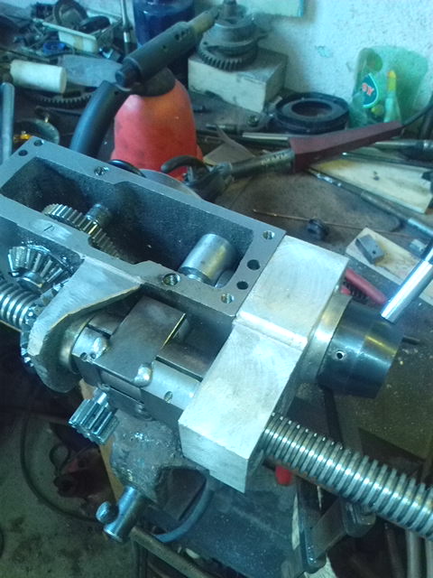

    the parts together just to see

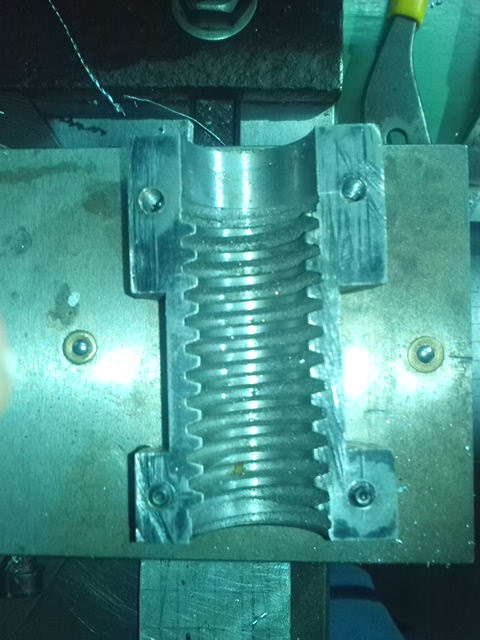

    the external nut with four small screws to adjust the play between the nut and the screw(the adjustment must be done before mouting the system on the lathe)
    on the front face a bearing is set to guide the screw
    the parts pré set
    the bar that supports the added nut
