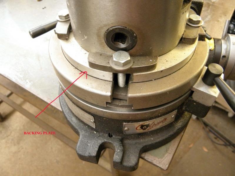

    Chuck Adapter Plate.
    Chuck Adapter Plate. Made from aluminum.

    Love the simplicity of your approach as compared to bolting the chuck to an adapter plate.

    The adapter plate is screwed on from the back.
    This is done so the chuck can be centered to the round table then to the cutting tool.

    Yeah. Many times, it's the simple solutions that work best.
