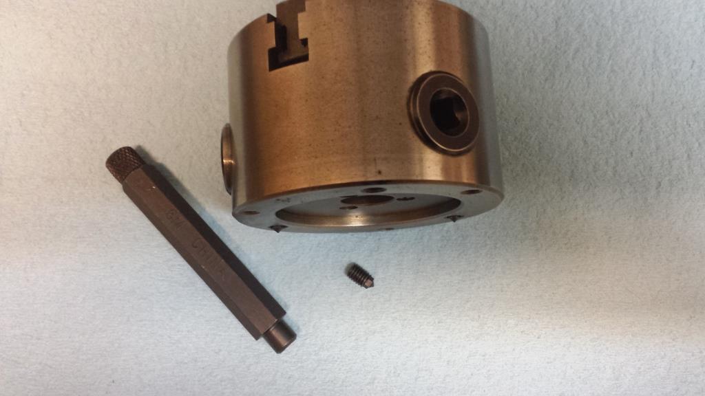

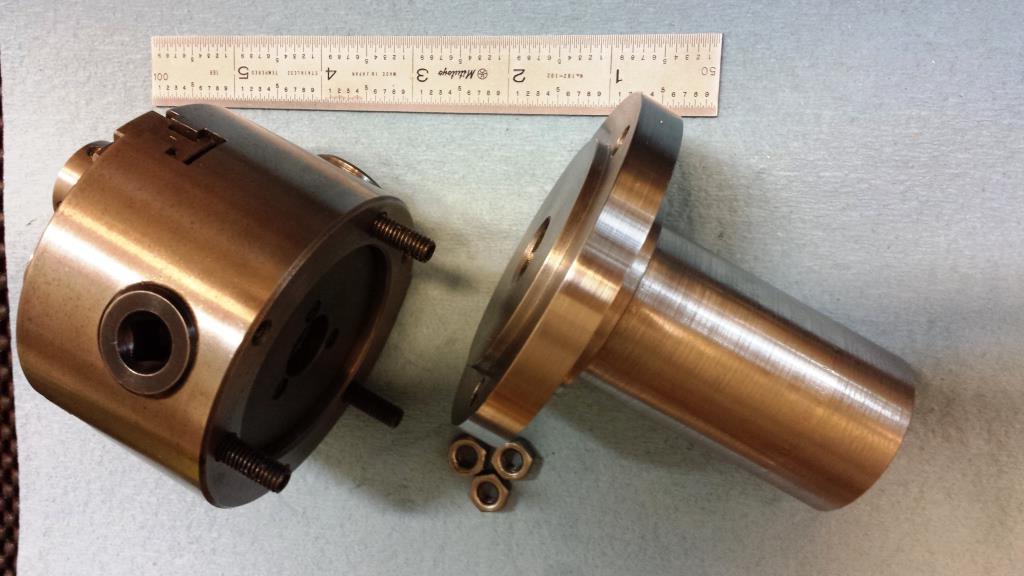

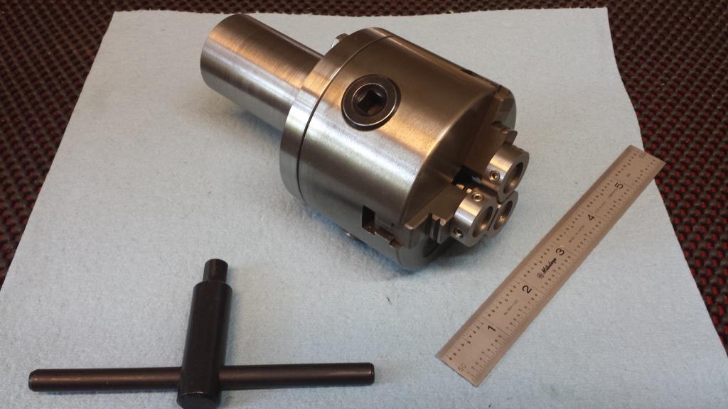

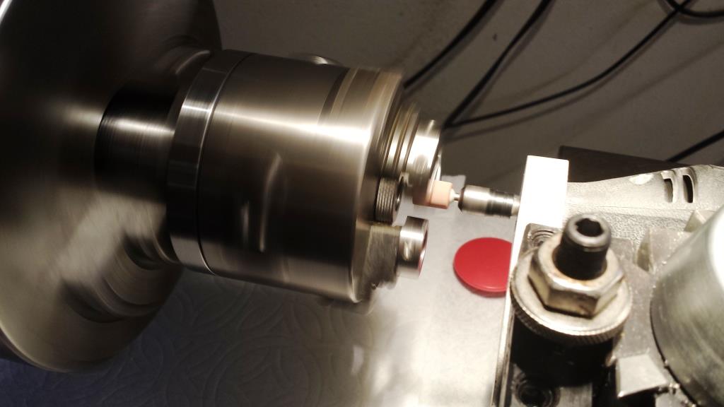

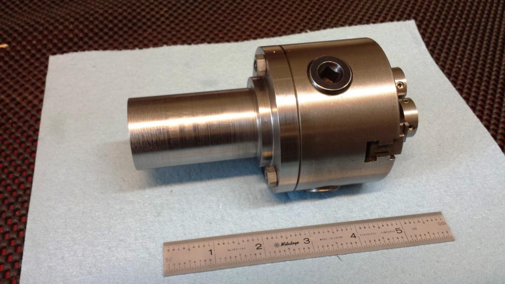

    I previously made a set of toolmakers mini jaws for a Yamakawa 80mm 3-jaw chuck. This is my original chuck for my 7” swing mini lathe and I added the mini jaws (see making the toolmaker mini jaws at Homemade Mini Toolmaker's Jaws - HomemadeTools.net ). However, the mini lathe is now equipped with an ER32 collet chuck and used primarily for small collet work.The 80mm chuck with the toolmaker mini jaws would be a great addition for my larger 12” swing geared-head lathe provided I could hold it with a precision mandrel.
    The 80mm 3-jaw chuck now has a mandrel machined from 1045 alloy carbon steel 3.25" round bar stock. The mandrel has an overall length of 3.3” and the shaft dimensions are 1.5” dia. x 2.5” long. The chuck is attached with three M6x1 studs and nuts on the larger end that is 3.150” dia.x 0.375” thick. In addition the larger end has a 0.110” deep step that inserts snuggly into a recess in the back of 80mm chuck. The three holes for the studs were located with M6x1 transfer screws and the holes are 0.257” dia. (Letter F drill). A 0.625” thru hole runs down the center of the mandrel and matches the maximum thru hole diameter in the 80mm chuck.
    Chuck Mandrel for 80 mm Chuck-mandrel-made-80mm-chuck-toolmaker-mini-jaws.jpg
    Chuck Mandrel for 80 mm Chuck-chuck-mandrel-stamped-1-locating-larger-chuck-jaw-no.-1.jpg
    Chuck Mandrel for 80 mm Chuck-chuck-hole-locations-determined-m6x1-transfer-screws.jpg

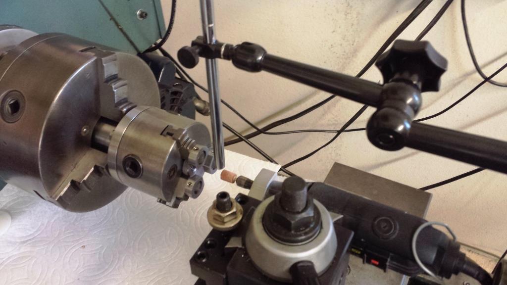

    The Toolmaker mini jaws were re-ground after assembling the 80mm chuck with the mandrel and held in the 6” chuck. Before stating the jaw grinding, a small steel ring was used to pre-load the original (inner) chuck jaws and can be seen in the photos. A Dremel tool with 0.375” dia. grinding stone was dressed in-place on the 12” swing lathe and used to grind the mini jaws true.
    A diamond dresser was held firmly with a Noga adjustable arm attached to the locked tailstock, and using the lathe carriage for movement, the Dremel tool and grinding stone were moved under the stationary dressing diamond. This trued-up the entire length of the grinding stone. Before grinding, the smaller chuck and mandrel were assembled and disassembled several times looking for the most accurate hole combination and location in the larger chuck. Witness marks indicate the most accurate mandrel position with the 80 mm chuck and the rear spacer step on the mandrel was marked with a number “1” for locating with the No. 1 chuck jaw of the larger chuck.
    Chuck Mandrel for 80 mm Chuck-grinding-toolmaker-mini-jaws-80mm-chuck-larger-chuck-mandrel.jpg
    Chuck Mandrel for 80 mm Chuck-noga-adjustable-arm-holds-diamond-dresser-dremel-grinding-stone-setup.jpg

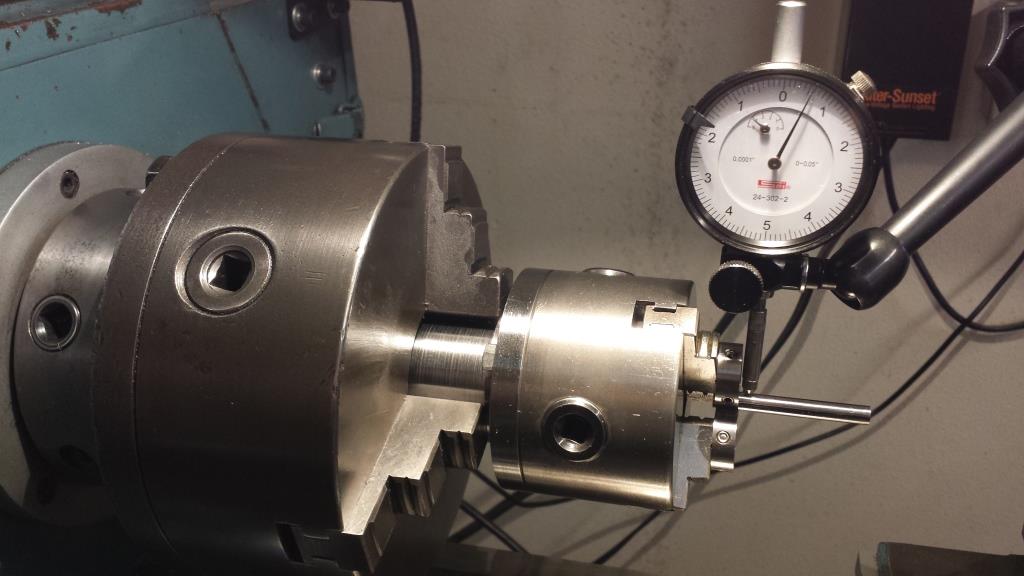

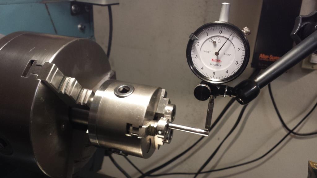

    Using a 0.250” gage pin, the measured repeatable TIR of the smaller chuck while held in the larger chuck is 0.0006” at the front of the toolmaker mini jaws and 0.0008” at a distance of 1.5” from the mini jaws. This TIR exceeded my expectations considering the larger chuck has the same TIR depending upon the diameter being held and while always tightened with the chuck key in the master pinon. Even more remarkable is the repeatable 0.0004” TIR measured with a 0.125” gage pin.
    Chuck Mandrel for 80 mm Chuck-toolmaker-mini-jaw-chuck-mandrel-tir-0.0006-inch.jpg
    Chuck Mandrel for 80 mm Chuck-toolmaker-mini-jaw-chuck-tir-0.0008-inch-1.5-inch.jpg

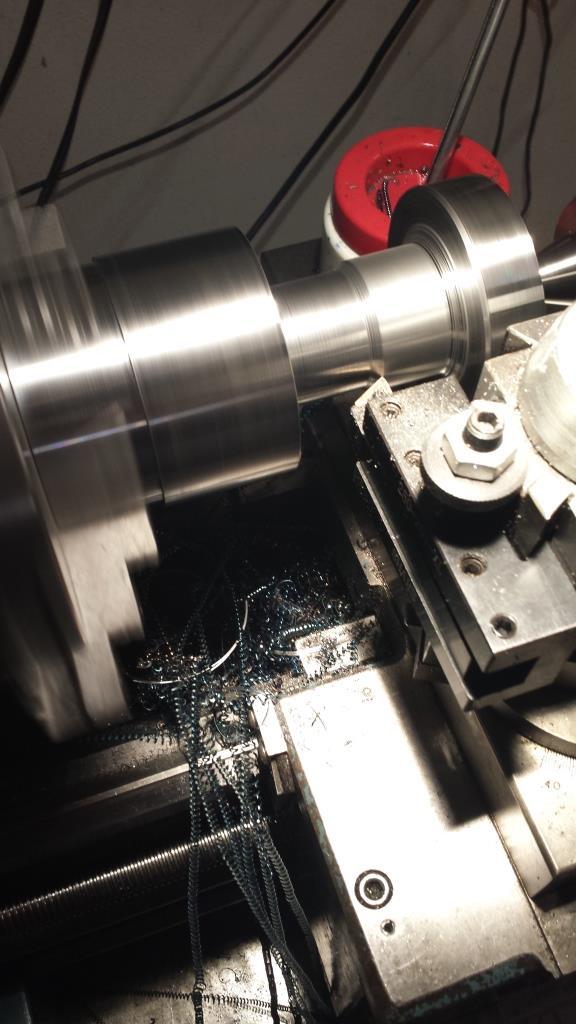

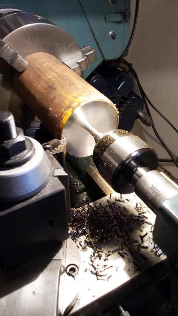

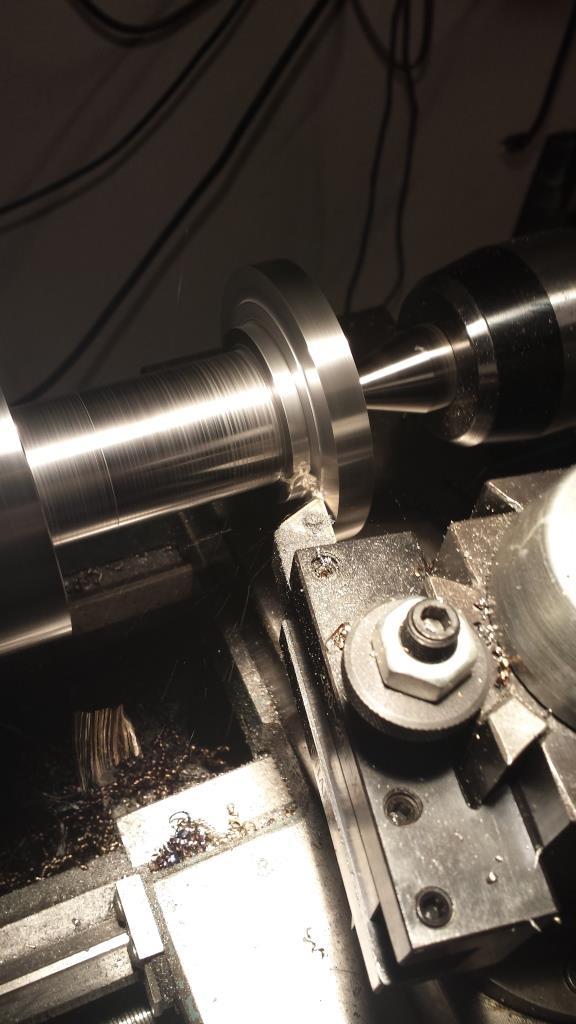

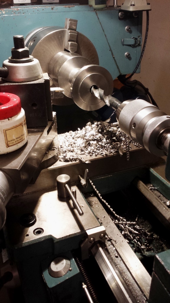

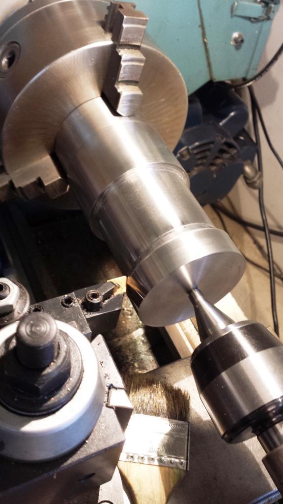

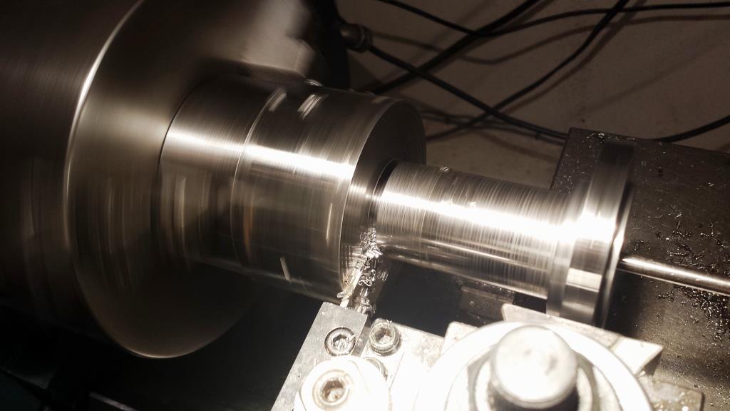

    The following photos show some of the steps in machining of the chuck mandrel from 1045 alloy carbon steel round bar stock. All the machining as completed without re-chucking the mandrel in ordered to achieve the best concentricity. DNMP and TNMP carbide inserts were used for most of the machining and an ISCAR GF insert GFR-3J used for parting-off. The final finishing passes for the 1.5” dia. shank section were completed using an A R Warner T15 HSS TCMW-322 insert but in this case, I think I should have continued using the DNMP Kennametal KT315 grade insert (a multilayer PVDTiN/TiCN/TiNcoated cermet turning grade) which produces a mirror-like finish seen on the larger diameter sections and my most favorite insert for finishing work. I plan to make another chuck mandrel to fit a 5C collet dimension for when I finally finish making a 5C collet chuck for the 12" geared-head lathe.
    Chuck Mandrel for 80 mm Chuck-preparing-3.25-inch-dia.-1025-crs-maching-chuck-mandrel-.jpg Chuck Mandrel for 80 mm Chuck-turning-down-1.5-inch-diameter-shank-using-dnmp-insert-.jpg
    Chuck Mandrel for 80 mm Chuck-turning-down-1.5-inch-diameter-shank-using-tnmg-insert-.jpg Chuck Mandrel for 80 mm Chuck-machining-back-step-chuck-mounting-bolts-nuts-.jpg
    Chuck Mandrel for 80 mm Chuck-drilling-0.625-inch-thru-hole-chuck-mandrel-.jpg Chuck Mandrel for 80 mm Chuck-chuck-mandrel-final-parting-off-iscar-gfr-3j-insert-power-cross-feed.jpg

    Thank you PJs. The TIR surprise me too and that is why I kept all the machining to the tightest tolerances possible on the lathe. The TIR measurement on the 0.1250" gage pin really surprise me and that is the diameter where this chuck will be most useful for me (I just used the chuck to modify several 4-40 socket button head screws). All the errors are accumulative and that is why I tried so many different combinations until I found one that also mitigated the errors. The cool thing is the TIR is repeatable after dissembling and reassembling the chuck and mandrel to the same combination and located with the "1" center on the No. 1 chuck jaw on the 6" chuck. Now I can concentrate on my machining knowing what to expect from the tolerance limits of the chuck.
    The Dremel is not the best tool for this type of grinding. I have planned to do the tape fix shown on HMT with my Dremel but have not gotten around to it. When grinding with the Dremel, I usually dial in 0.0005" (slight tap of the handle to get one half of the distance between the dial indicator lines) per grinding pass and do each pass in and out twice before doing the next 0.0005". I have the lathe chuck rotating at 140 RPM (the direction doesn't seem to matter but less vibration at lower speeds) and the Dremel at full throttle and use a 0.0014" lathe carriage feed rate (quick change gear setting E and 5). I use a blue Sharpie pen to blue the jaws when starting out to make sure everything is ground clean and a bright finish.
Name:	Toolmaker mini jaw chuck and mandrel TIR is 0.0006 inch.jpg
Name:	Toolmaker mini jaw chuck TIR 0.0008 inch at 1.5 inch.jpg
Name:	Preparing 3.25 inch dia. 1025 CRS for maching chuck mandrel .jpg
ID:	13359 Click image for larger version.
Name:	Turning down to 1.5 inch diameter shank using a DNMP insert .jpg
Name:	Turning down to 1.5 inch diameter shank using a TNMG insert .jpg
ID:	13361 Click image for larger version.
Name:	Machining back step for chuck mounting bolts and nuts .jpg
Name:	Drilling 0.625 inch thru hole for chuck mandrel .jpg
ID:	13363 Click image for larger version.
Name:	Chuck mandrel final parting-off with ISCAR  GFR-3J insert and power cross feed.jpg
