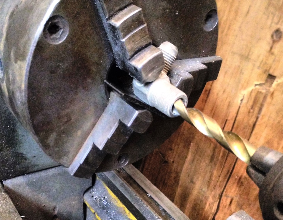

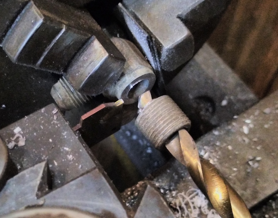

to do this I needed to chuck a -6 to 3/8 NPT 90° elbow in my small lathe but it only has a 3 jaw chuck.
Here is how I did it
I placed the end to be cut off on a drill bit in the chuck on the tail stock guided it tot eh 3 jaw then shimmed 1 jaw to get it centered
Attachment 40979
Attachment 40980
