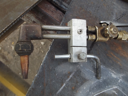

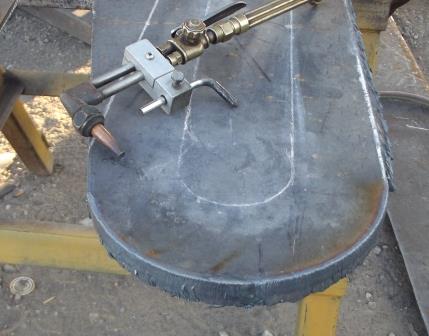

    I cant find where I have introduced this little tool in any of my threads on its own so I will post it now
    I have mentioned it in another thread but only as a supporting tool for the tool I was making at the time
    I've made several of these over the years this is the first one that I've made to fit the smaller torch since it is made from aluminum I leave it on my torch most of the time
