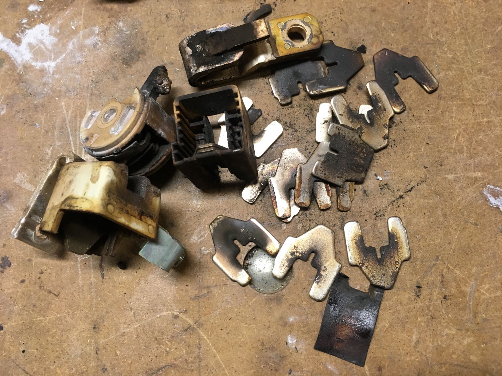

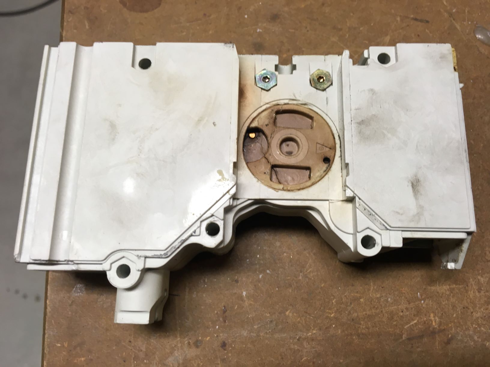

    This is another <200 Amps 400 VAC 3-phase circuit breaker (exploded view) after final use:
    Circuit breaker cutaway - photo-breaker.jpg Circuit breaker cutaway - photo-breaker-1.jpg

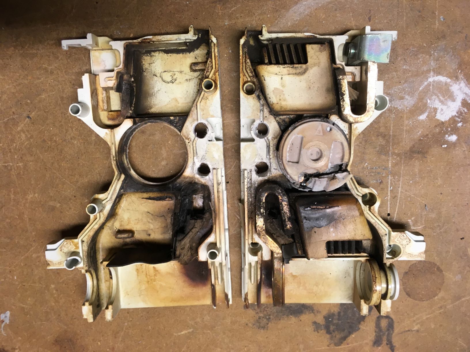

    Pretty decent exterior, right? Opening up by drilling out the rivets shows the mayhem...

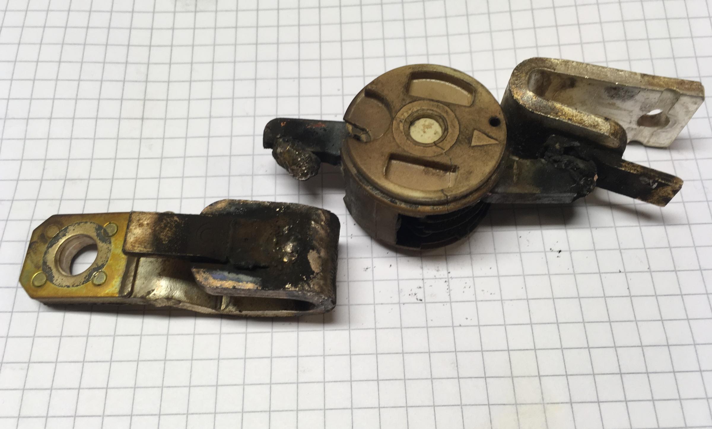

    Circuit breaker cutaway - photo-breaker-2.jpg Circuit breaker cutaway - photo-breaker-3.jpg
    Note the impressive copper blob on the contact point, the heat witness marks & oxidation of the flash arrestors.
    "-Just another day at the office."
