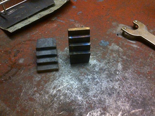

below are couple of clamp blocks i made out of 5x30mm flat.
i cut each piece 10mm shorter to give step and allow different hts then welded them together.
they can be used either way up
