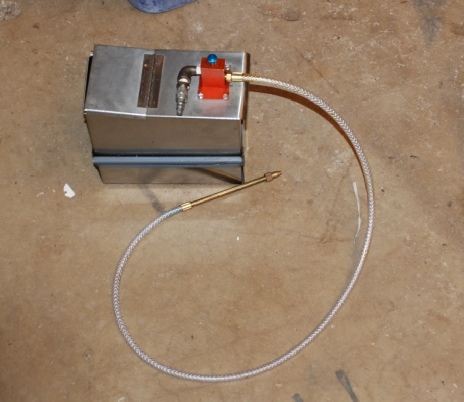

OK I only scanned through his 2 hours of videos in about 5 minutes or less so I may have missed something important, but I doubt it
His system is entirely too complex.
Bridgeport mills have had a simple coolant mister for decades which is little more than a reservoir a nipple to connect an air supply mounted in a block of aluminum with a needle valve to control the siphon of the coolant a hose and an adjustable nozzle They are in expensive and reliable
Attachment 43425
I used the same watching technique and reached the same conclusion.
I had a Koolmist system which seems as if it was like the Bridgeport system that you mention but I was never really happy with it. I was forever having to adjust it. A year or so back I made a new block with rearranged passages and I replaced the coolant tank with a filter housing similar to the one in the video, which allowed for the coolant to be pressure balanced to the air flow. The system works much better now. It is no more complicated than the original, just different. The block was replaced with another and the coolant tank was replaced with the filter housing. None of the complication of the video.
When I had my Bridgeport, I usually ran Chevron soluble oil B at a 10 to 15 to 1 ratio coolant, and I always seemed to neglect cleaning out my tank, frequently the mix might stay in the tank for weeks maybe longer if I wasn't doing any milling, sometimes it would be left in the tank so long I would even have to add a tablespoon of bleach to get rid of the Monday morning stink. I don't remember having to fiddle with adjusting it all that much, as I would normally just open the valve and nozzle pretty wide

The Koolmist did as its name suggests. It created a mist which was messy and not good for breathing. There is another system whose name I forget but it is something like "No-mist" or "Zero-mist" which was the inspiration for my modifications. I did not copy the no-mist system but it gave me the idea. The coolant does not mist, it tends to stay as liquid drops. It works at least as well as the mist but uses less coolant because you are not spraying a sizeable portion around the room. I was so pleased with the modifications to the Koolmist that I made one from scratch for the lathe but I used a smaller filter housing. That was adequate because it is in an easy to fill location whereas the mill one is not so easy.
I just did a search the other system that I mentioned is called "FogBuster".
