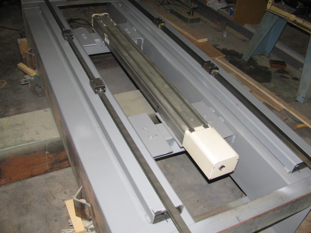

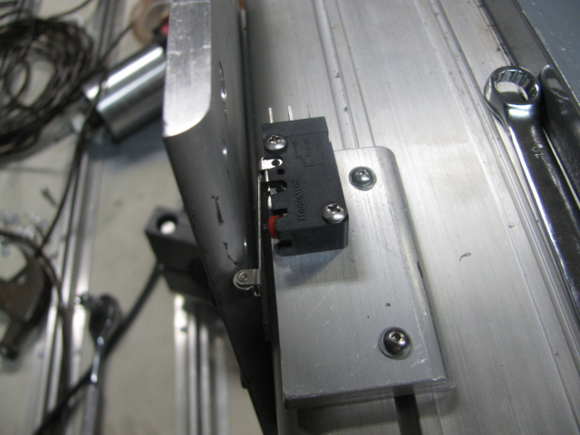

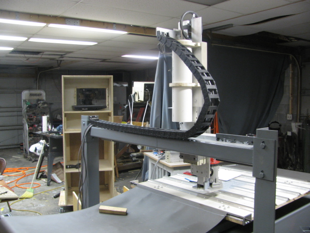

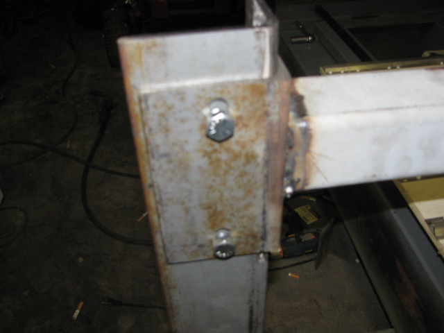

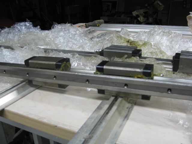

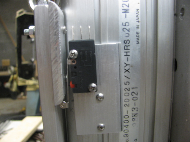

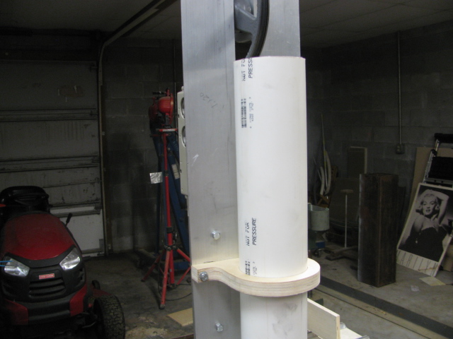

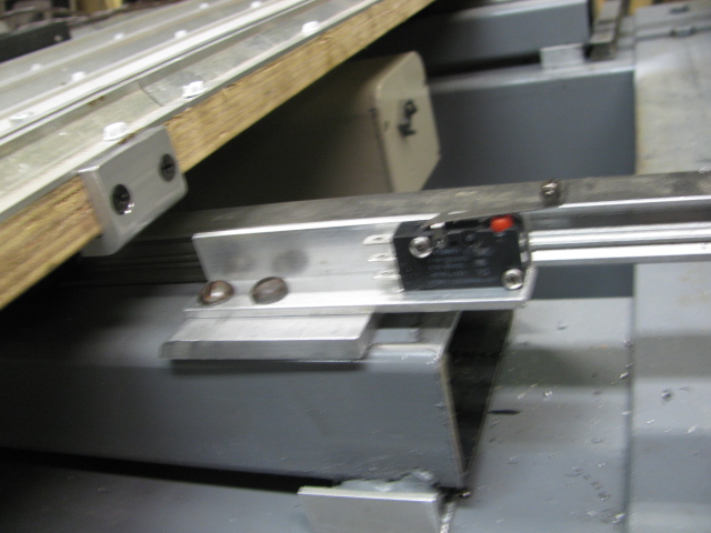

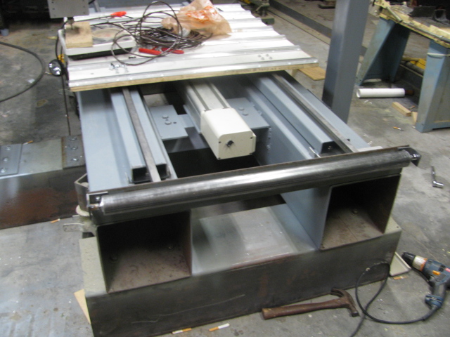

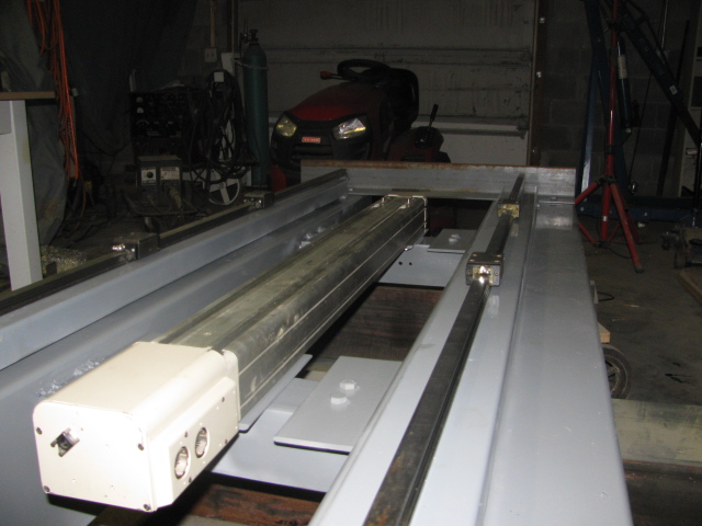

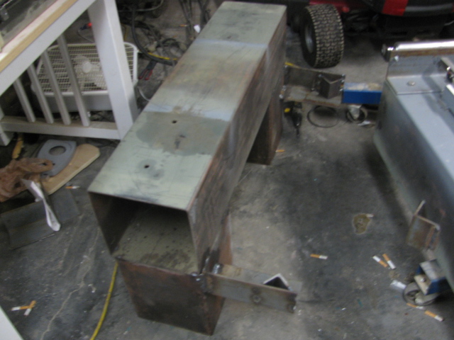

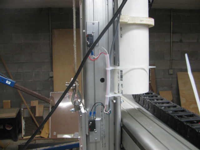

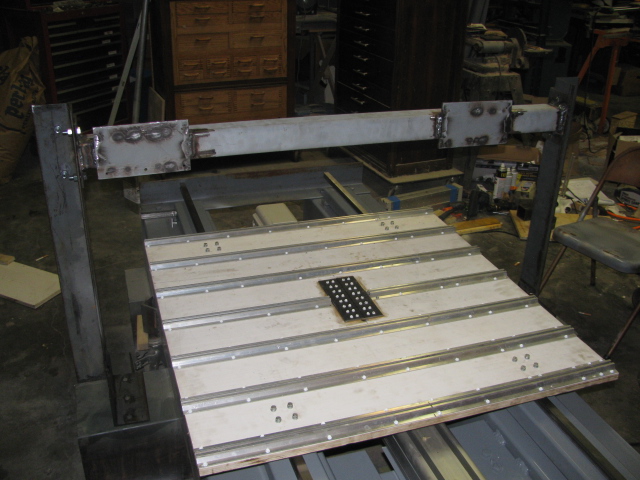

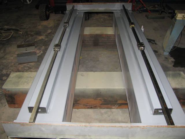

CNC router build from Adept robotic cartesian slides.

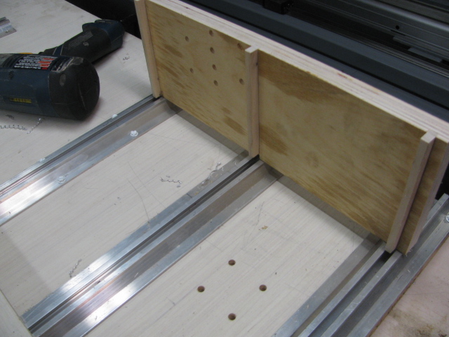

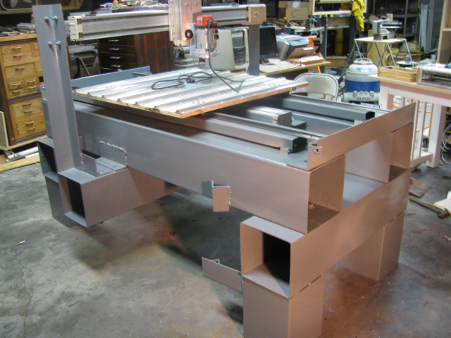

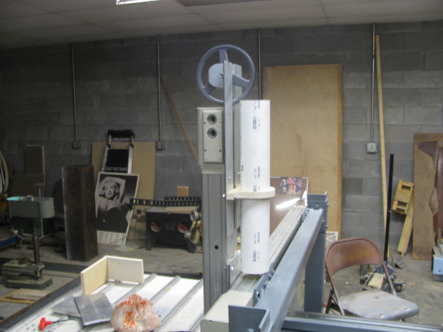

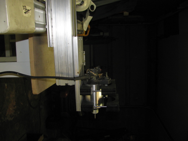

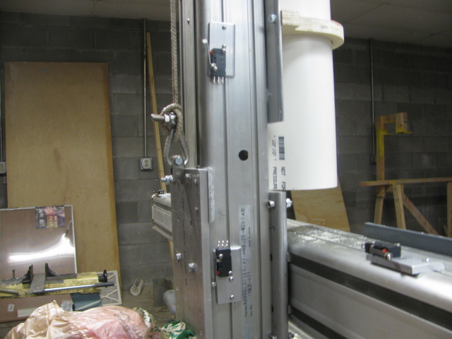

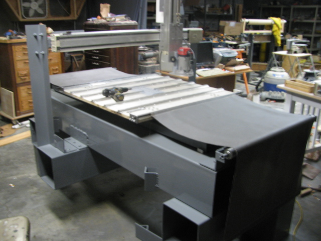

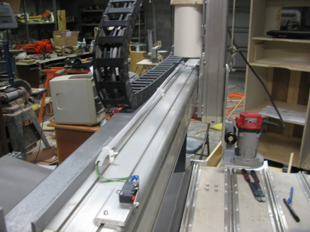

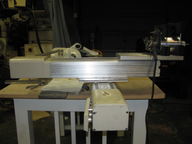

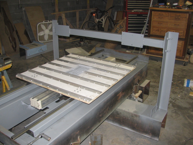

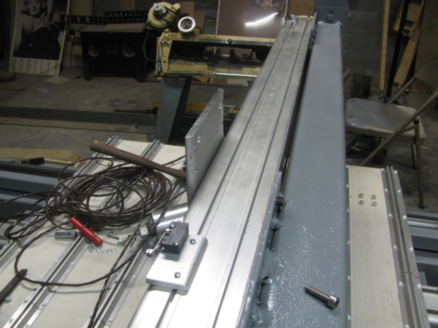

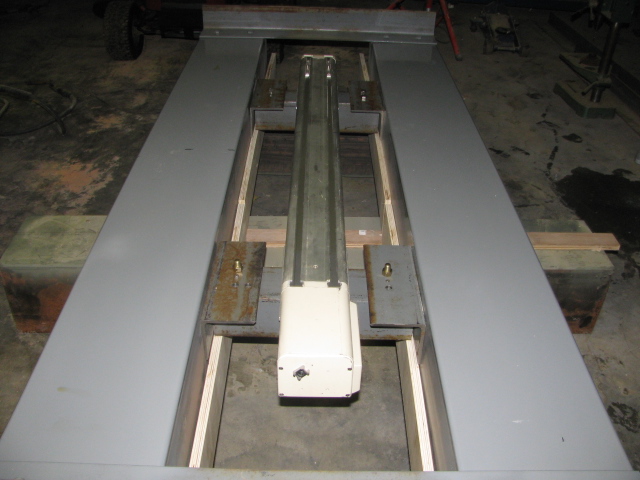

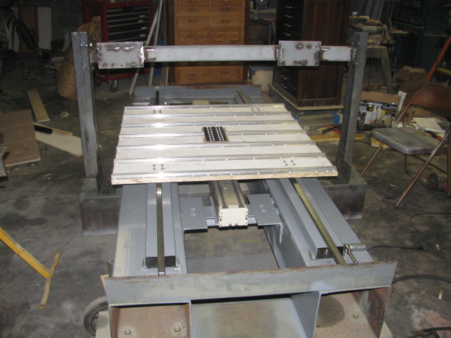

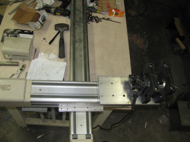

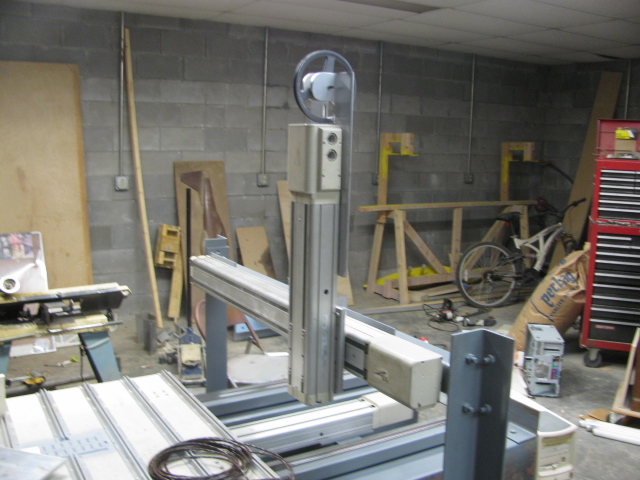

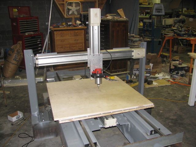

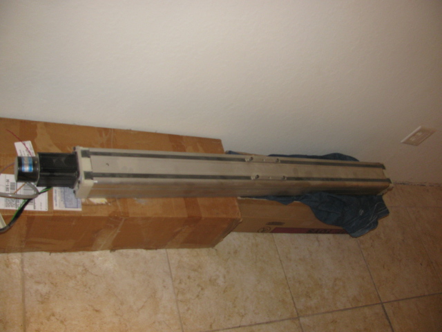

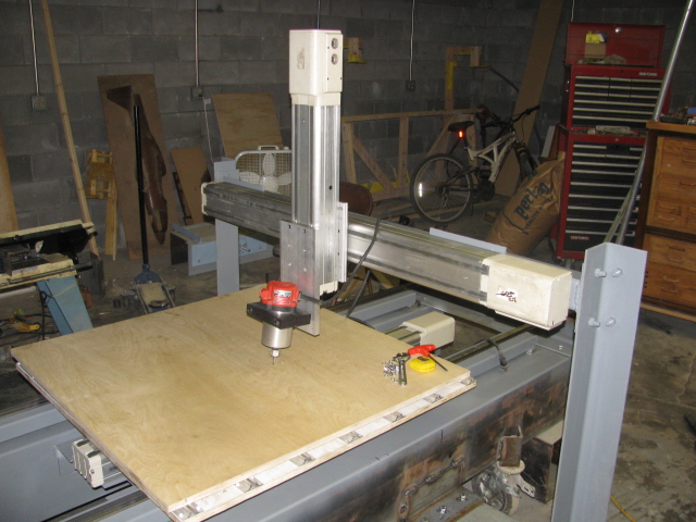

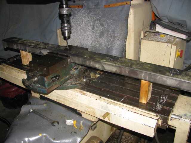

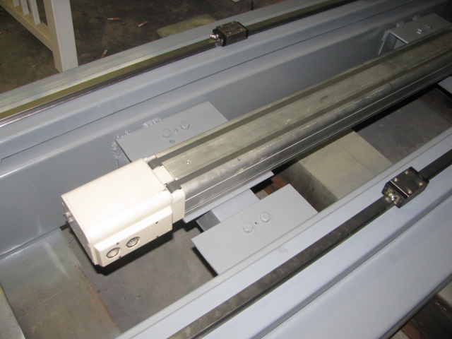

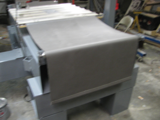

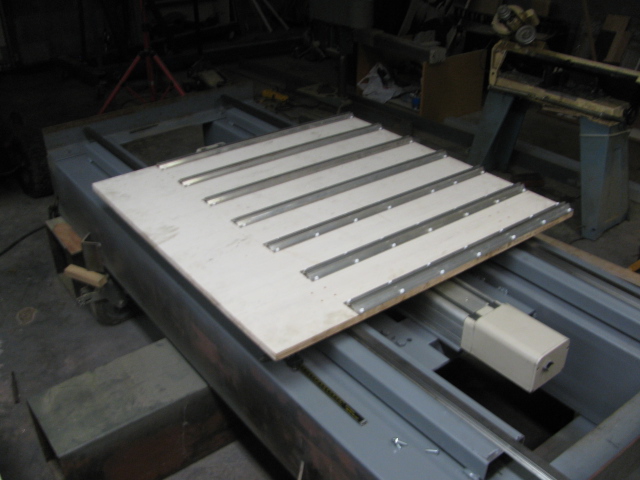

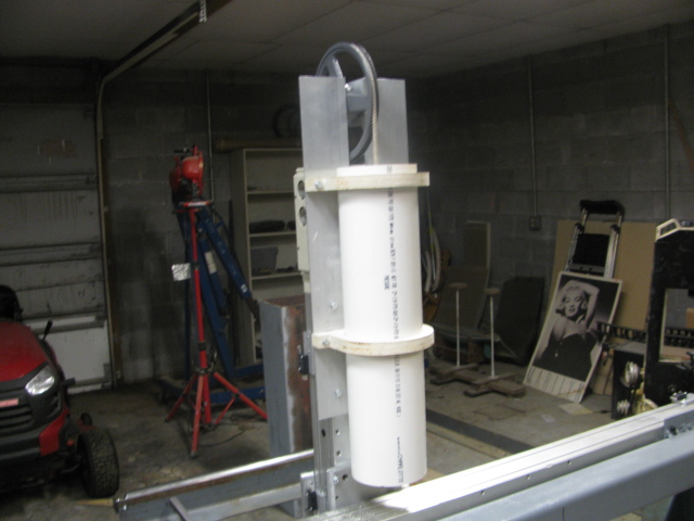

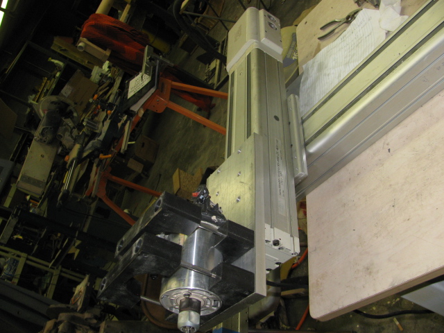

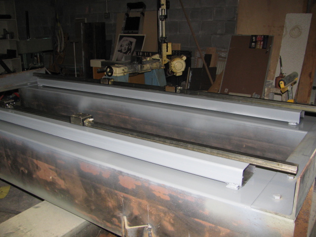

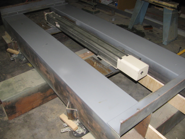

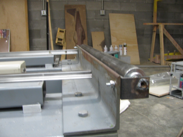

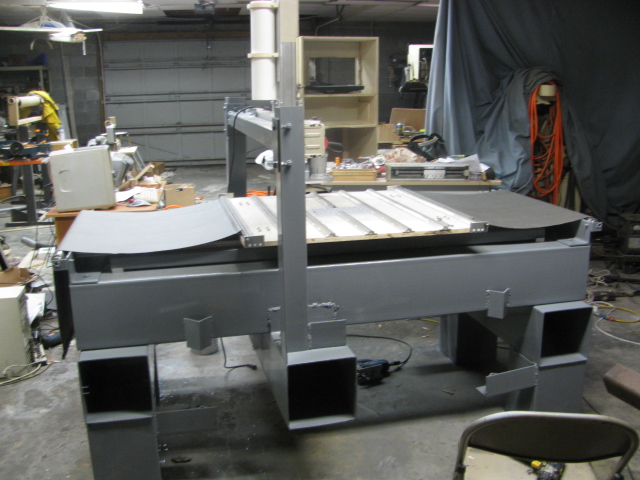

Attachment 4412About 5 years back, I started a cnc router build based on Adept robotic arms. I chose this route because the slides, ballscrews and servo motor are all installed in the assembly. I will use three of these slides for x,y,and z. Most of the components are already designed and ready to be installed and or welded. I bought 10 by 10 steel tubing as the base because I got a good price on it. Also the Adept slides are designed with quite a high ballscrew pitch, 20mm., so with that available speed of movement, I elected to build a rigid base. This build will take a while, even though I will be working on it everyday until finished, so I will add some meaningful comments and pictures as the build goes forward. Here are some pictures of the X axis slides and installation. This will be a fixed gantry type router and the table will move 19 inches plus and minus for a movement of 38 inches, both on the X and Y. I am primarily designing this router because I needed an X movement of at least 32 inches to build molds for my 1:32 model train molds. My mill would only traverse 28 inches. I added a pic. of one of the Adept slides. Bob.Attachment 4408Attachment 4409Attachment 4410Attachment 4411

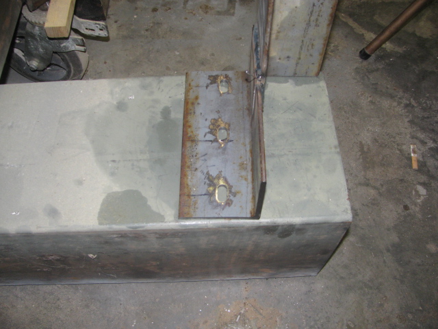

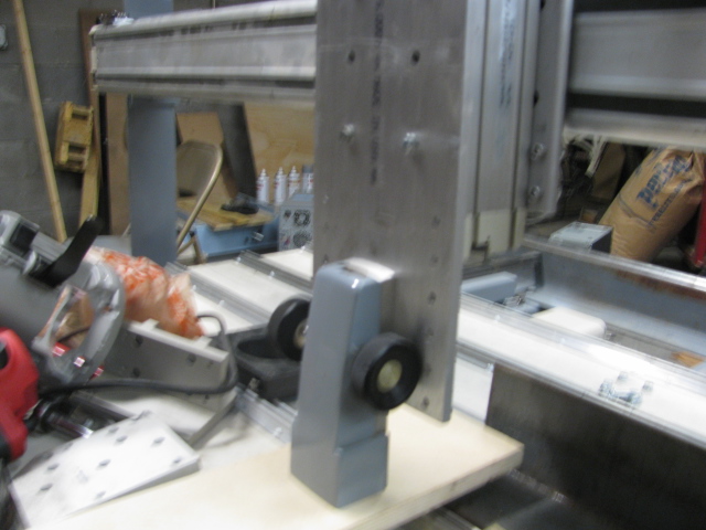

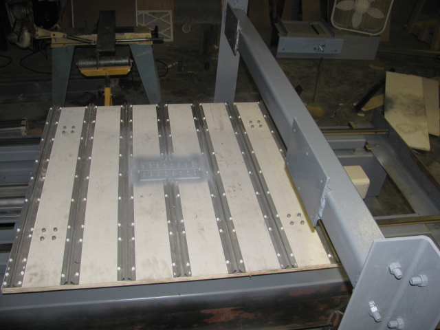

CNC router table to servo attachment.

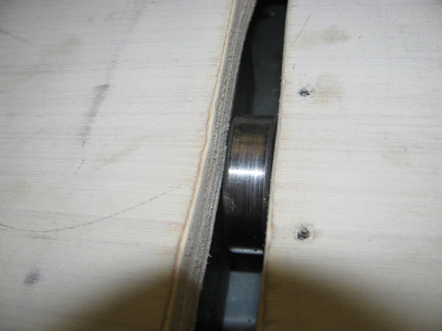

Attachment 4624Here is a video of the explanation of how I plan to attach the table to the servo. I wanted 0 backlash between the table and the servo, so I mounted a bearing on the servo and on the table is a slotted piece of angle, machined to fit tightly around the bearing. The other advantage of doing it this way is, If I want to remove the table for any reason, the table just lifts right off after removing the slide bolts. Bob.https://www.youtube.com/watch?v=rTdRK_7s0Sg

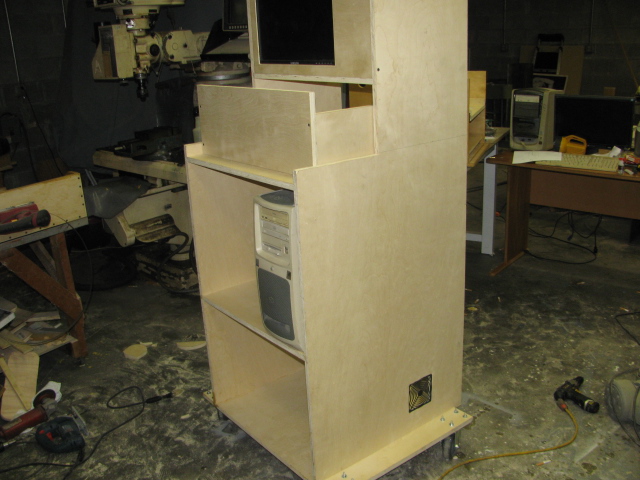

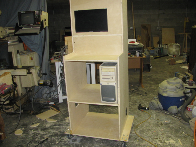

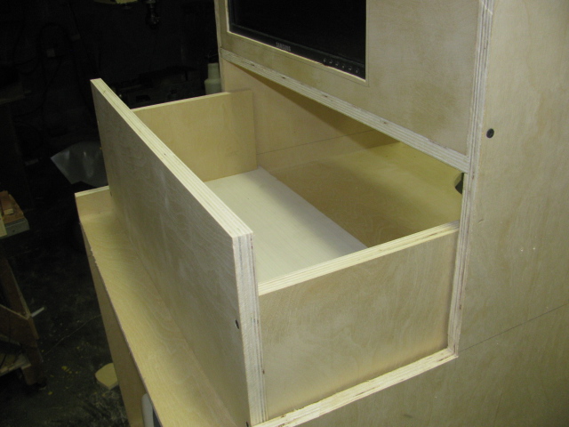

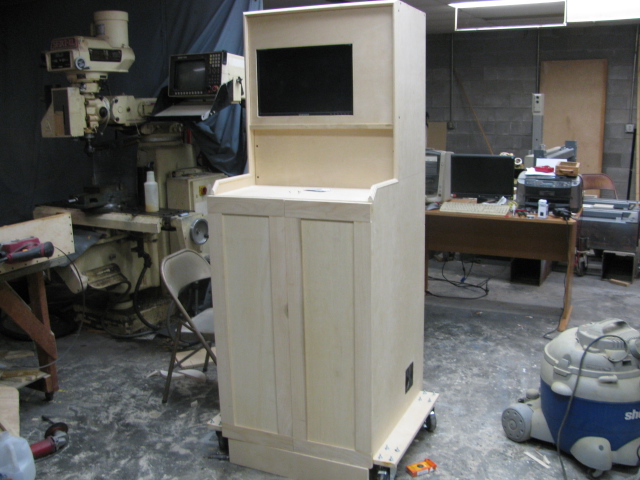

5 Attachment(s)

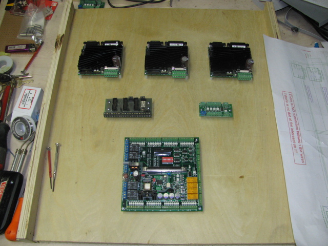

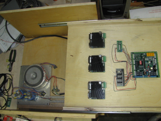

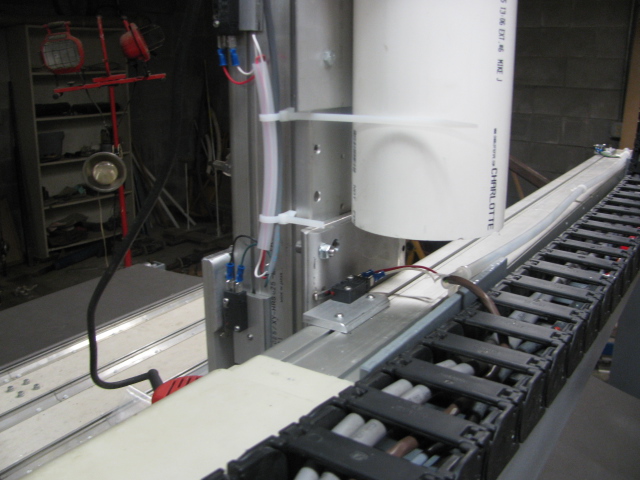

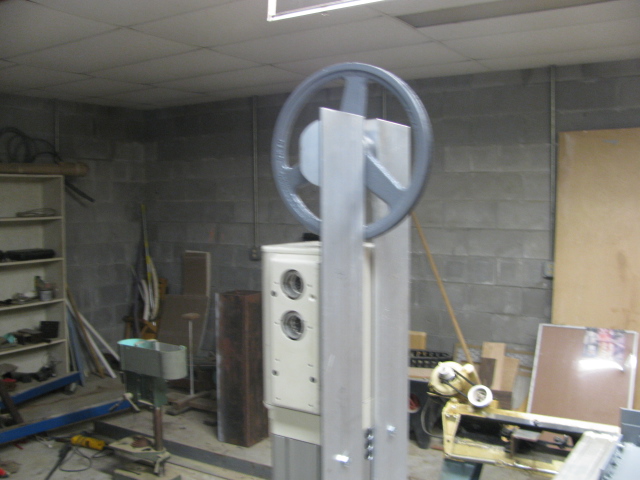

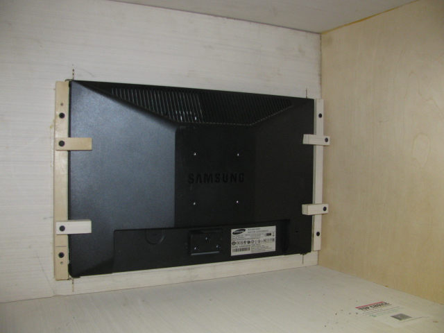

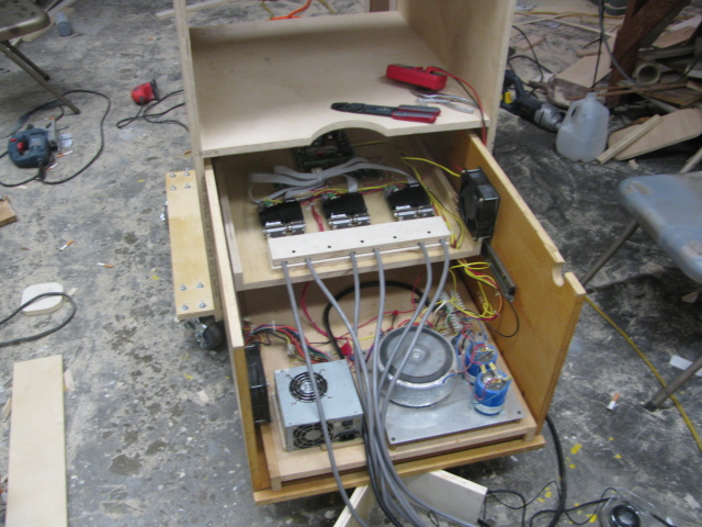

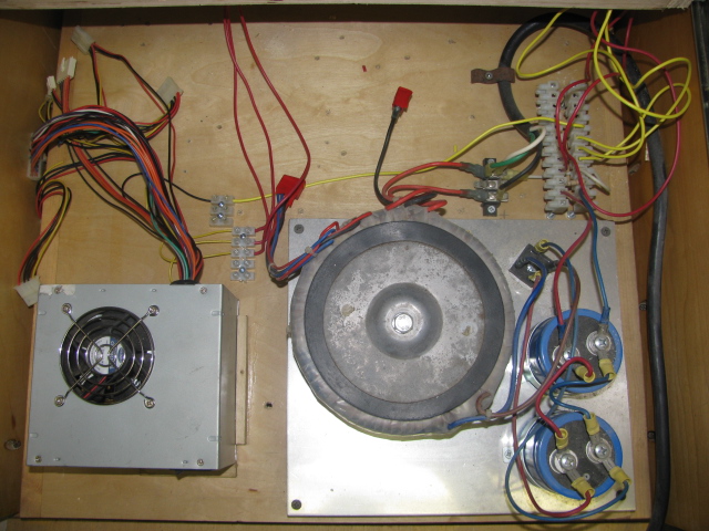

Electronics for the cnc router using the Adept robotics slides.

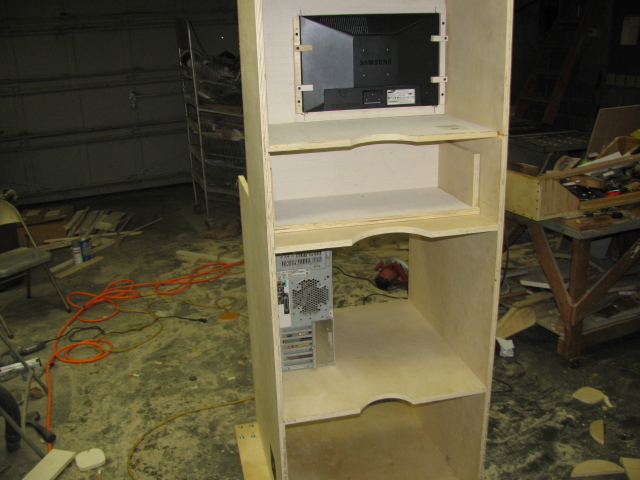

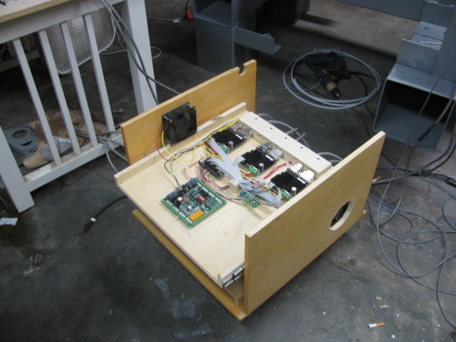

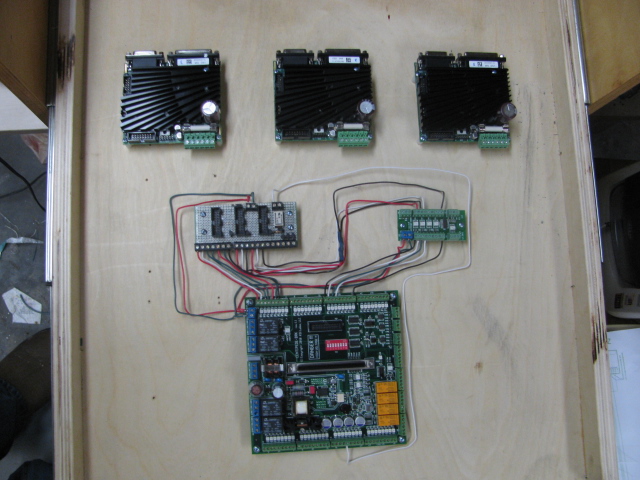

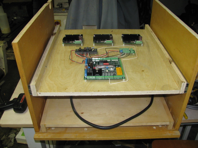

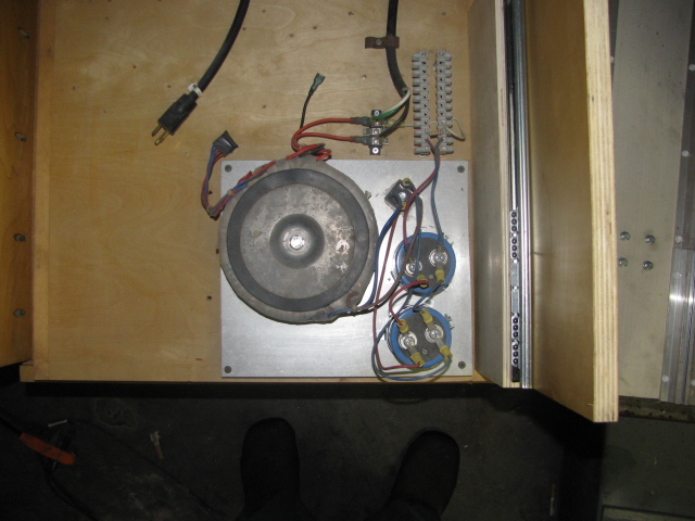

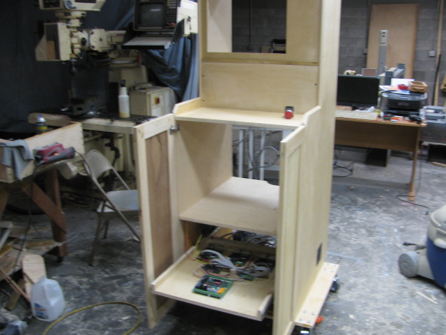

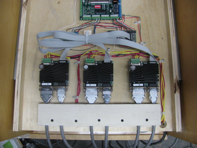

Today, I started the wiring of the router. I chose to separate the power supply from the cards and drives so as to have more room. I used a drawer slide, no it is not powered. The low voltage circuits are pretty much done, and tomorrow I will wire the high voltage to the motors and drives from the power supply. Here are some pictures.Attachment 4946Attachment 4947Attachment 4948Attachment 4949Attachment 4950
