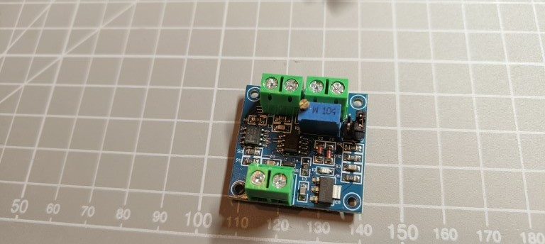

On the other hand most of the laser heads use a single PWM signal to set the power of the diode.
0% duty cycle meaning diode off, and 100% duty cycle meaning diode on, with all intermediate settings possible.
So, in my case, I was about to make myself this 0<10V DC to PWM TTL converter, but searching what was already available, I found a small conversion board that did exactly the trick:
Attachment 47088
The name is "Fasizi 2 modules PWM de 0 V à 5 V/0 V à 10 V de 0 à 100 % de tension de signal PWM" on French Amaz...
It also requires an external 12V power supply, for that, at least for the moment, I decided to use my usual bench power supply .

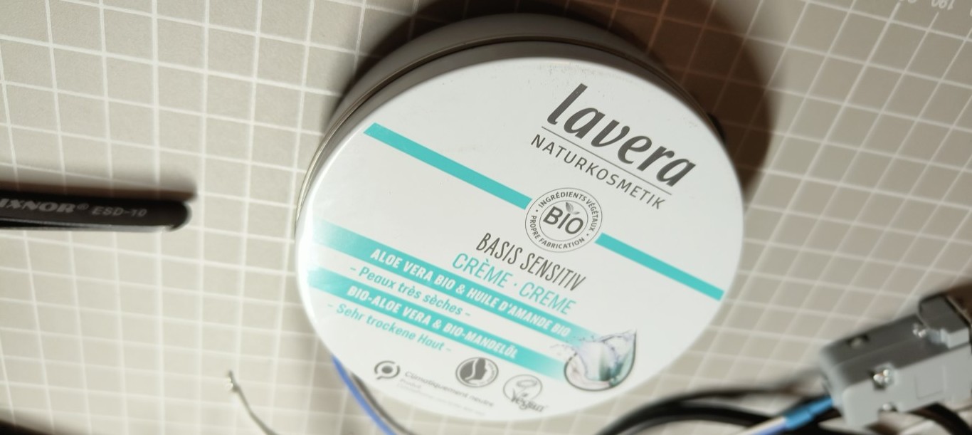

I looked around and decided to go with this small round metal box (cosmetic cream container).
Attachment 47089
You'll see later why this turned out to be a good choice.

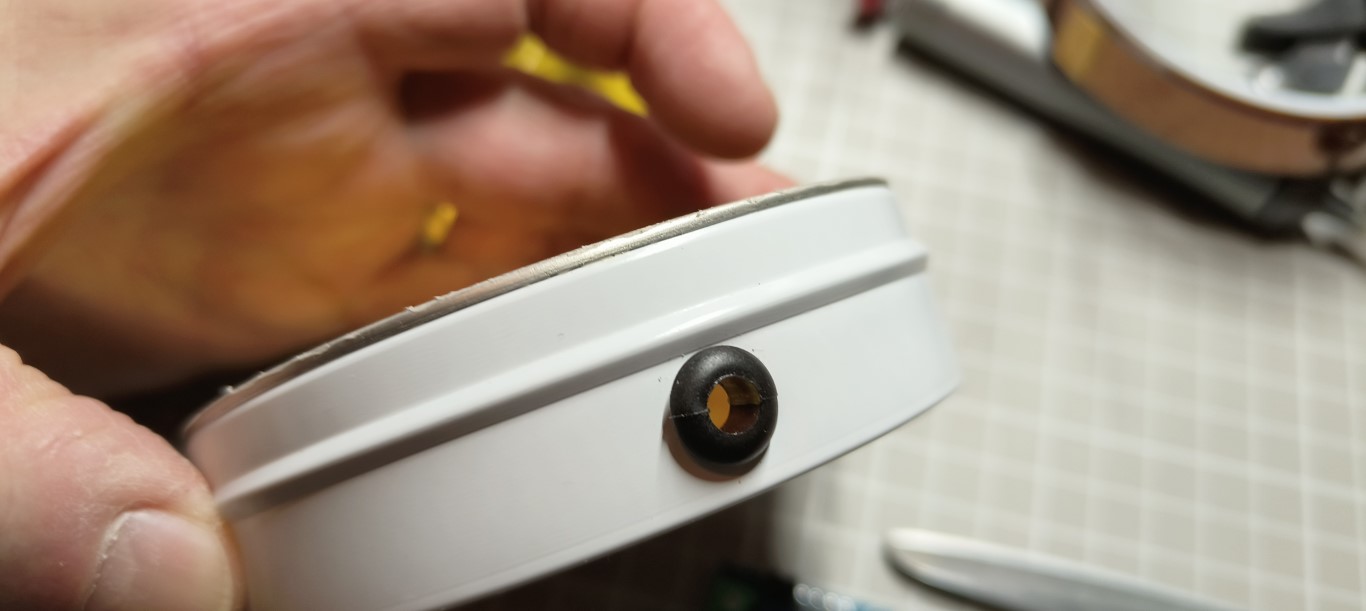

First I drilled a couple of holes, (using a stepped drill) and inserted some plastic rings to protect the wires that will go through :
Attachment 47090
