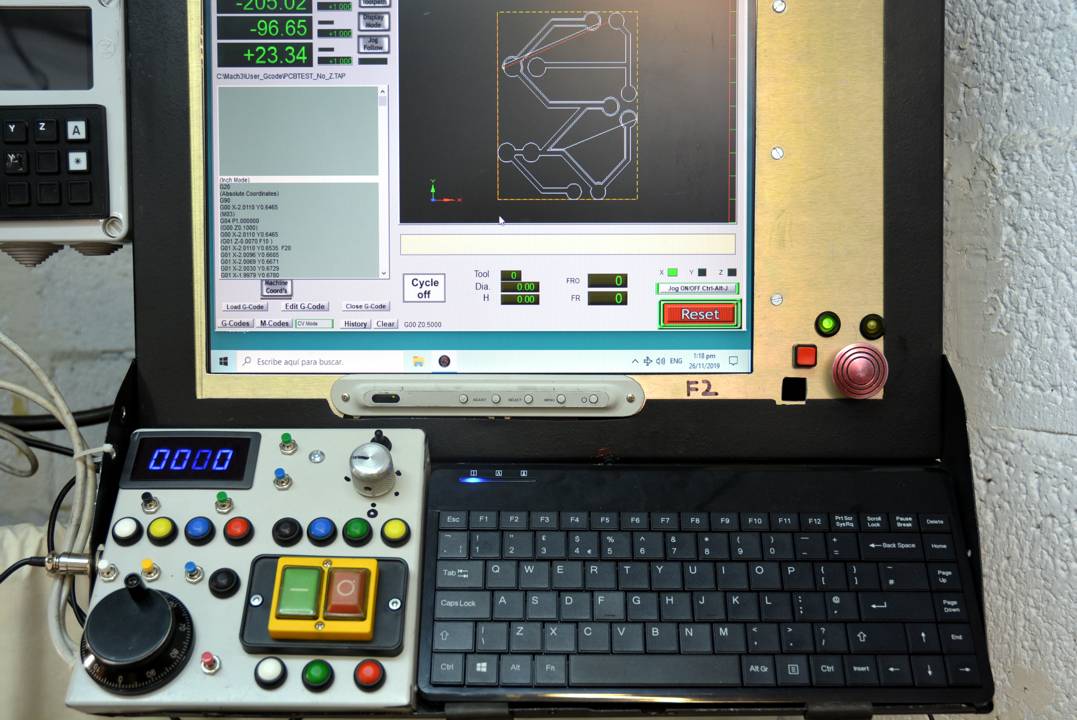

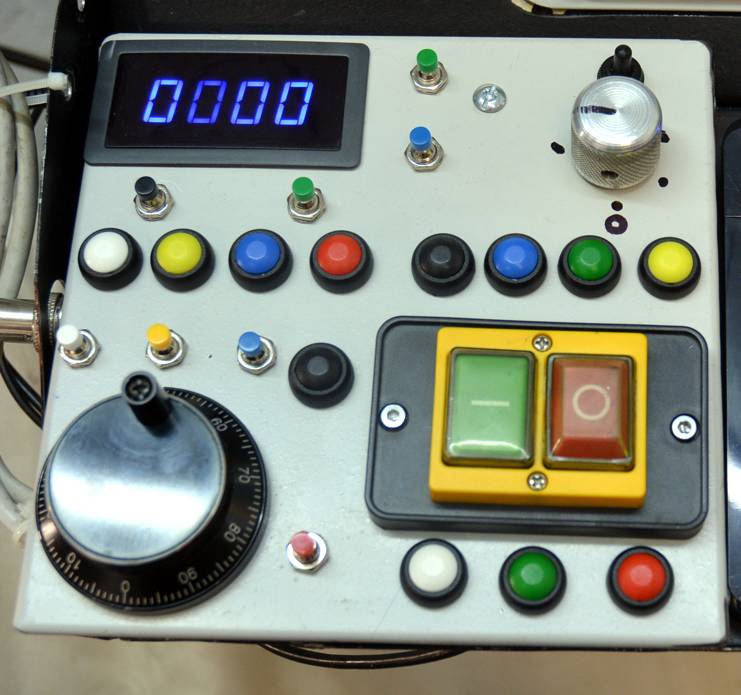

    I do similar but my "pendant" is fixed.
    Laser engraver/cutter from old 3D printer.-control01.jpg Laser engraver/cutter from old 3D printer.-control02.jpg Click for full size.

    In 13 years of use I have never had any of those problems. I use a NUK with Win64 and an SSD, but in the beginning it was an old computer on XP. I only ungraded when I was thinking about going to Mach4. "hourglass cursor" is fine in English and is exactly how I would phrase it.
