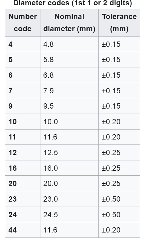

Button/Coin cells/batteries are common in many of the electronic devices we use. I collected some information about them and pass it along here along with a couple of tips that might be useful when working with them.
First, you should read the excellent Wikipedia article on the subject...
https://en.wikipedia.org/wiki/Button_cell

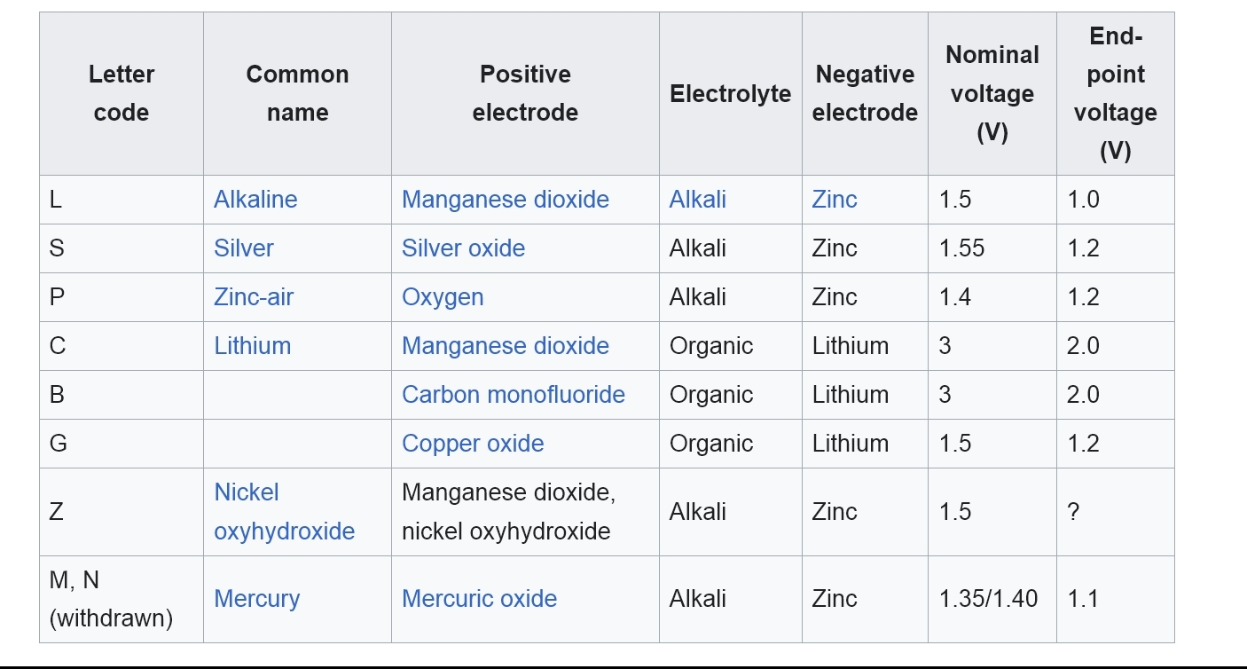

in which you will find this chart...
Attachment 45622
that helps to explain the information contained in the designation printed on the battery.
Another chart from that article...
Attachment 45623
is also very useful for determining size.
For example, from the two charts we can deduce that the common CR2032 has the following properties:
C = lithium with a nominal voltage of 3.0 volts
R = round (cylindrical) form [this is discussed in the article]
20 = 20 mm diameter
32 = 3.2 mm thickness
while an LR44 (another common battery)
L = alkaline with a nominal voltage of 1.5 volts
R = round
44 = 11.6 mm diameter [apparently some inferial luddite snuck in during the chart's creation]
The proper designation should be LR1154.

I've never encountered a specification for testing these batteries under load. I just test them by measuring their unloaded voltage with a VOM. The "End Point Voltage" shown in the first chart is a good breakpoint for deciding between good and bad. For coarser work I just use half their nominal voltage.
