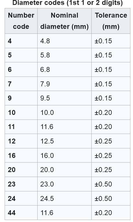

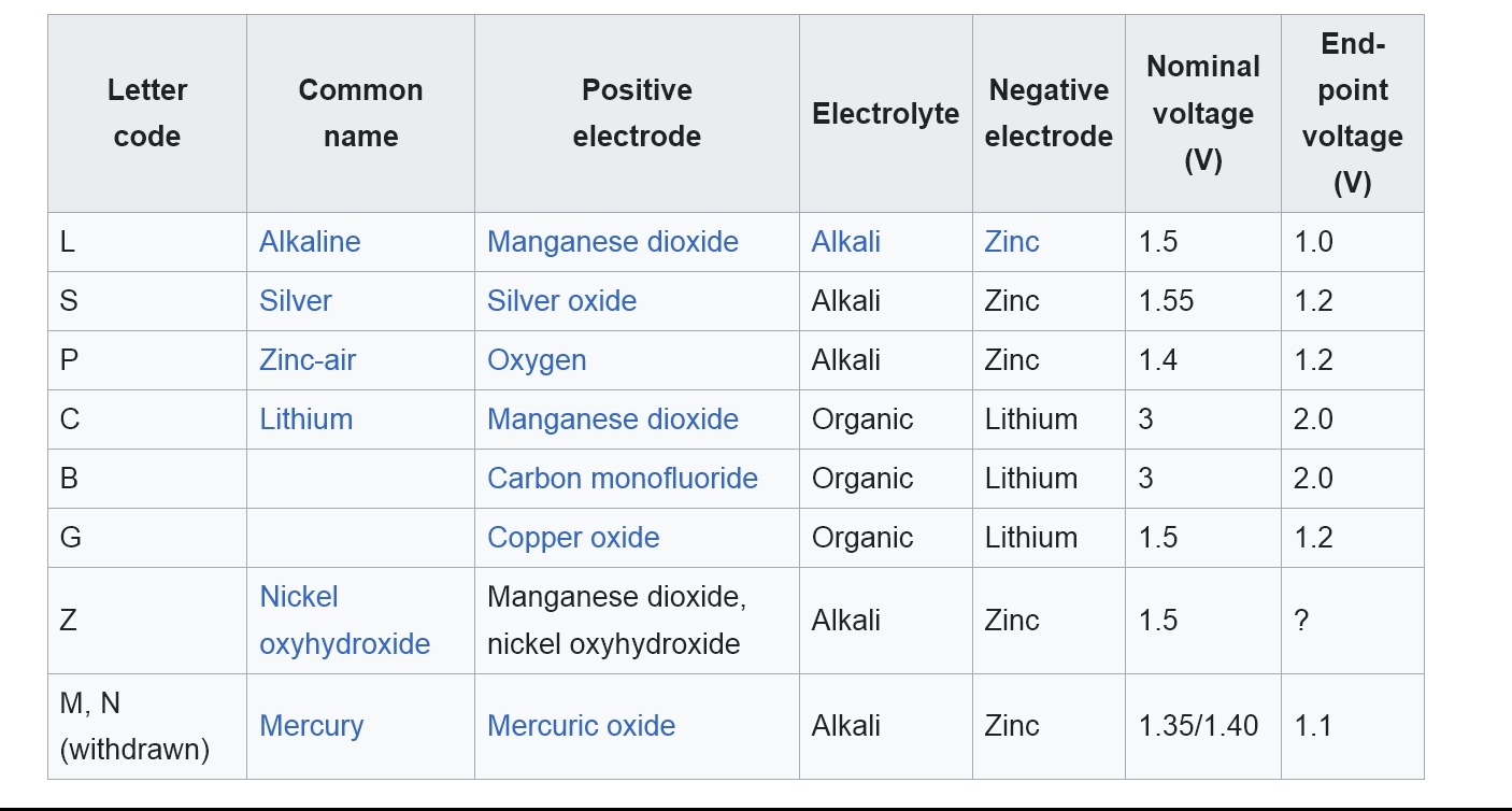

    Button/Coin cells/batteries are common in many of the electronic devices we use. I collected some information about them and pass it along here along with a couple of tips that might be useful when working with them.
    First, you should read the excellent Wikipedia article on the subject...
    https://en.wikipedia.org/wiki/Button_cell
    in which you will find this chart...

    Another chart from that article...
    is also very useful for determining size.
    For example, from the two charts we can deduce that the common CR2032 has the following properties:
    C = lithium with a nominal voltage of 3.0 volts
    R = round (cylindrical) form [this is discussed in the article]
    20 = 20 mm diameter
    32 = 3.2 mm thickness
    while an LR44 (another common battery)
    L = alkaline with a nominal voltage of 1.5 volts
    R = round
    44 = 11.6 mm diameter [apparently some inferial luddite snuck in during the chart's creation]
    The proper designation should be LR1154.

    I've never encountered a specification for testing these batteries under load. I just test them by measuring their unloaded voltage with a VOM. The "End Point Voltage" shown in the first chart is a good breakpoint for deciding between good and bad. For coarser work I just use half their nominal voltage.
